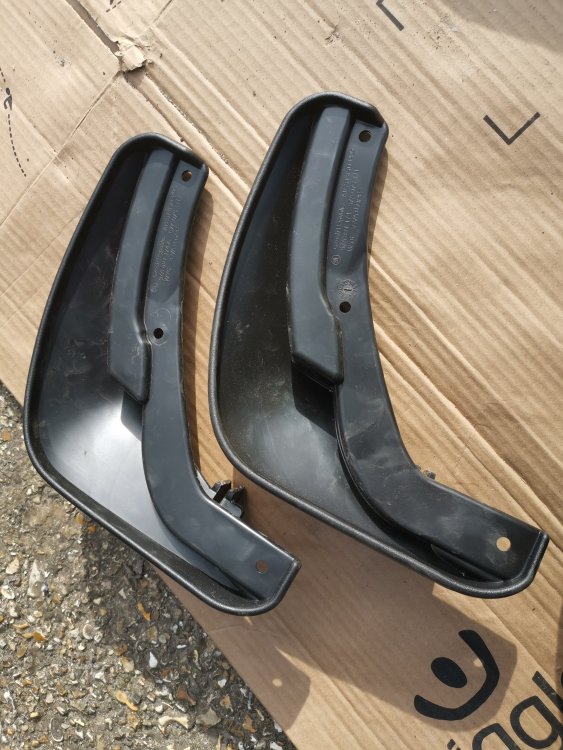

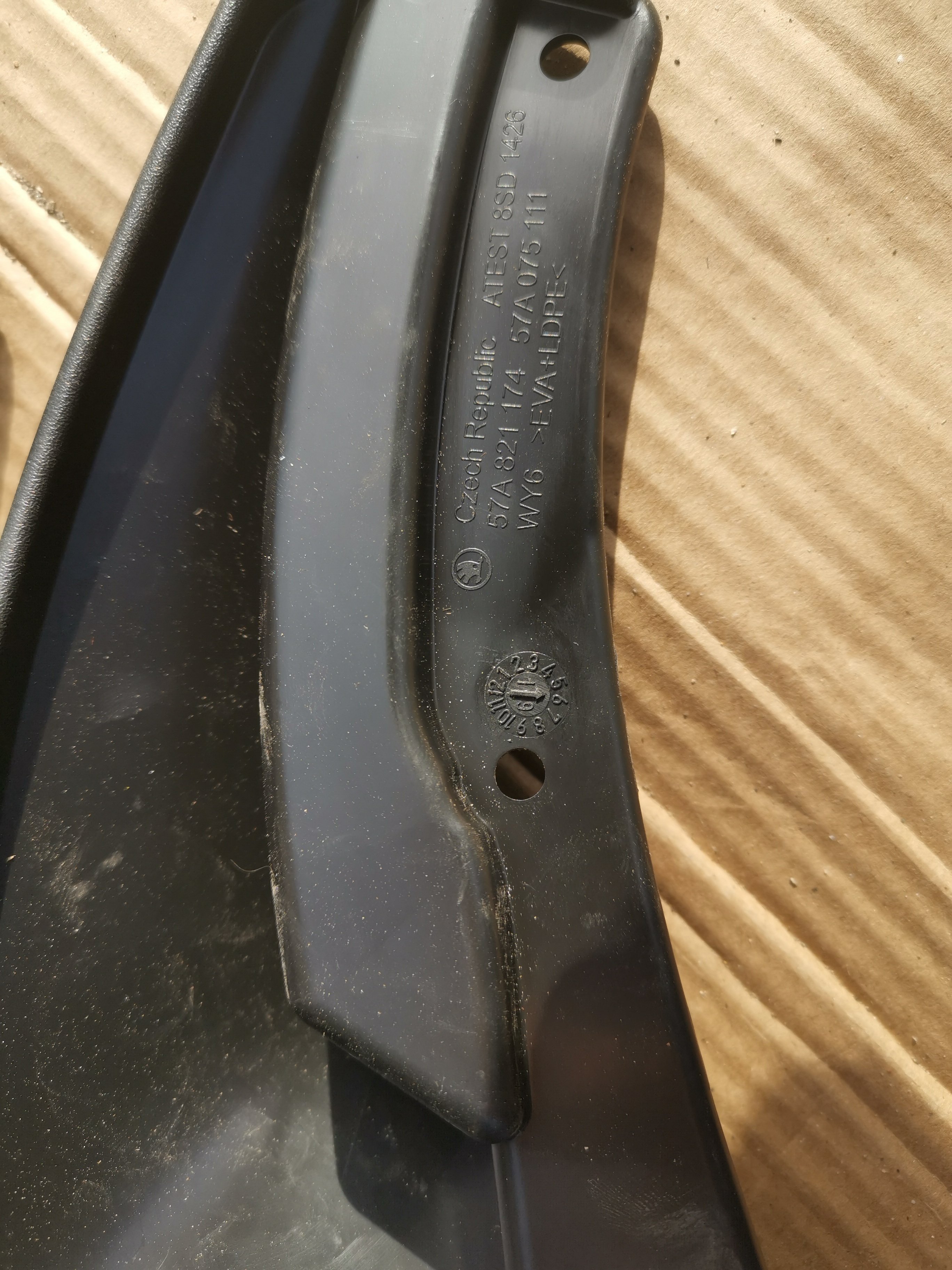

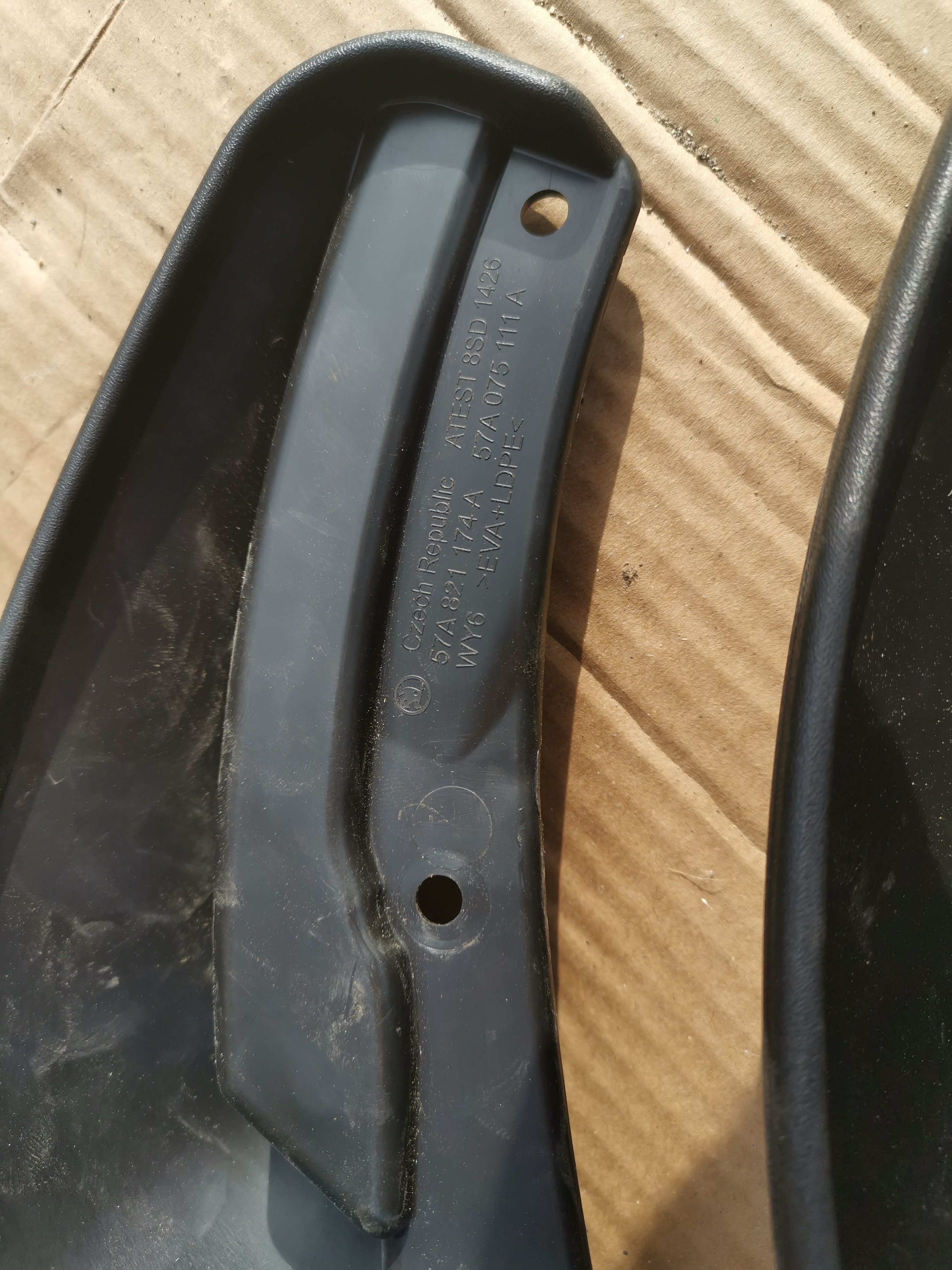

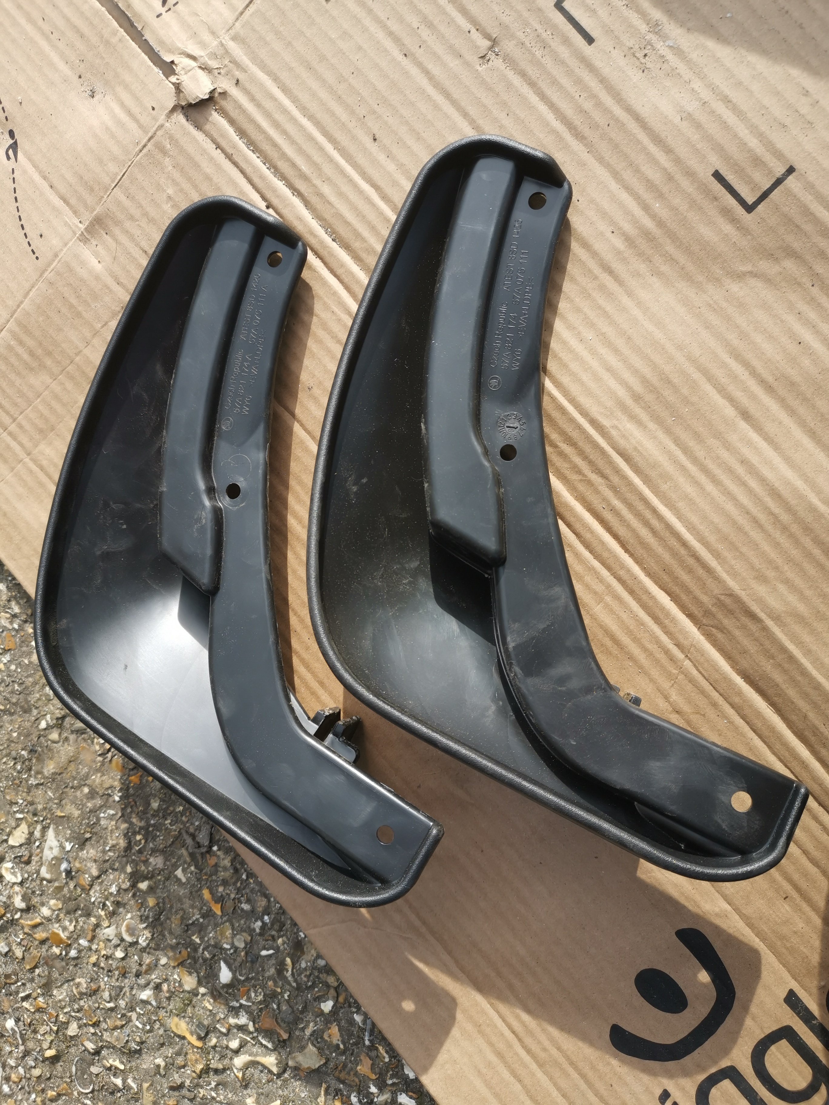

Well, ordered my first set from Plymouth Skoda, genuine parts,  the non A variety therefore should have been correct but they didn't seem to fit correctly. Ordered another set, the A variety. Guess what, have a look at the photos attached and see if you can see the difference between them, then have a look at the part number.
If you look at your first picture the lug that locates under the sill where the lower screw fits is different between the two flaps the difference appears to be due to the relationship of the end cap of the sill cover and wheel arch trim where they meet which is different if there are no wheel arch trims, on my Scout with arch trims the "111A" flaps fit perfectly.

Another fine day today so had a play.  Took the currently fitted ones off and fitted the other ones. Shock horror, they fitted! The difference between the two in photo one could be due to the angle. They lugs are both the same. Anyway, fitted the original ones again and there staying there!!! Well, until the wheelarch extensions arrive and then we'll go through some more shenanigans, probably!!!!!

If I had to put my name on a part, I'd go with the "A" designated number for mudgards for non wheel trim fitted vehicles. On playing with both types, the A part seemed to fit a little better around the block, see the picture below, but that's the only difference.

Took the currently fitted ones off and fitted the other ones. Shock horror, they fitted! The difference between the two in photo one could be due to the angle. The lugs are both the same
Am I reading you right? You're saying the lugs are the same?
Is it just the angle of the photo you took? The lugs look very different between the A and non-A version to me (circled in red)?
Agreed they look different at that point, there has to be a difference somewhere manufacturers do not normally give different part numbers to the same part to fit two different applications.

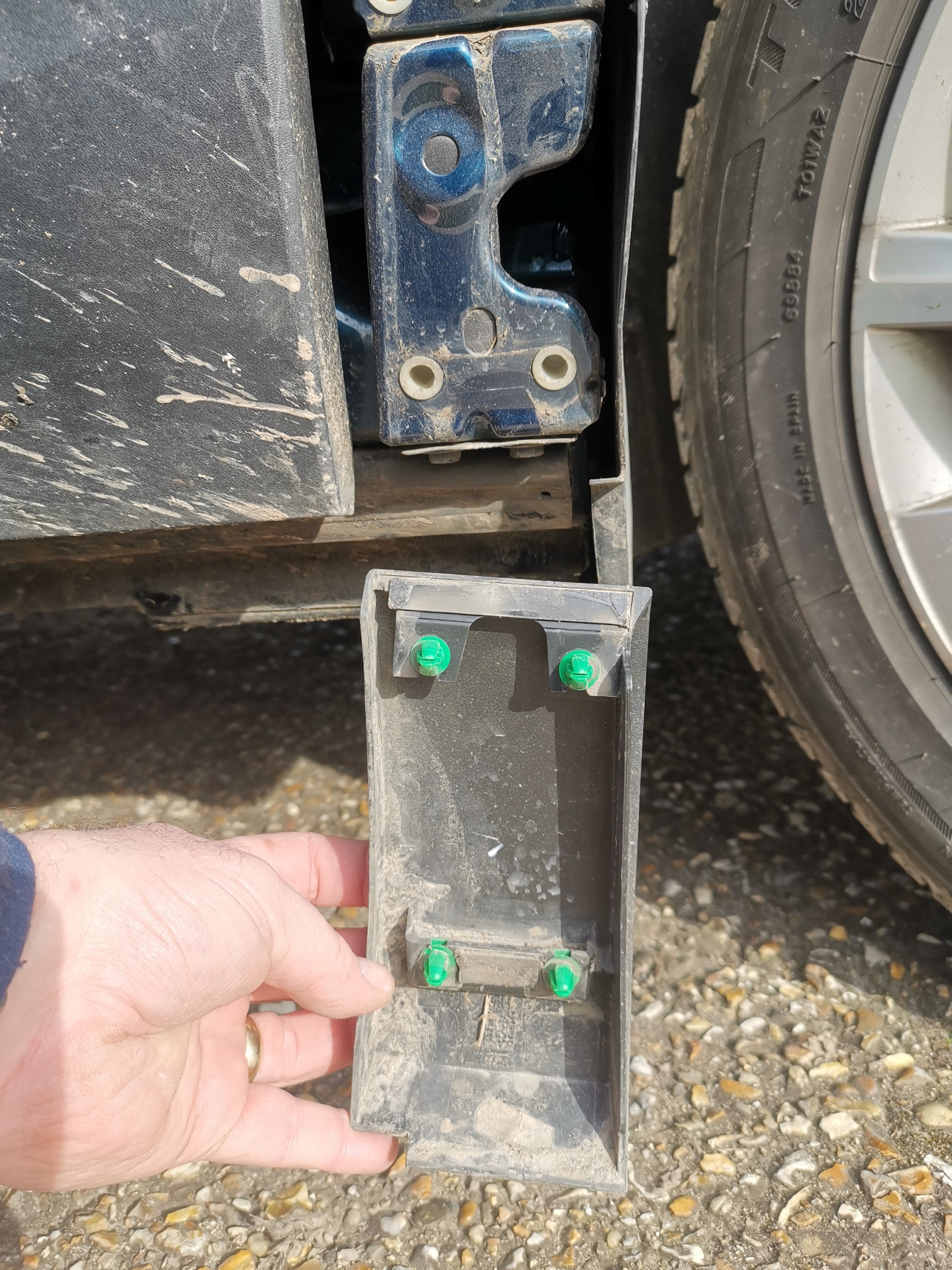

I'll set about the fronts tomorrow but note that you have removed the section of trim that is photographed in your hand. Did you find this necessary to remove in order to fit the mudflap and, if that is the case, how did you remove it?
Many thanks.
You don`t have to remove the sill end cap as the flap is shaped to fit over it, when fitting the rivets use a little WD40 or wet them with saliva it helps the pins to move.

Afternoon, as Delanor said, no need to remove, I did as initially I couldn't get a close fit, but that was when I was playing with the two different models, the A and the NOT A! The end cap just pulls off, it is best to do this when warm as a cold plastic trim is more likely to snap. The plastic rivets are designed to be a tight fit, if you do lubricate the pin, best to do so with something like washing up liquid, that way, once a bit of moisture is present it could wash away and maintain the friction to keep in place. If an oil based or ptfe lubricant is used, they are designed to remain "slippery" for a long time, and although unlikely, the possibility remains that the pin could work loose.

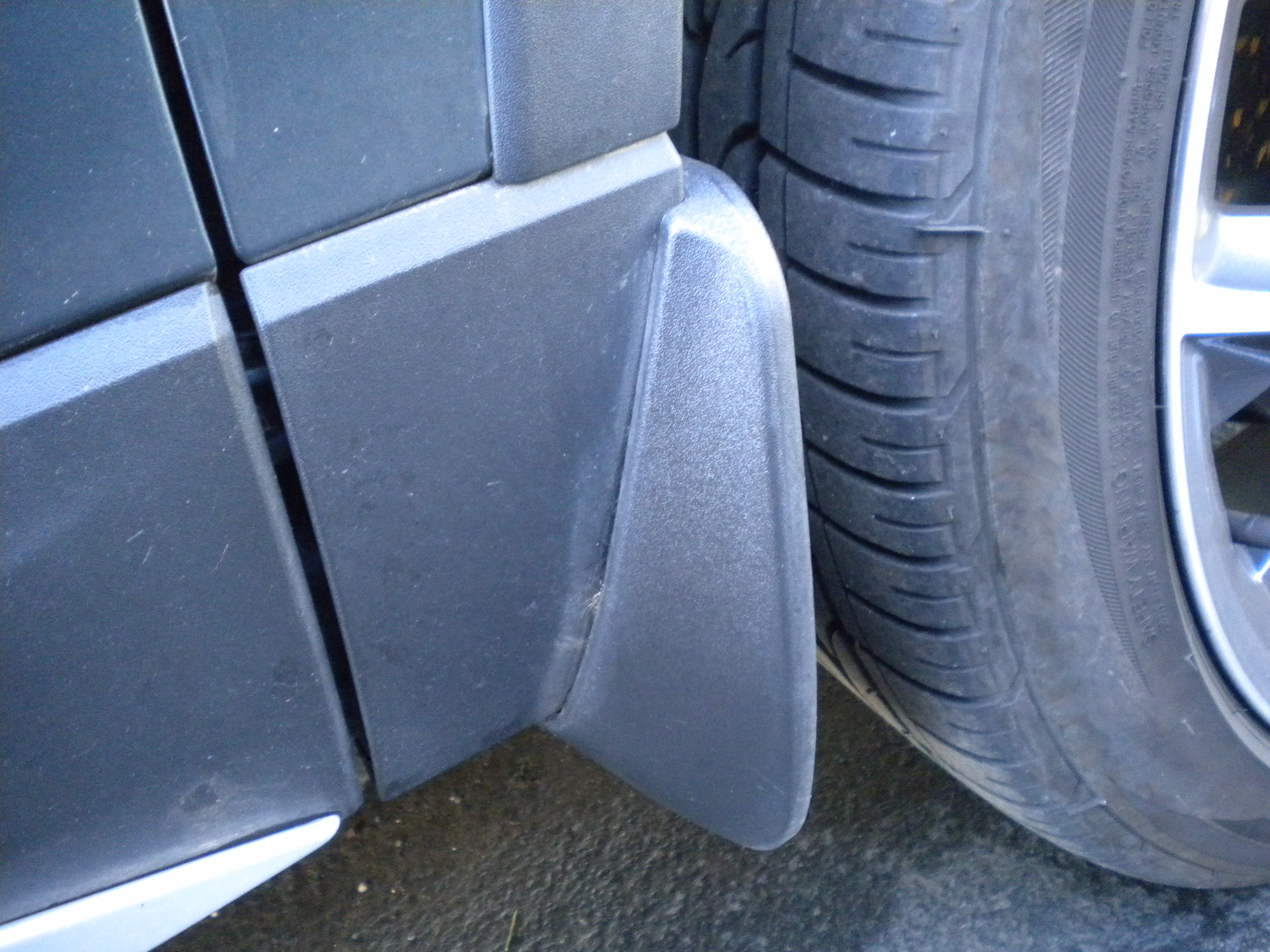

  This is my Scout fitted with front flap part no 57A075111A as the correct part listed and supplied by Burns when I bought them before Xmas, you can see it fits and the flap only locates over the sill cover and doesn`t touch the arch trim, its the same in the picture where there is no arch trims so I cannot see why the 2 flaps would need to be different.
