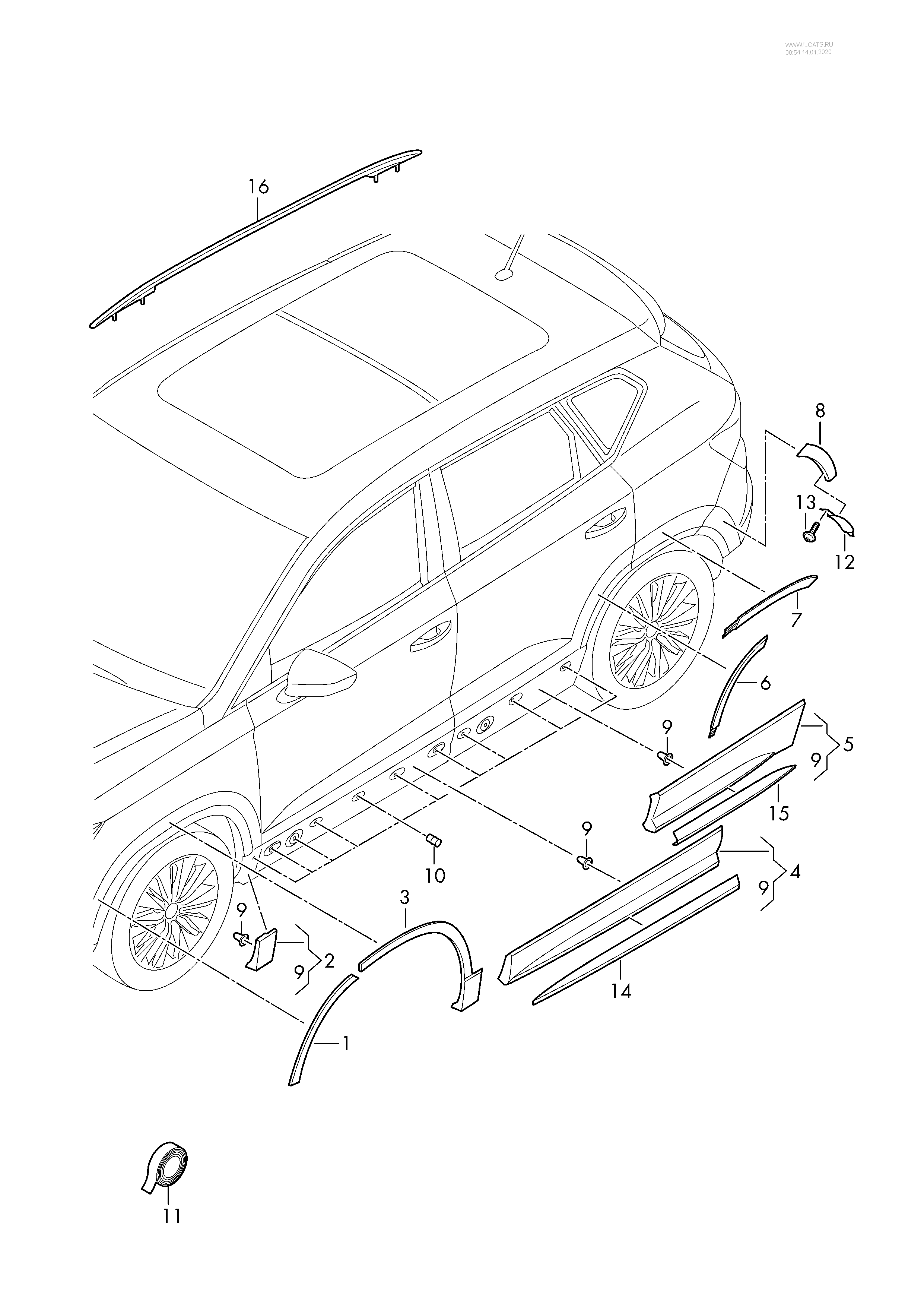

I've just ordered a set, negative wheel arch trim, and the numbers required are the ones without the A, I've seen an exploded view of a wheel arch trim set and there appears to be something on the rear edge of the trim. If I can find the picture I'll post it.
Found it. As you can see there is a piece of plastic at the bottom of the wheel arch trim. Possibly the part number with the A suffix is to take that into account?

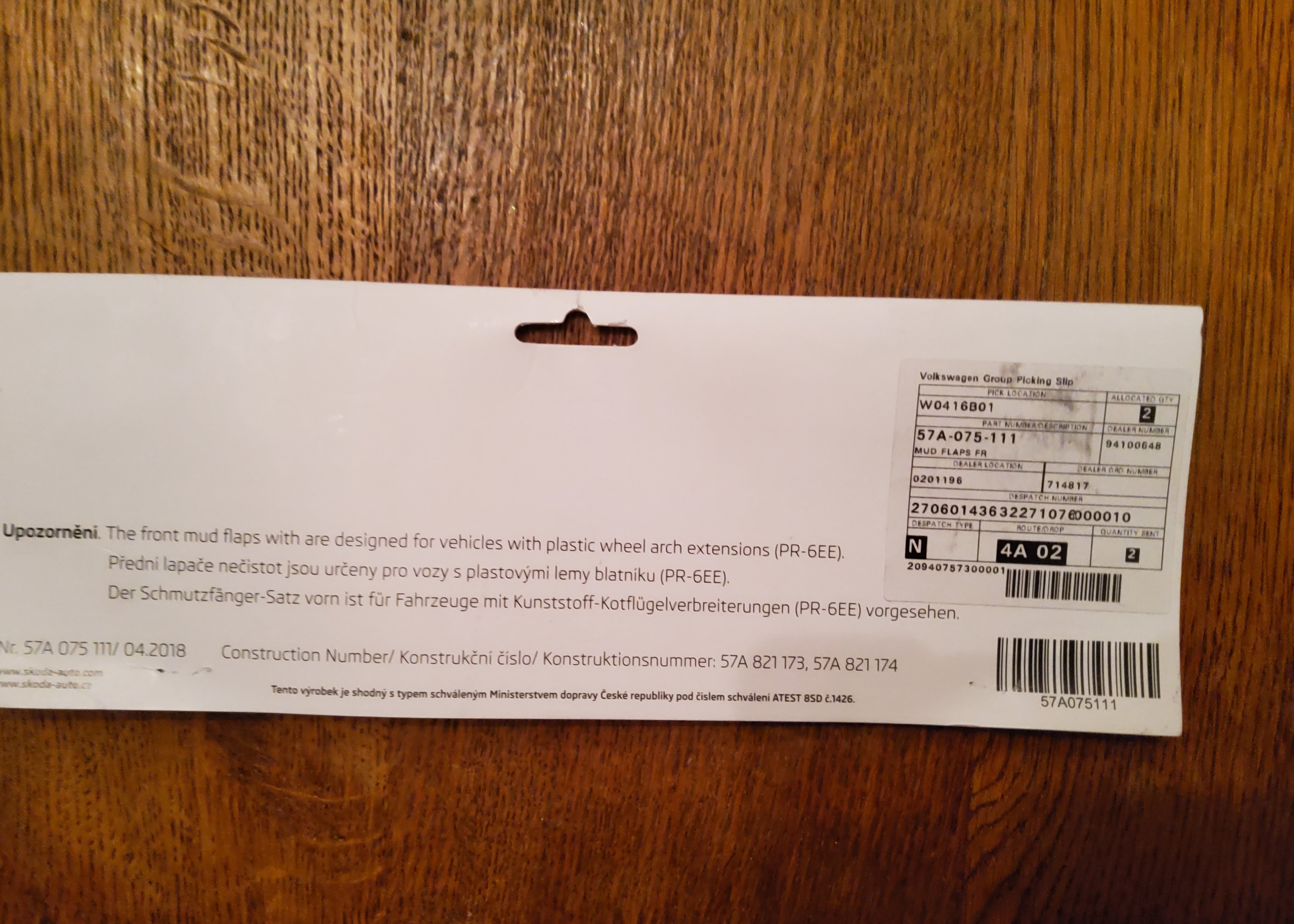

Now I am officially confused. My mudflaps arrived today, the rain has not stopped so not fitted, however please see the attached photos and if anyone can categorically state which front mudflaps should be fitted to a vehicle without the wheel arch extensions, I would be most grateful. Bit of a mismatch between VW picking code, instructions etc.
