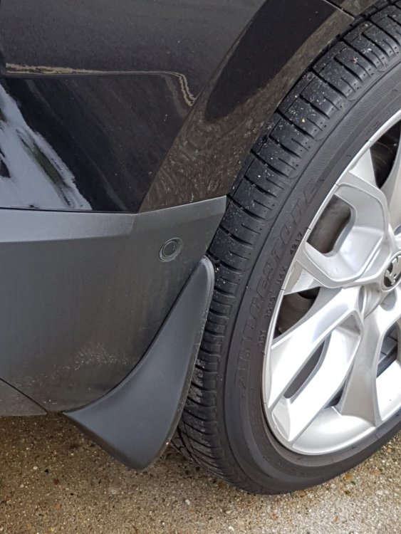

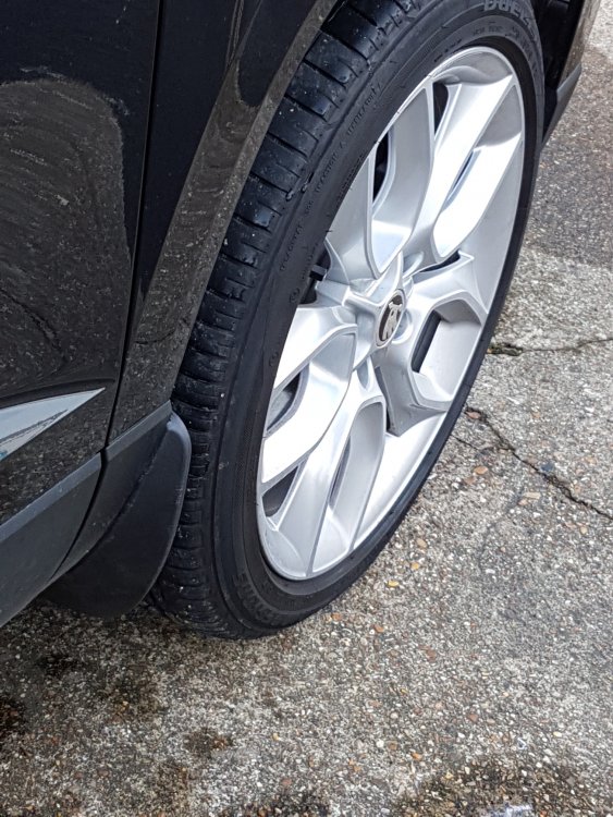

Mud flaps fitted and looking good. Rears took ten minutes each side, fronts took fifteen minutes each side. Fitted very much as Vectis describes. Except, after fitting front mudflaps temporarily to mark holes for the rivets, I used a 6mm wood bit with drill, very carefully to mark through both holes then prised the inner lining to drill through for the top rivet. Finally fitted small clamps to make the job completely solid. To drill I used my 18v Makita with 6mm woodbit. Fitted inside wheelarch nicely when turning the wheel to full lock.
