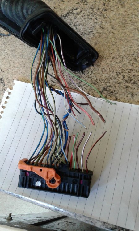

Had a fun morning fitting new wiring loom to drivers side door.
Not had opening windows since beginning of winter, it was fun just doing windows up and down both side's, yes I know bit of a sad'o but when you'vs done a good job it's fun. Oh yes, the little red light on top of the door which worked then didn't then worked again, is now working again.
Is the loom you have in your picture easy enough to get out, my gfs windows have stopped working and I'm assuming this will be the problem
Hi DM, it's just a matter of taking your time. Once you get the door handle cover off, it starts to fall into place what to do next.
It's easy enough to check if the wires are actually broken before you take the whole lot out, just pop the car body end of the rubber boot off and slide it back along the wires. You'll soon see breakages if you have any.

Replace the driver's door wiring loom and all will be fixed, very easy job to do should take around an hour start to finish, just get some spare clips for the door card and you'll need a drill to remove the rivets for the speaker and then some to refit it
