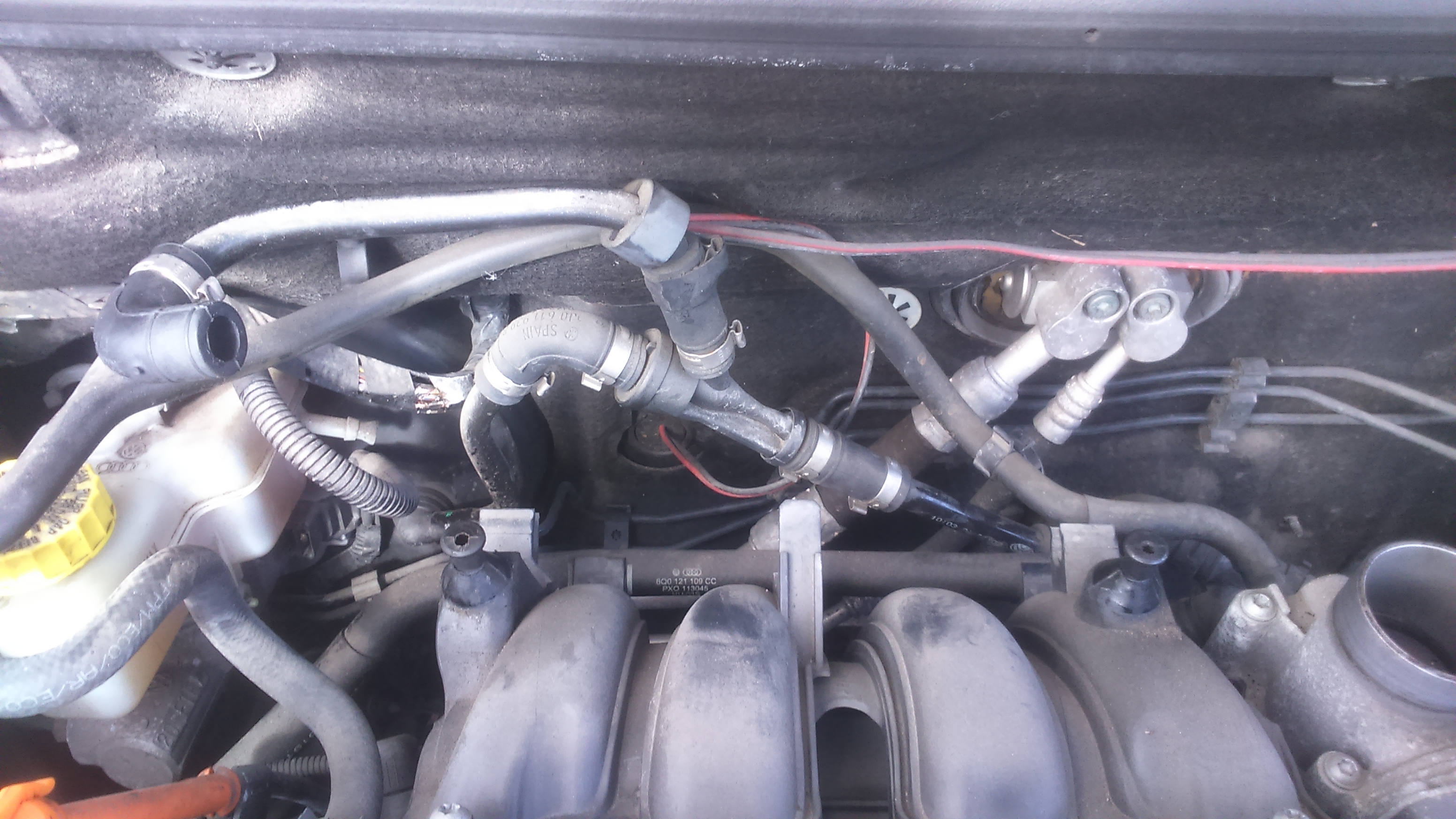

Photo of yours?

Got around to taking a snap.
Yes, that's all vacuum pipework, none of it can leak.

I'm still mystified by (exactly) where that unconnected leg goes and what it does.
Got a photo of where it connects to the airbox?
Does the engine run better if you block that off and run without the airbox?
I've just come back from a 12 mile round trip and not once did the car stall. Wino, the unconnected pipe goes to the side of the airbox.
