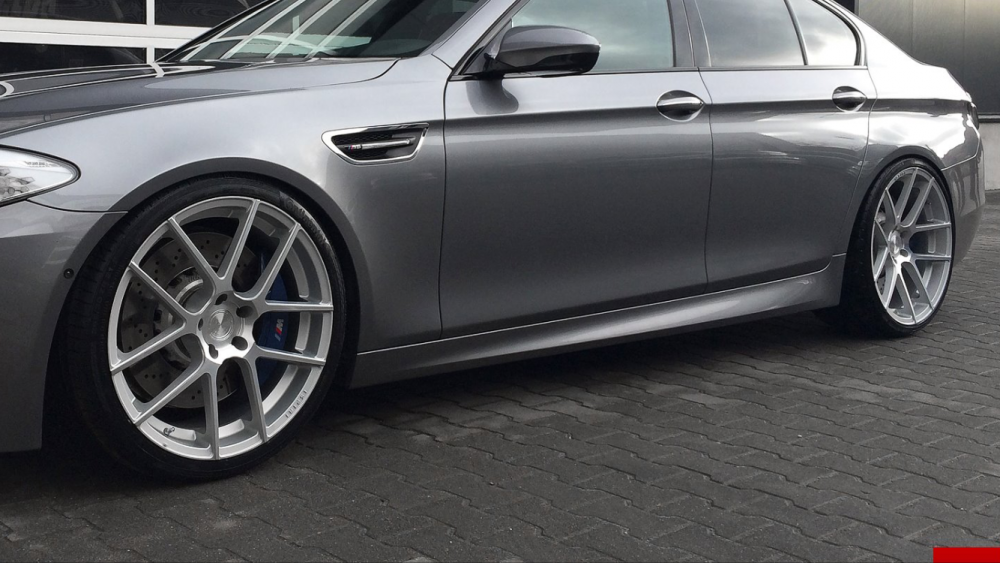

Here are the Veemanns.
19x8.5 ( not sure if the picture is of the 19 or 20s).
Damn they are pretty.

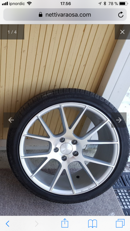

Here are the Ispiri
20x8.5 et42.
Fitment is perfect. Wish they were a tad bit more concave tho.
