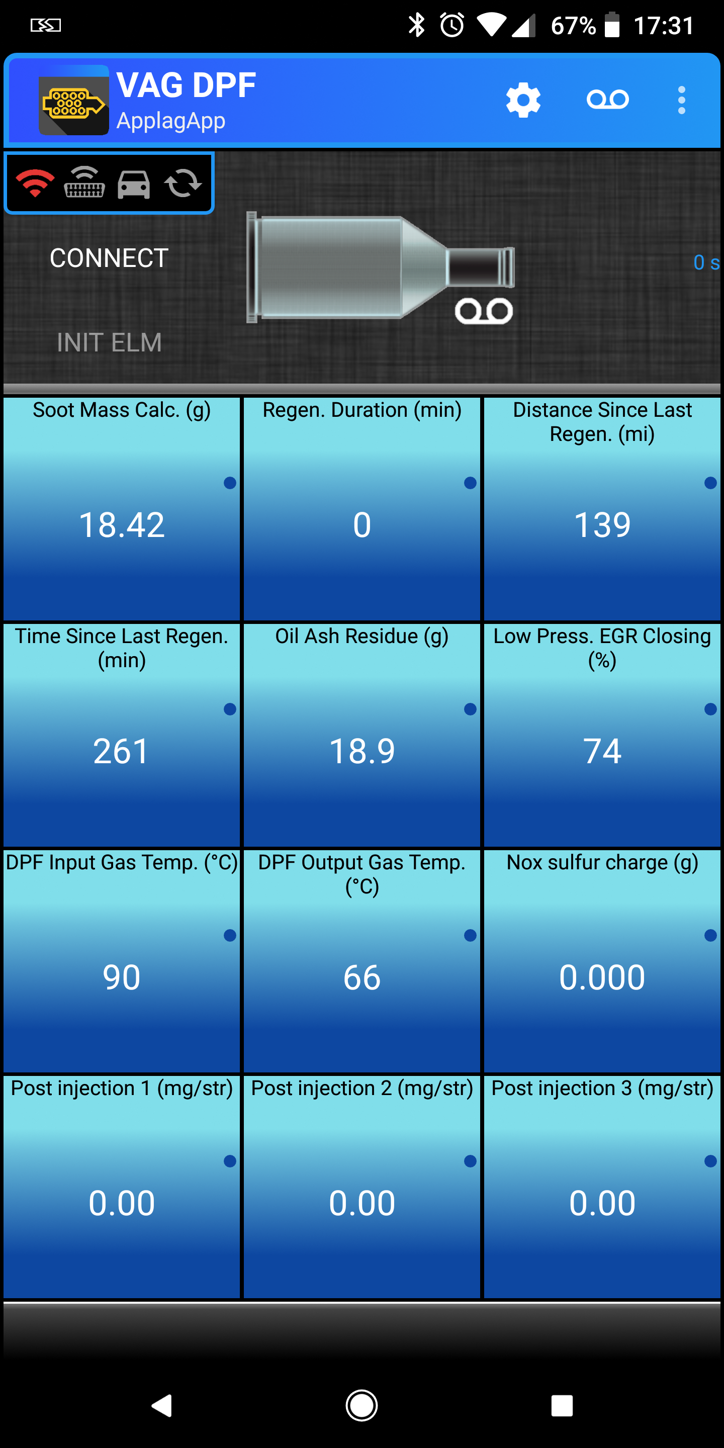

DPF seems to be good and loving the car

Theose are just figures provided by the sensor. And we all know just how realistic VW Group sensors in their deisel cars are ;)

Its not the accuracy of the sensors, its how the Software interprets the data they present.

VAG don't have a good track record for trustworthy software on their diseasel engines ...
