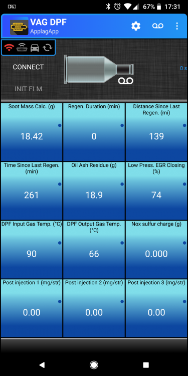

DPFs aren't covered by any warranty known to man so I'd be very careful. My advice to anyone buying a used VAG diesel is to use VAG DPF and see how full the DPF is.
You need an adapter like this one
https://www.hypermiler.co.uk/dpf-diesel-particulate-filter/vag-dpf-vw-which-obd2-ii-elm327-dongle-should-i-use-bluetooth-wifi
On a second note - anyone with the app and dongle here - please post your results so I can compare my 15' 43k 184
