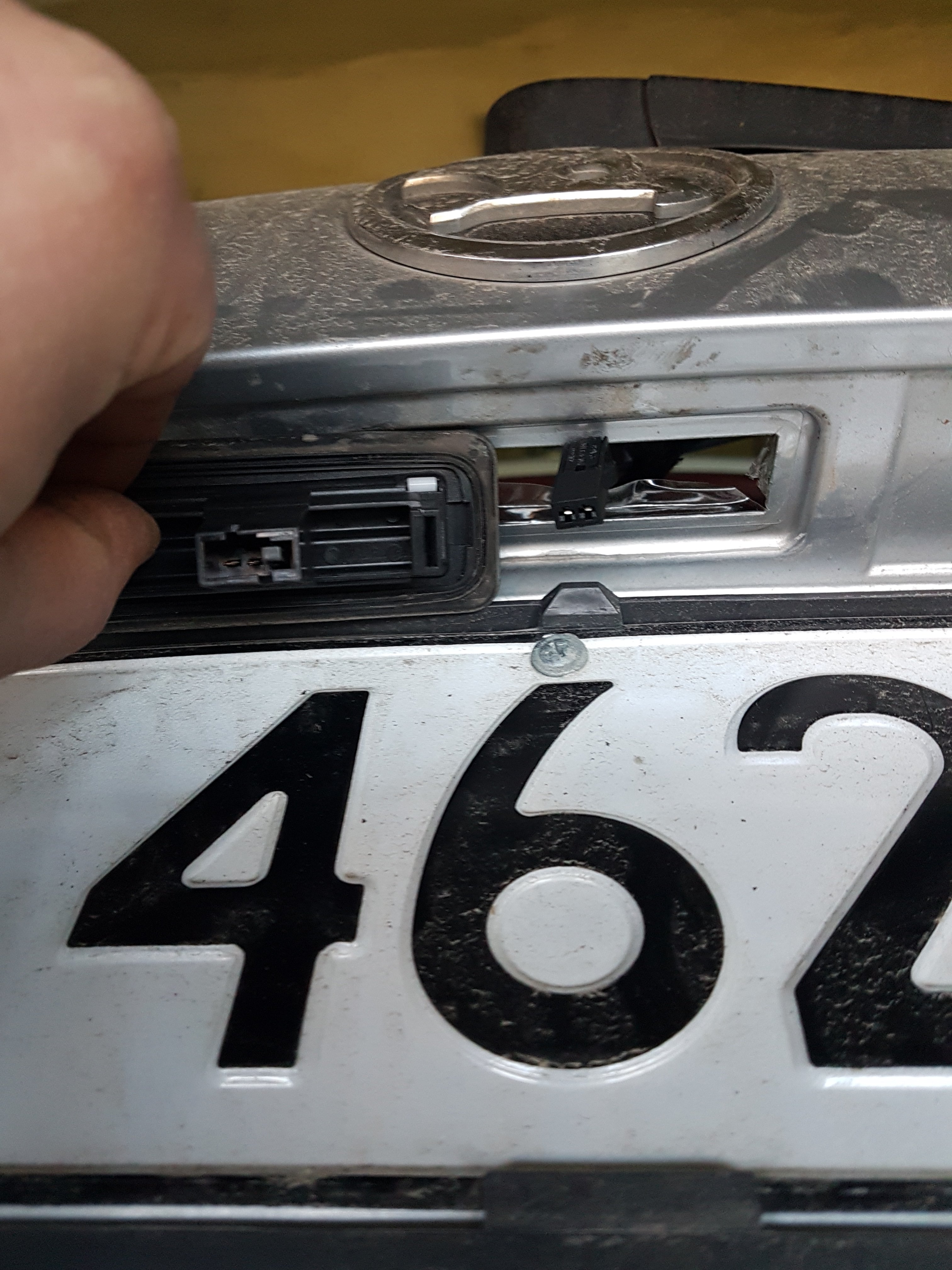

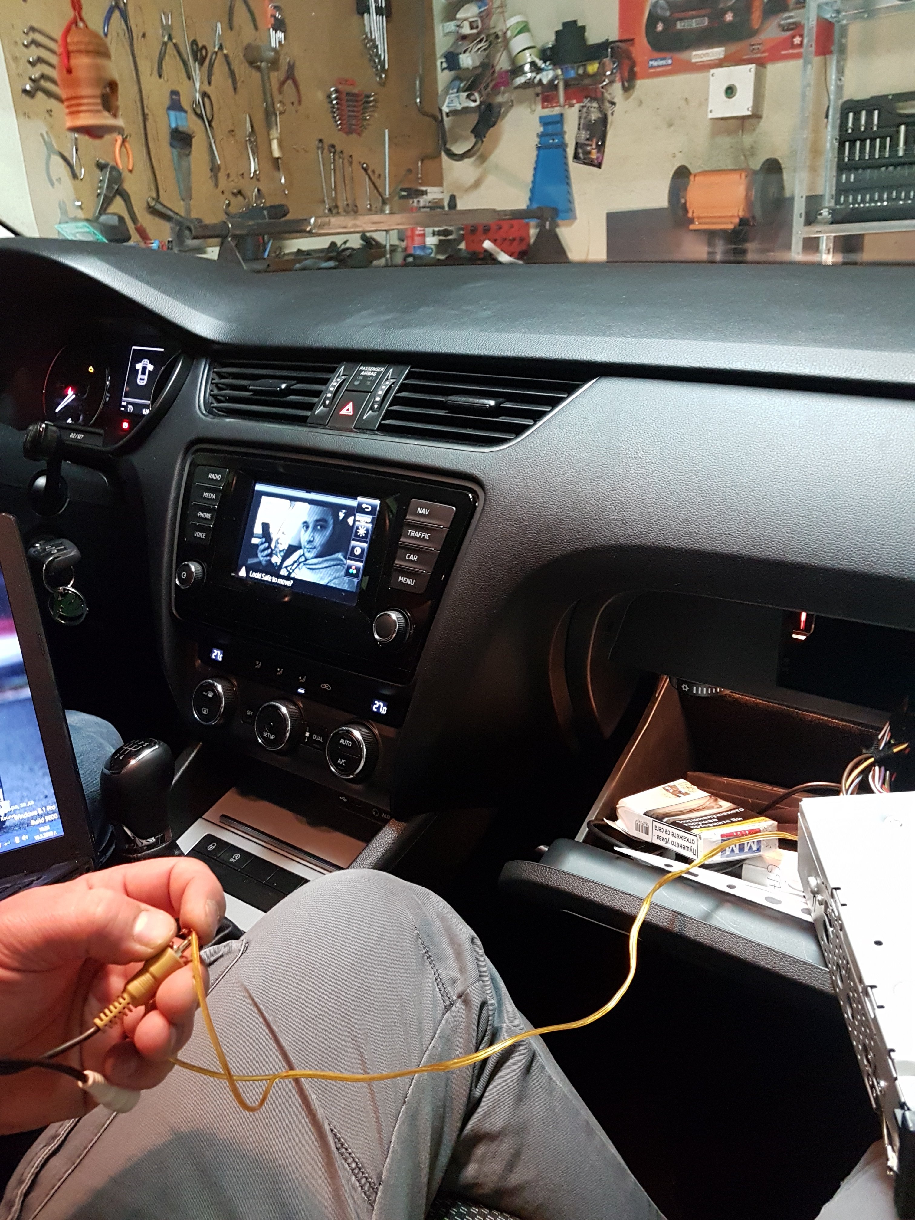

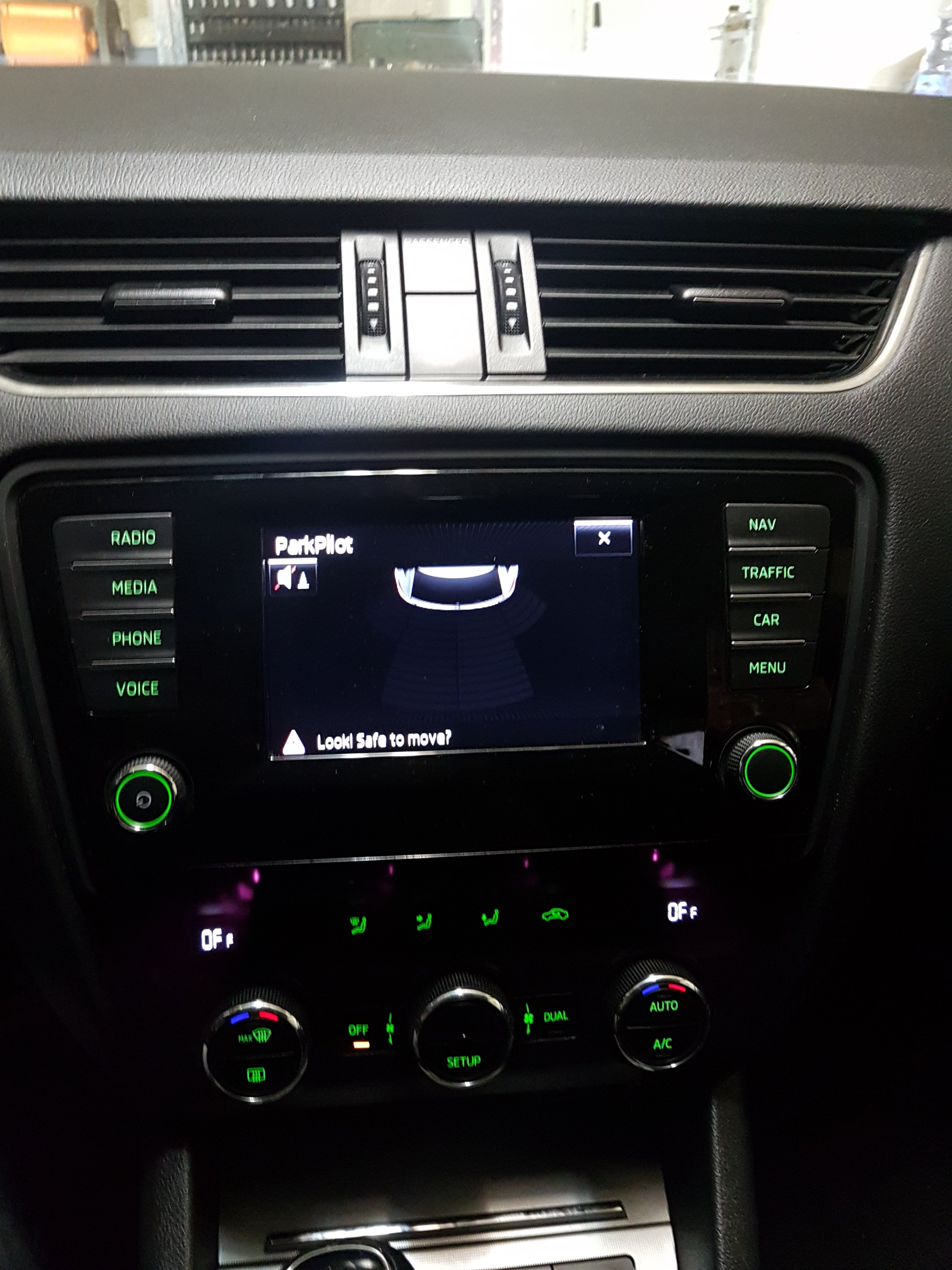

Hello, I encoded the camera reversing system, connected pins 6 and 12 with a home sample chamber and worked. Now I've got to find the right camera to not cut the trunk lid.
Pop out the trunk release handle and take its measurements, then look on ebay or aliexpress for one with the correct size. post the size here and I am sure we can find one.

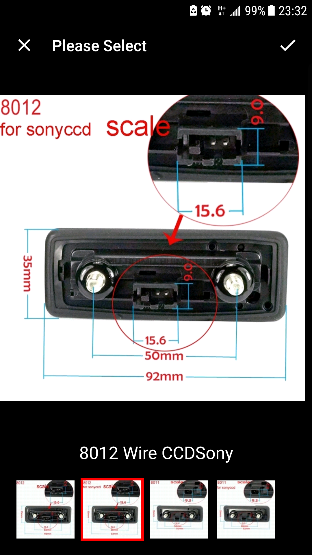

Mine is 2016 and I fitted this one, it works perfectly:
http://s.aliexpress.com/RVNrU3q6?fromSns
You just need to make a pair of small brackets to secure the bolts inside. Very easy. :)

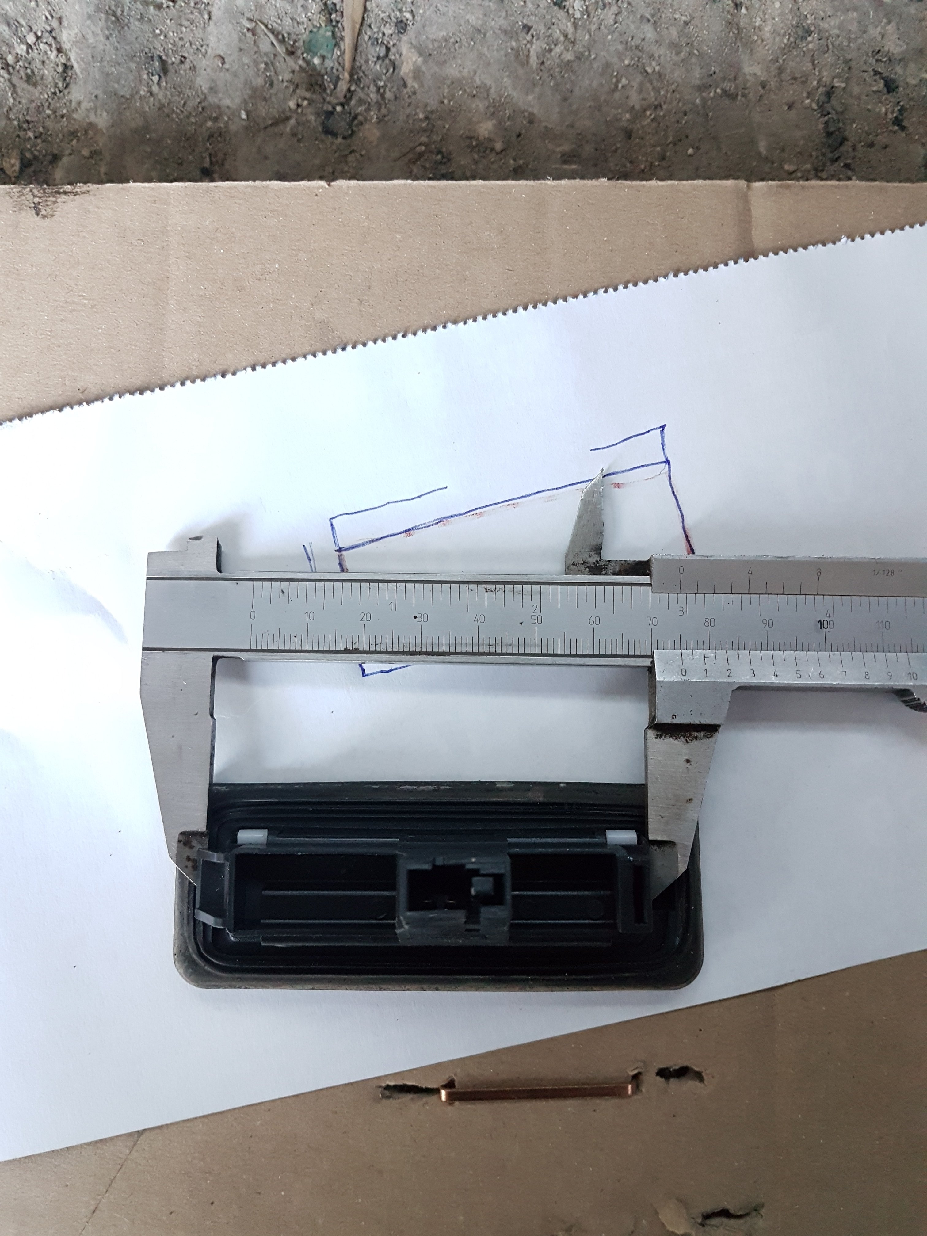

This is my size and cable size
what year is the car as the dimentions you have given are smaller than mine which is 113mm x 51mm approx
John
My octavia is 2014 yahr
