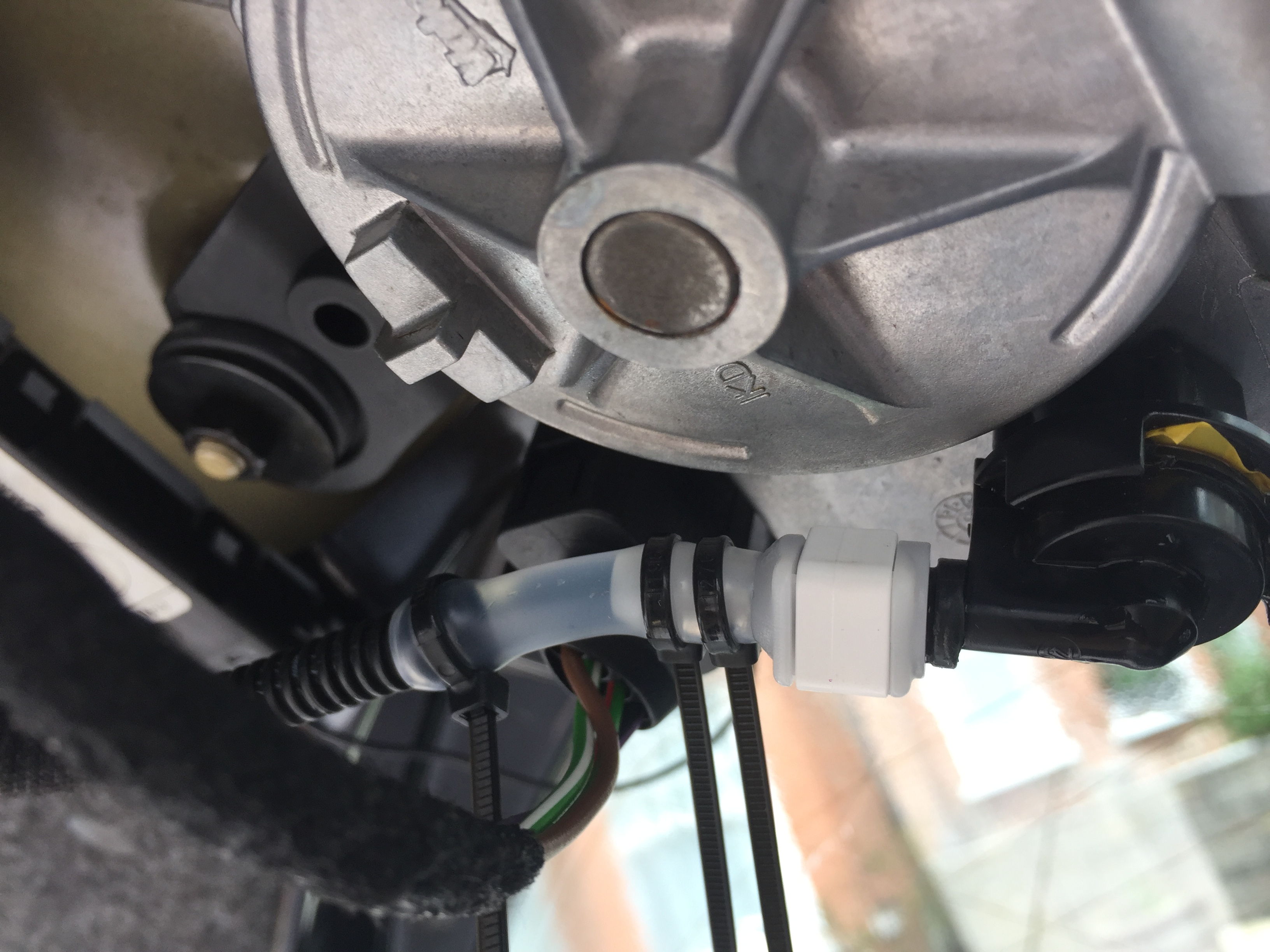

After the big freeze my rear wiper tube detached at the back and didn't fit back on snuggly and leaked. I will say at this point - it is a shocking design that my unborn baby would have done a better job of.
Anyway - I took the little plastic bit in to my local parts shop and bought some new tube. Of course the plastic fitting on the outlet pipe is a different width to the inlet for the wiper... I managed to get it over both bits and secure with tight, thin cable ties. (PICTURE ATTACHED). The tube stays on but it leaks out the back of the tubing. I think it is potentially blocked coming out the wiper, I removed the wiper nozzle and cleaned out and it fires through but still with some back leak. I think it might be blocking up between the inlet and the nozzle bit can't work out how to take it apart to clean it.
Is anyone able to send a picture of their rear wiper to see if my fix coudl be better?

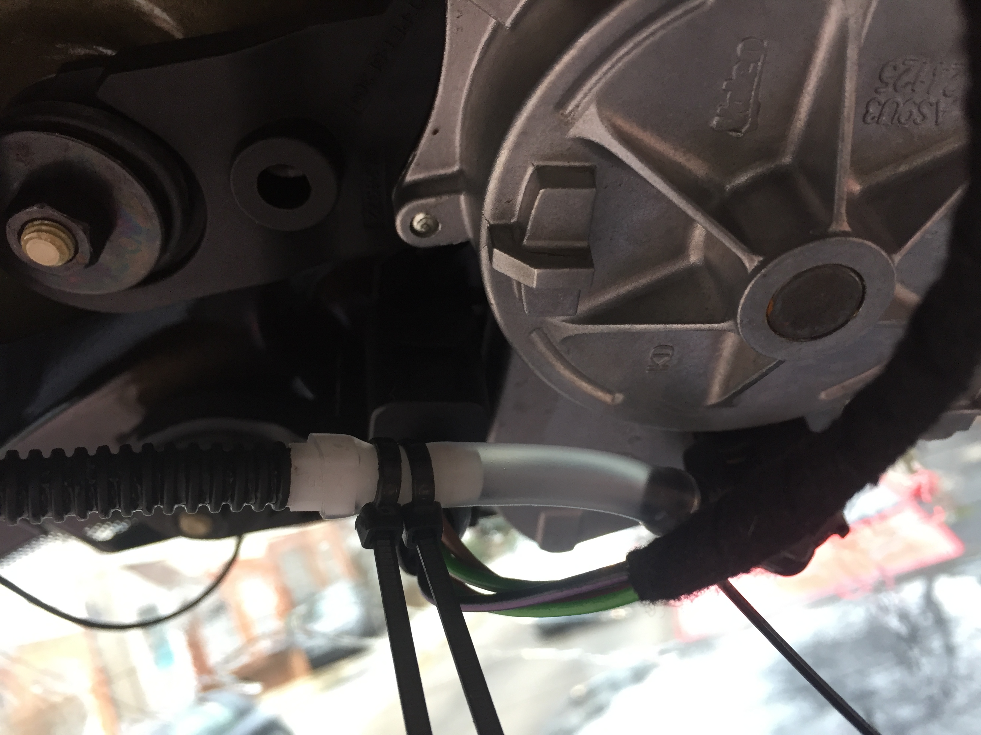

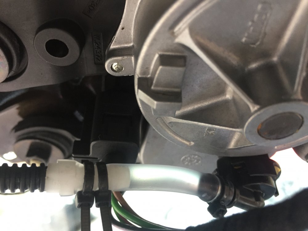

Further to my post - I got the part and a new nozzle but still getting a leak from the back. Its driving me mad now. I'm beginning to wonder if there is a slight block between the inlet of the washer hose and the outlet at the nozzle...
Most recent picture. this is using the couplr part sent by skoda, then a bit of tube to connect up the washer pipe. I still can't believe this is the best way to do this?!? How are they out of the factory (can anyone post a picture of theirs?)

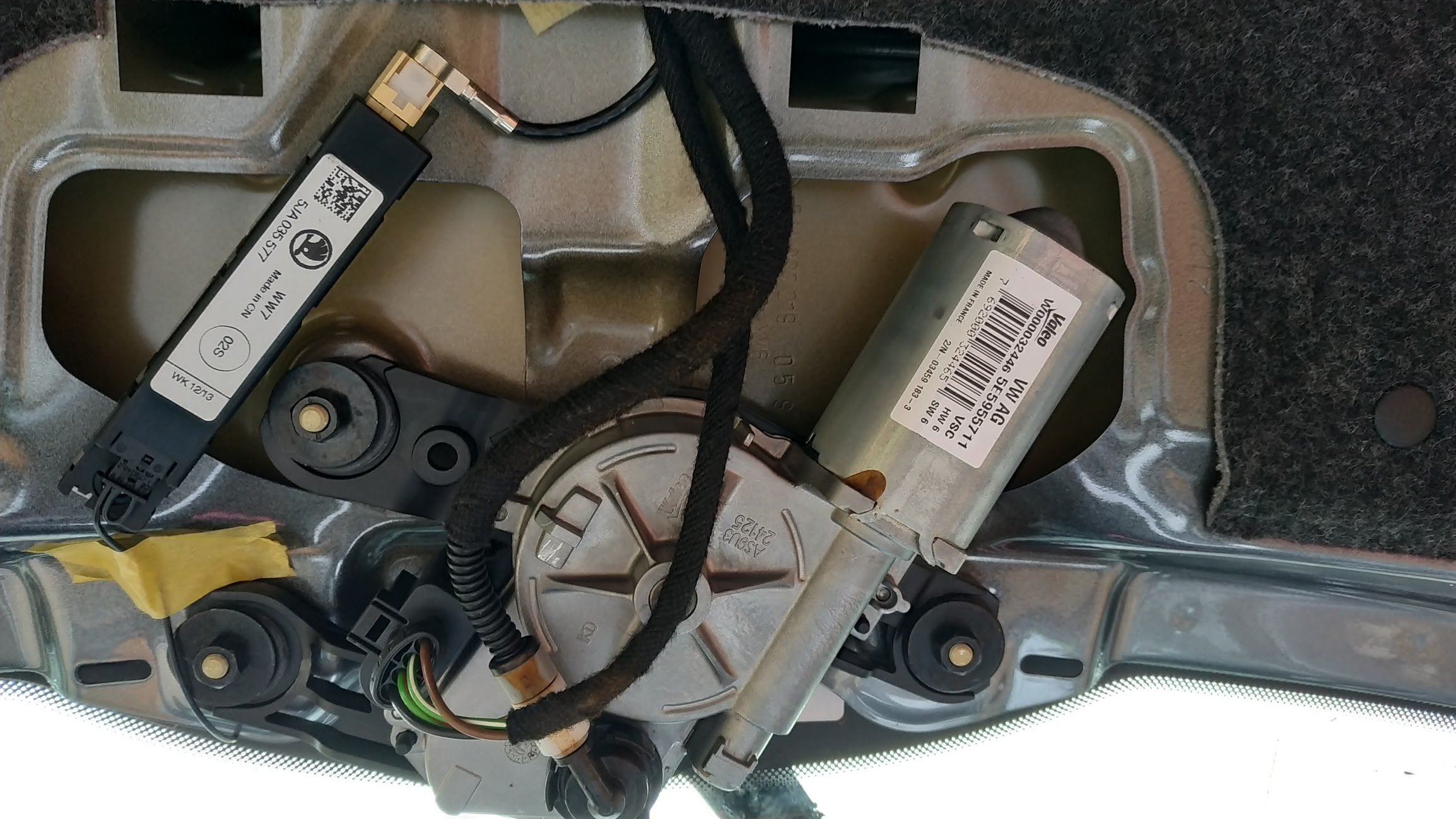

Did you have the same motor as mine:
Where did you buy a replacement from?
I'm told mine has died, and the dealers initially quoted £300 to replace!!
It looks straightforward enough to replace, so I just need to find a replacement - ideally new.
