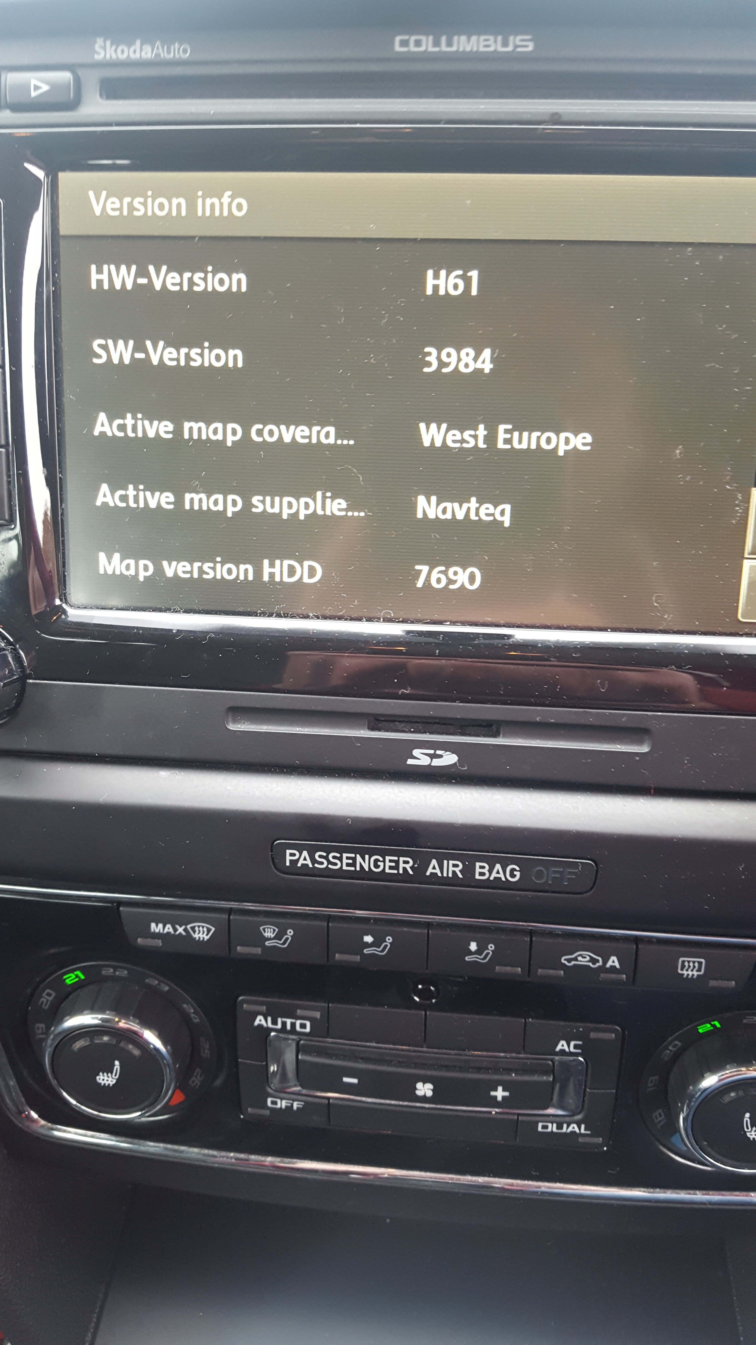

Thank you Drefaldwyn.... that is a very good link to a very comprehensive instruction. Much appreciated. I have checked my current sw and hw on the secret menu and I think I will upgrade the firmware as per the instructional guide to 5238 and then purchase the newest maps to load on. See image of my SW / HW + maps.
If anyone can advise different please let me know otherwise I am going to attempt a rebuild later today.
