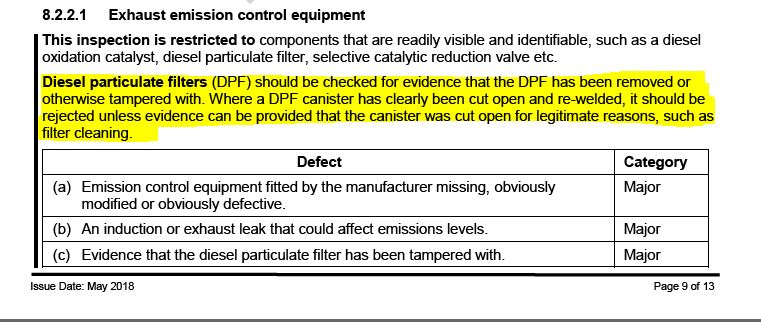

They will be doing a physical check for it's presence, and if still fitted, but has had it's guts removed (signs of welding on the case) then it will be classed as a major fail
I can't really see what's changed. It's always been a visual check for evidence of removal. Unless the fact that evidence of a weld is an automatic fail is a new rule. But surely that's easily got round depending where the weld is. I honestly thought it was going to be devices plugged into the cars ecu for detection of a functioning dpf.
For cars with a dpf then any visual smoke will be a fail. Evidence of welding/gutting will be a fail. It will be very difficult to fool the new mot with a gutted dpf. A check will be made to see if a dpf should be fitted so complete removal is also not an option.
You could however test the car before the May rules start and buy a year's grace.

Any visible sign of welding to the DPF filter housing will require you to prove that it's not been gutted out and is there for a genuine reason such as  cleaning it out or the car will fail on the assumption it's been removed....any sign of smoke on a car fitted with a DPF, irrespective of colour, will result in a fail too.
All you need is a homemade invoice from a garage as "evidence" to show the DPF has been opened up for "legitimate reasons, such as filter cleaning."

I think that MOT garages/DVSA will be wise to a trick like that.
I'd hope you were right, my point was that the current system is incapable of properly identifying an absent DPF, and the latest changes to the rules haven't addressed the issue properly.
For the most determined, the latest MOT changes won't be a sufficient deterrent.
The most effective way would be to work with the manufacturers and strike up an agreement that they don't massively inflate the costs involved in replacing a faulty DPF.
I was quoted £1,200 from a Skoda main dealer, on a 100,000+ mile / 5 year old / £4,000 Octavia. It's hardly surprising people look for ways to keep their (otherwise perfectly reliable) car on the road.
If the DVSA do eventually find a way to effectively identify an absent or faulty DPF but the cost of a replacement doesn't fall then a failed DPF will easily right-off a car.
Identifying a missing dpf on the mot should be simple, anything more than a 0ppm on the smoke test means it has been removed.
