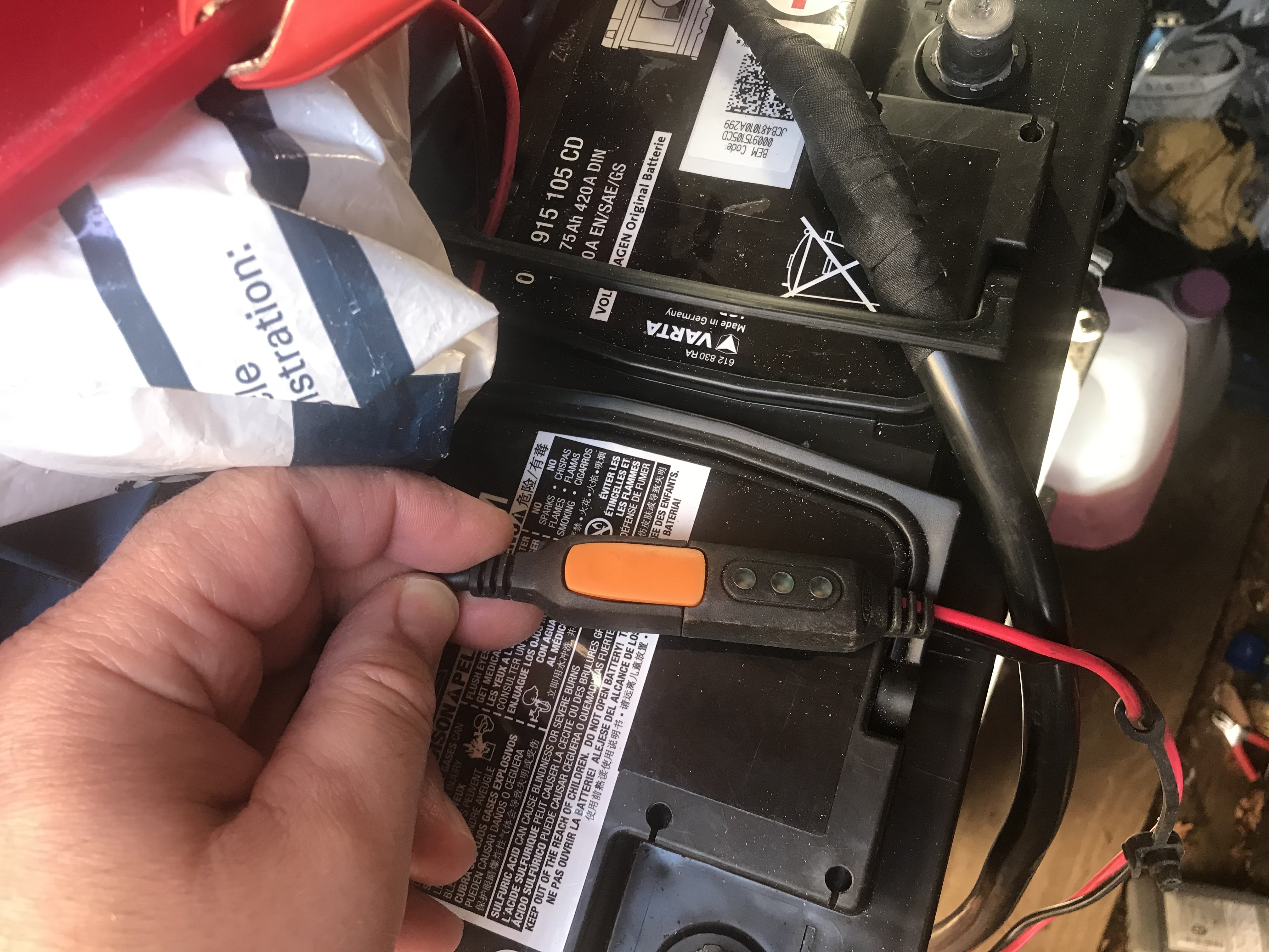

    Not definitively but I looked into this quite exhaustively. My plan was to have the boot battery charged when the main battery was full, there are devices made (for caravans/force vehicles) for t

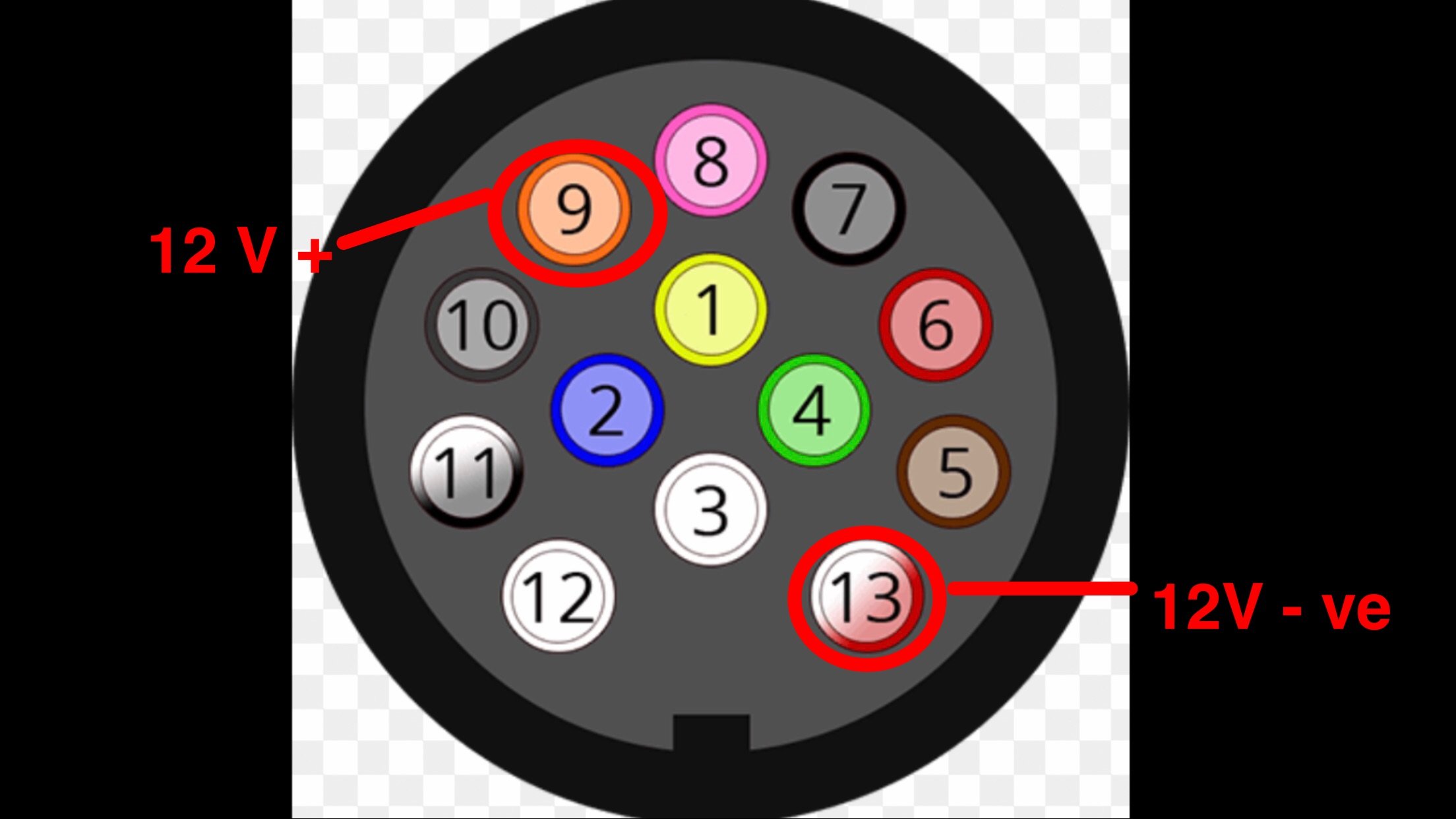

13 pin plug terminals used to charge car via the plug.
Charger +ve to pin 9
Charger -ve to pin 13

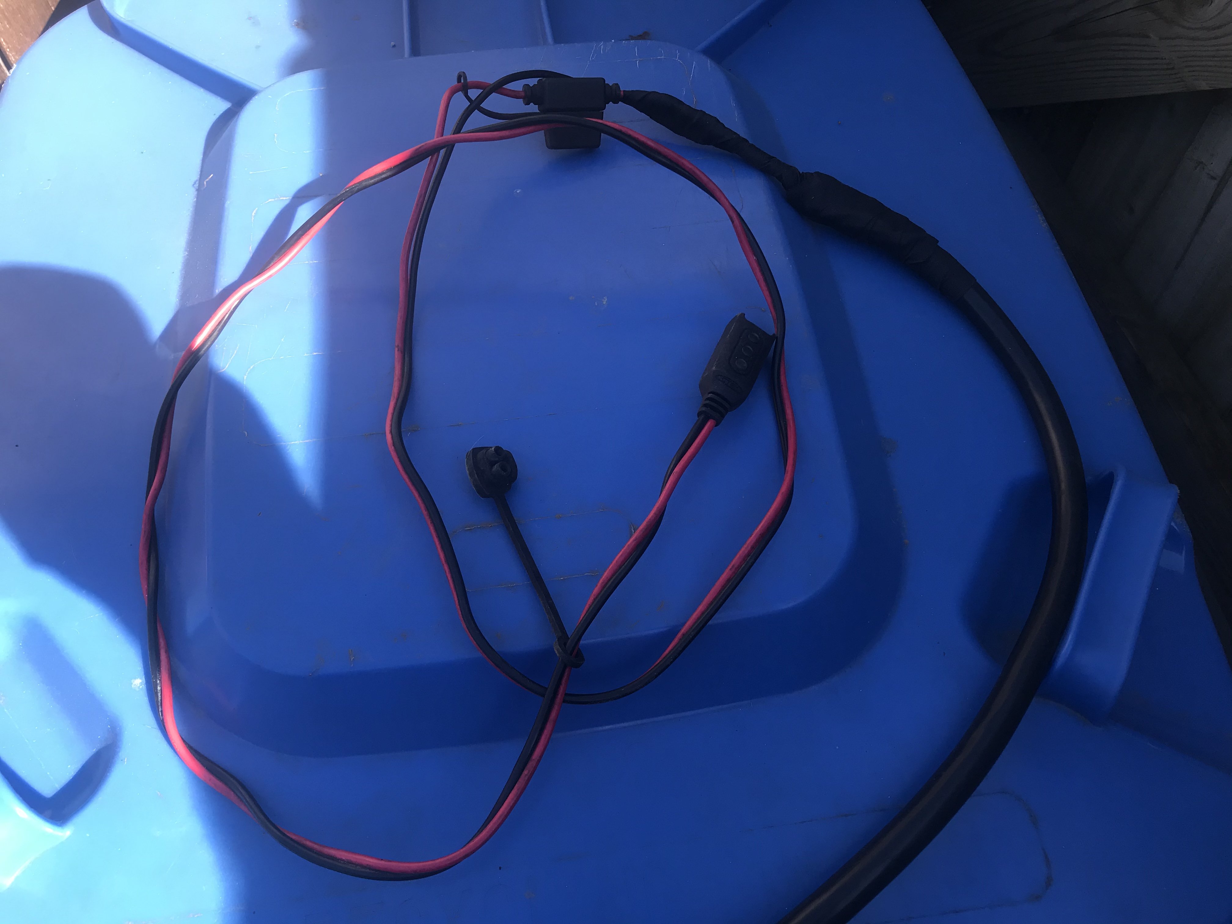

To get quick release connector and fused link with indicator I just cut the crock leads off a spare Cetek charger connector, that way no damage caused to the main charger output  lead (just the cheap crock fly lead).

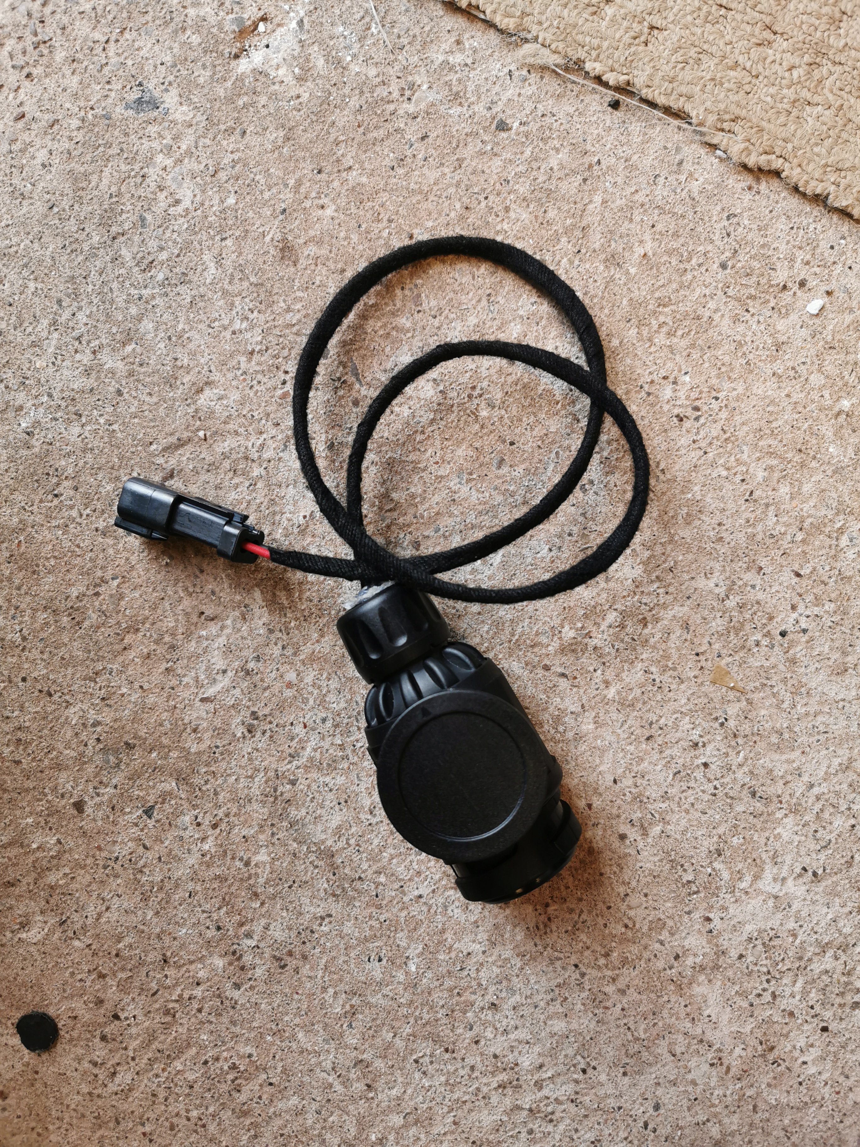

Yes I made one of those leads for battery charging through the 13pin electrics I just fitted.
Works very well. Company on ebay sells the for £30 but I bought a maypole plug for £5 and used on a old ctek cable to make it.
Cut the ctek connecter off and used deutsch as they are superior for extended out door use.
