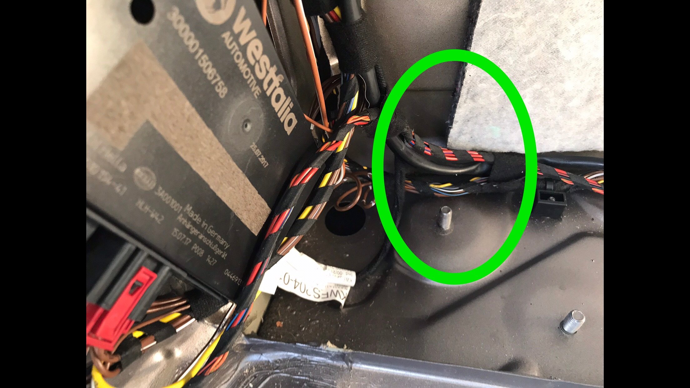

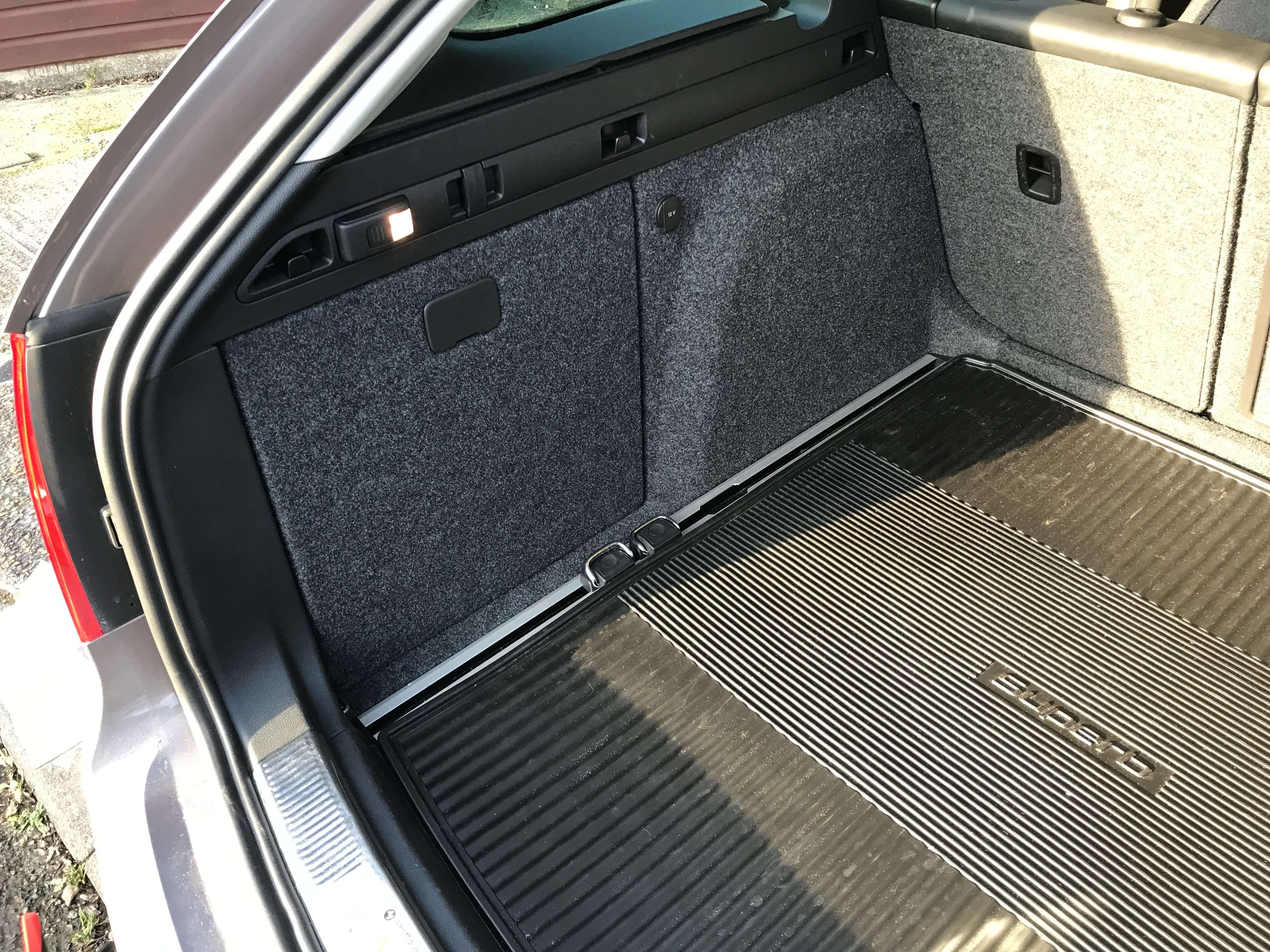

Started looking into the install in my combi. As you can see, the studs are in place already. The large grommet towards the rear of the car (left of the picture 0603) is replaced with a different material for the drain vent hose. I wanted to order a left boot liner with lid from a 3.6 combi with my colour scheme which is yet to arrive. so I can return it to standard if I ever sell it, and I MAY go for a CETEK Dc to DC charger but not decided yet.
With this fitted, I can leave the car standing and my camera on for 5 days with full live stream over the cloud.
Thanks for posting about it and showing the photos. Although mine is a hatchback not a combi, as the rear battery was intended for the V6 which is also an option on the hatchback, the studs should be present on mine too, I am guessing. That's good because I was put off by the idea that I'd have to drill holes which I really didn't want to do.
Presumably the tray was not already in place under the liner, but you ordered that and installed it?

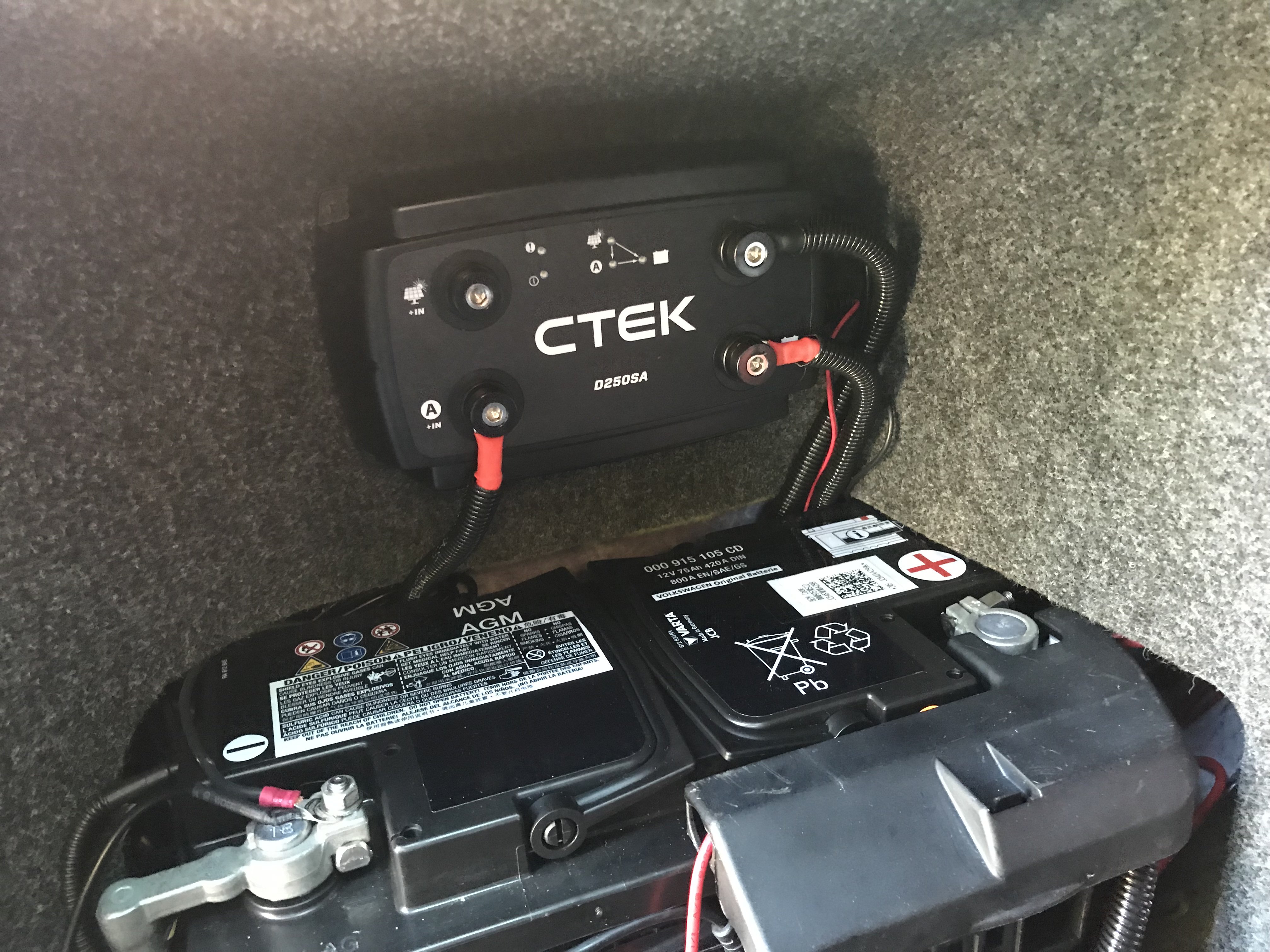

IMG_0861.thumb.JPG.145550577a4ec6717b76b04c6d634378.JPGC3BEBCF0-9F86-46C0-8BBD-509B408B5141.thumb.png.872e0ae2298f6853eaf50e9a445e79d5.pngIMG_0861.JPG

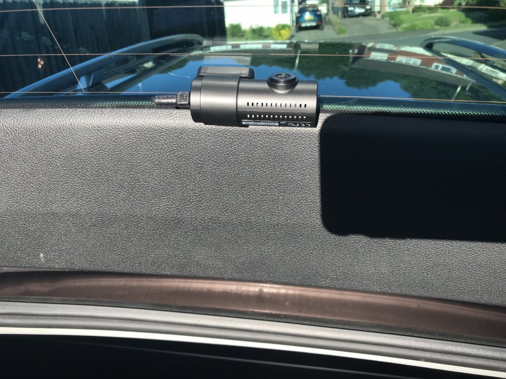

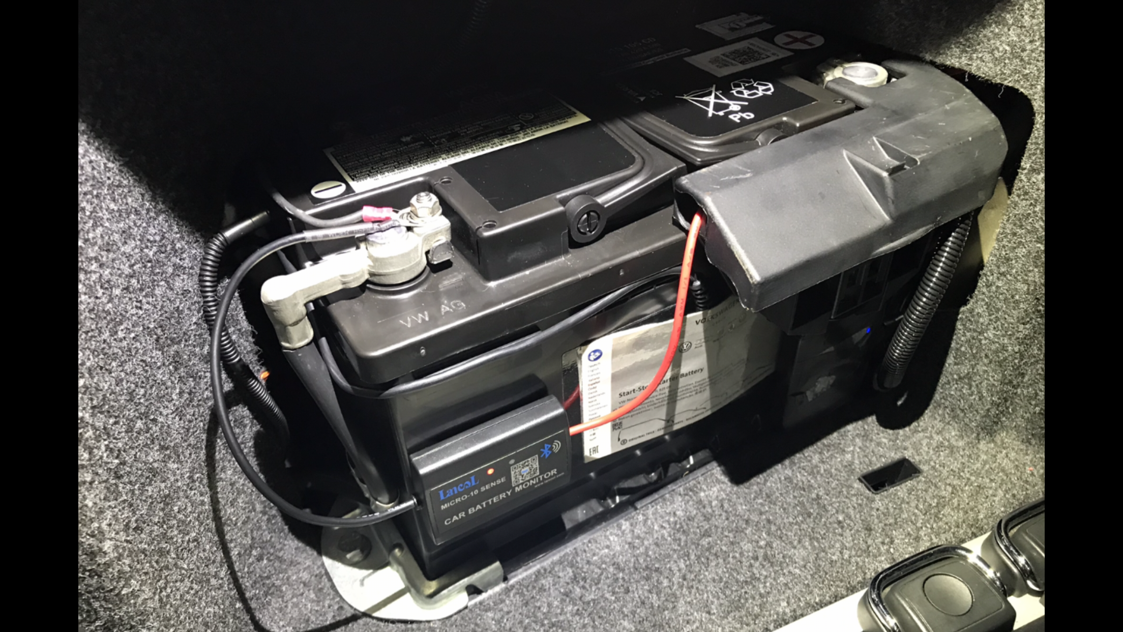

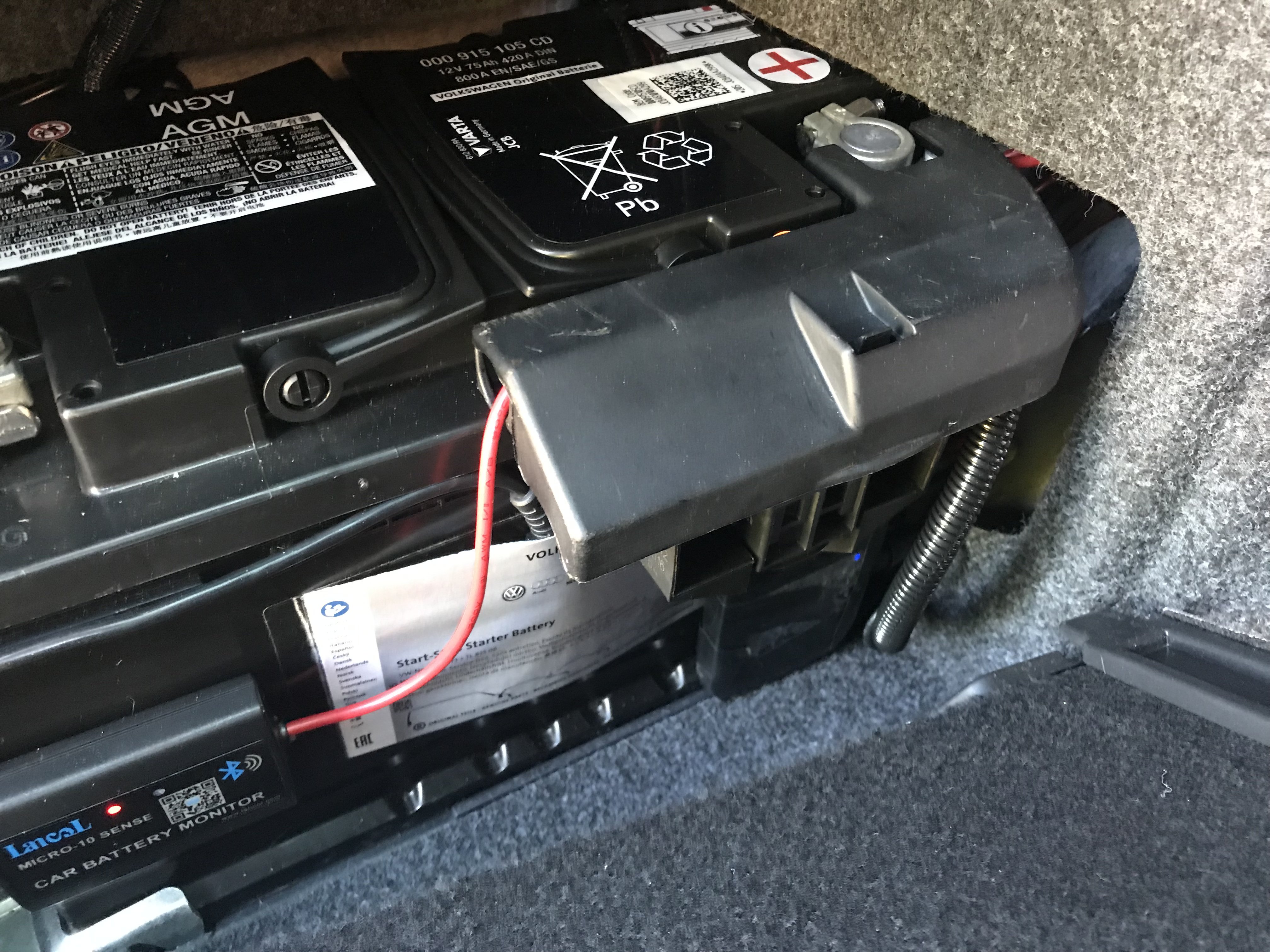

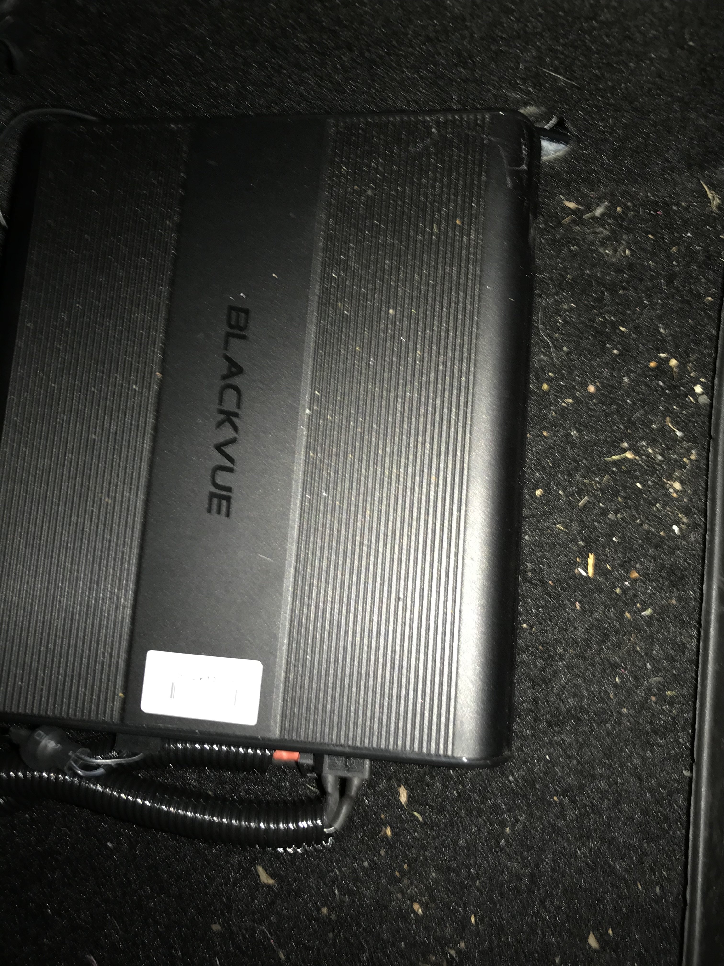

Managed to get battery fitted in the boot to keep the buffer camera battery going for seven days in parking mode, totally isolated from the starter battery. Uses EE in car Wi-fi to transmit to cloud to give live feed front and rear. Very happy with the outcome.
Edited by 3T1704X4

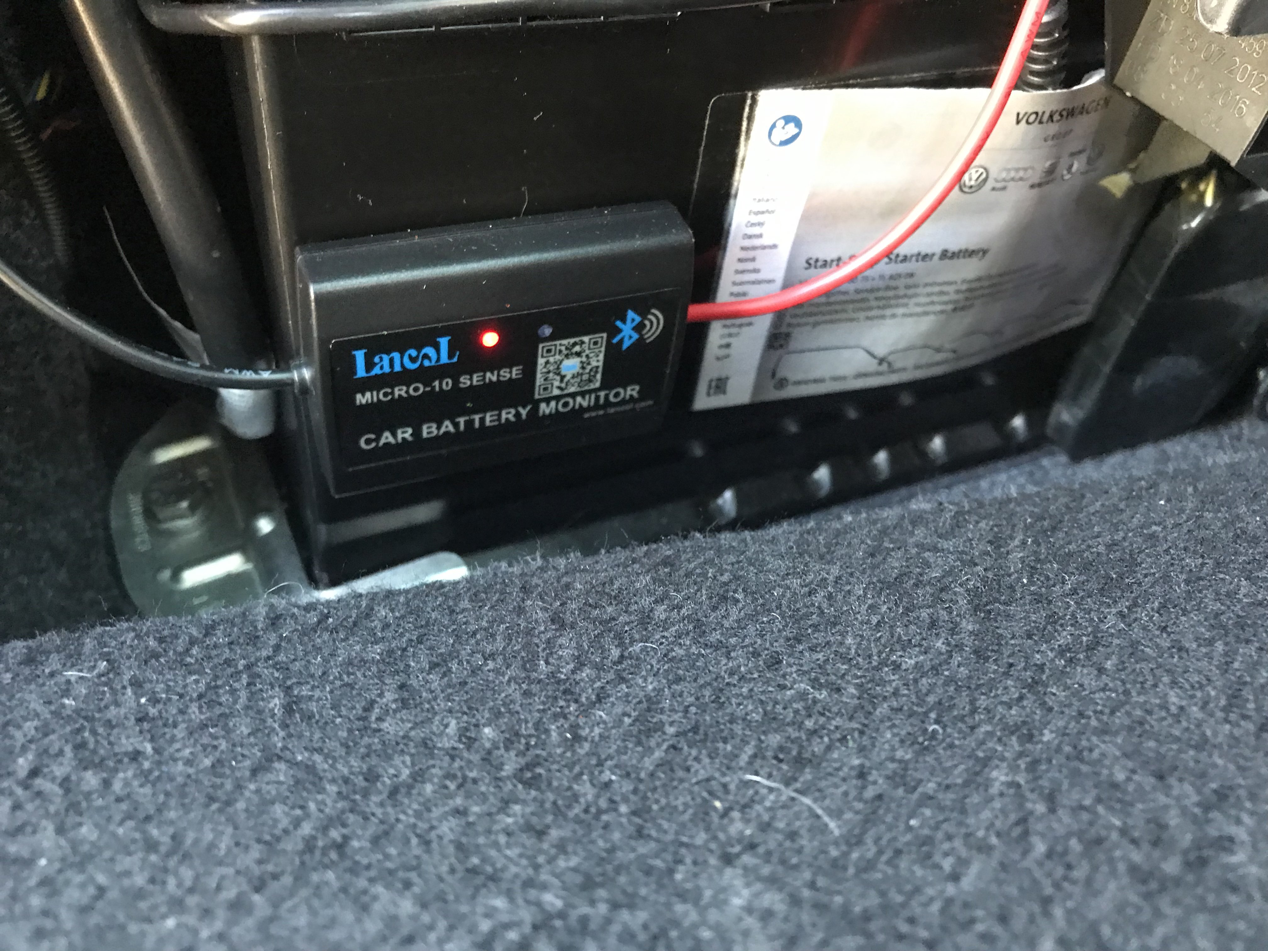

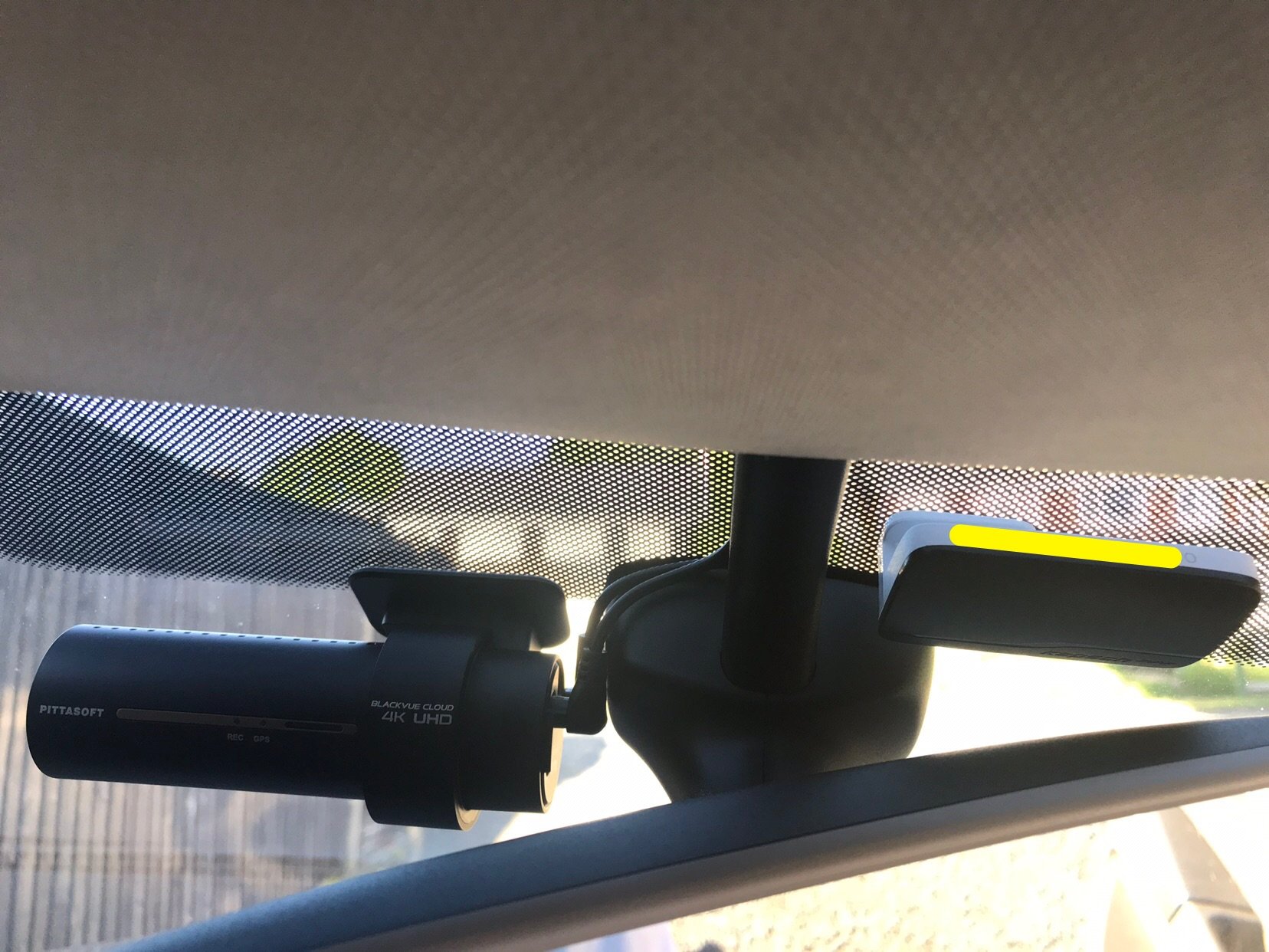

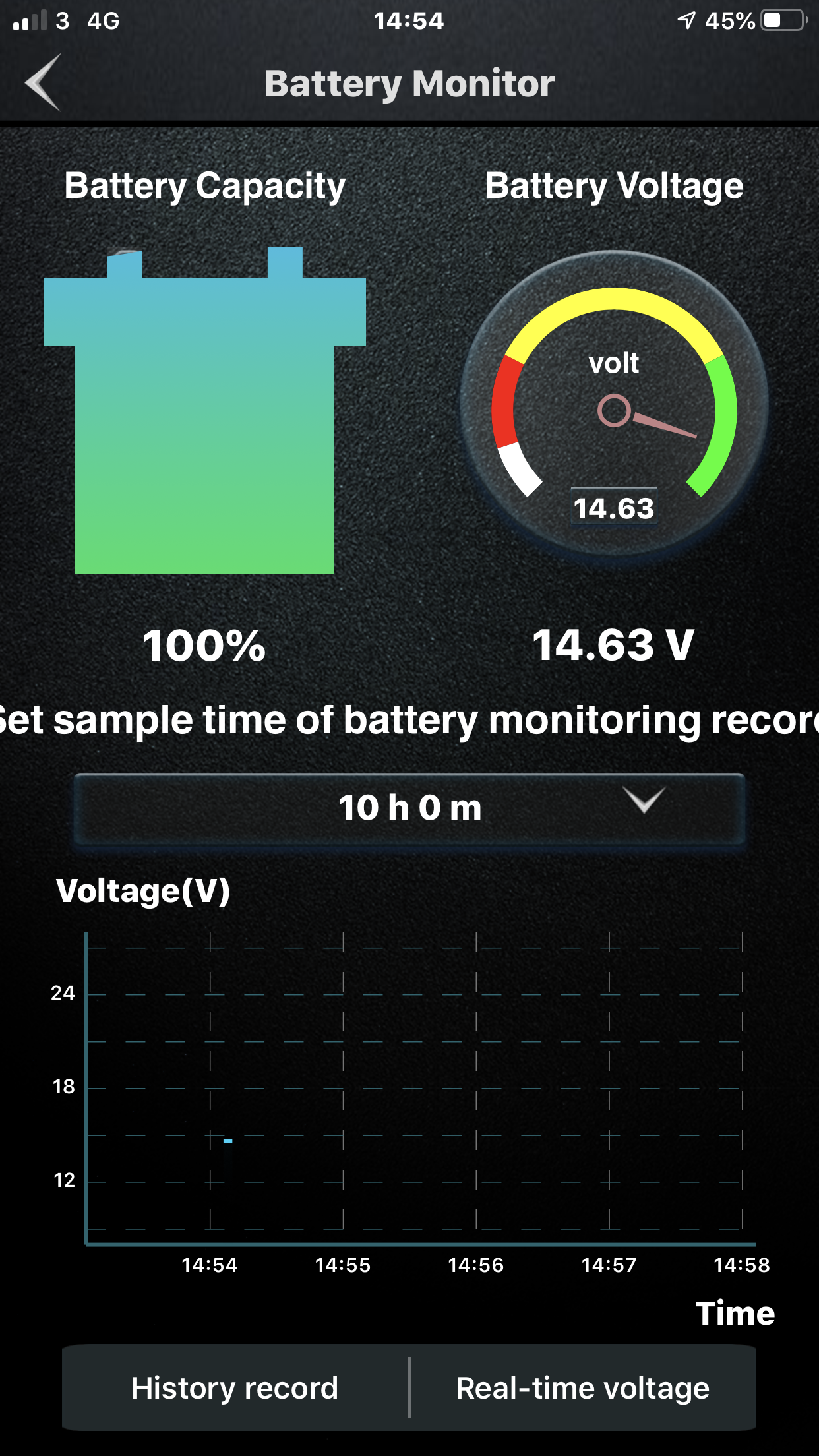

I use a Bluetooth battery monitor on front and rear batteries to keep an eye on them. The EE Wi-fi unit is covered in black tape to the right of the battery monitor as it is bright yellow didn’t want it being obvious.

With the voltage monitor, you know either when to start the car or plug in mains charger. It also has an option to connect a solar panel up to 300W which charges the starter battery after the rear battery if full for proper off grid Aussie style camping.

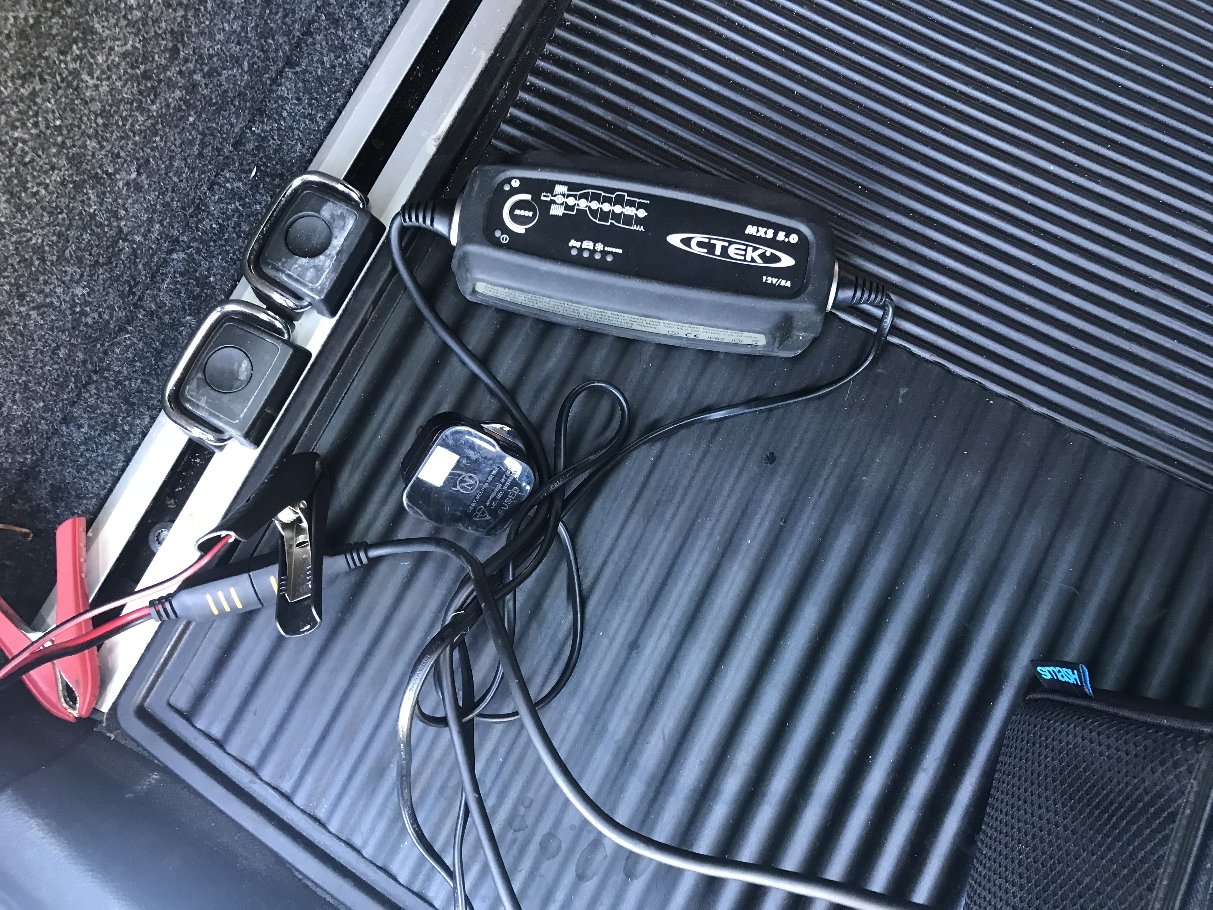

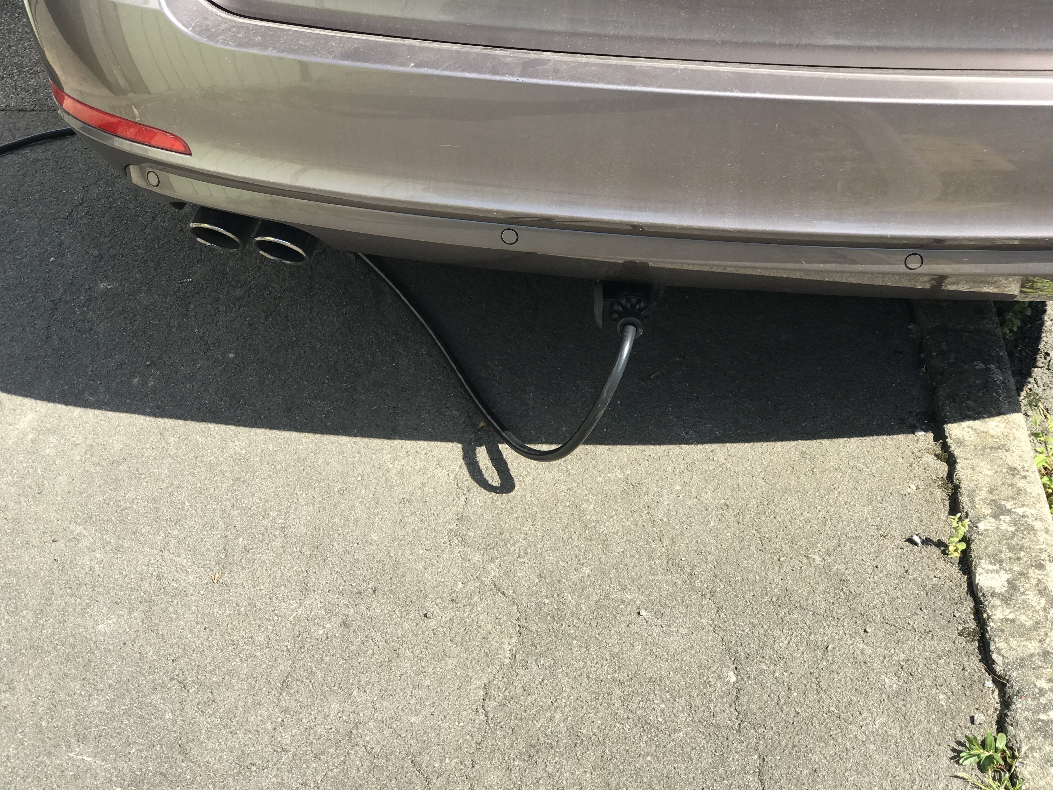

I can now charge both batteries during the lockdown via the 13 pin tow bar plug with the tow ecu coded to 12v at plug socket with ignition off so no need to run the charger lead through the door seal.
I made my own lead with some 13 core cable and a 13 pin plug I had kicking around and used the 12v continuous pin and common earth (not lights or fridge earth) and wired into the Cetek quick release connector.
started off at 5 Amps and dropped to 0.2A after a few days and just keeps both large batteries charged.
As the Cetek DC to DC charger was used to charge the AGM battery in the boot, I set it to start charging when the front battery is above 13V, THEN  the front battery supplies current through the 10mm cables to the DC charger which supplies the rear battery with 14.7V (req for AGM). THE BATTERIES ARE ISOLATED BELOW 13V ( unless you connect the ignition sense wire on the dc charger for stop start equipped vehicles)

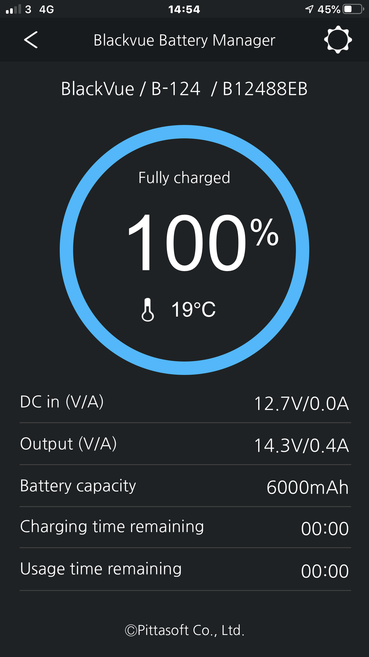

This then in turn keeps the dedicated BlackVue battery under the seat charged and also the Wi-fi hotspot battery fully charged so constant front and rear monitoring while it is stood still via the cloud.
Now if we get a power cut the rear battery keeps the BlackVue battery topped up for 7 days, once the rear battery goes flat the BlackVue battery continues with another 12hrs backup with the little hot spot battery lasting half that so happy with the parking mode setup I have now.
