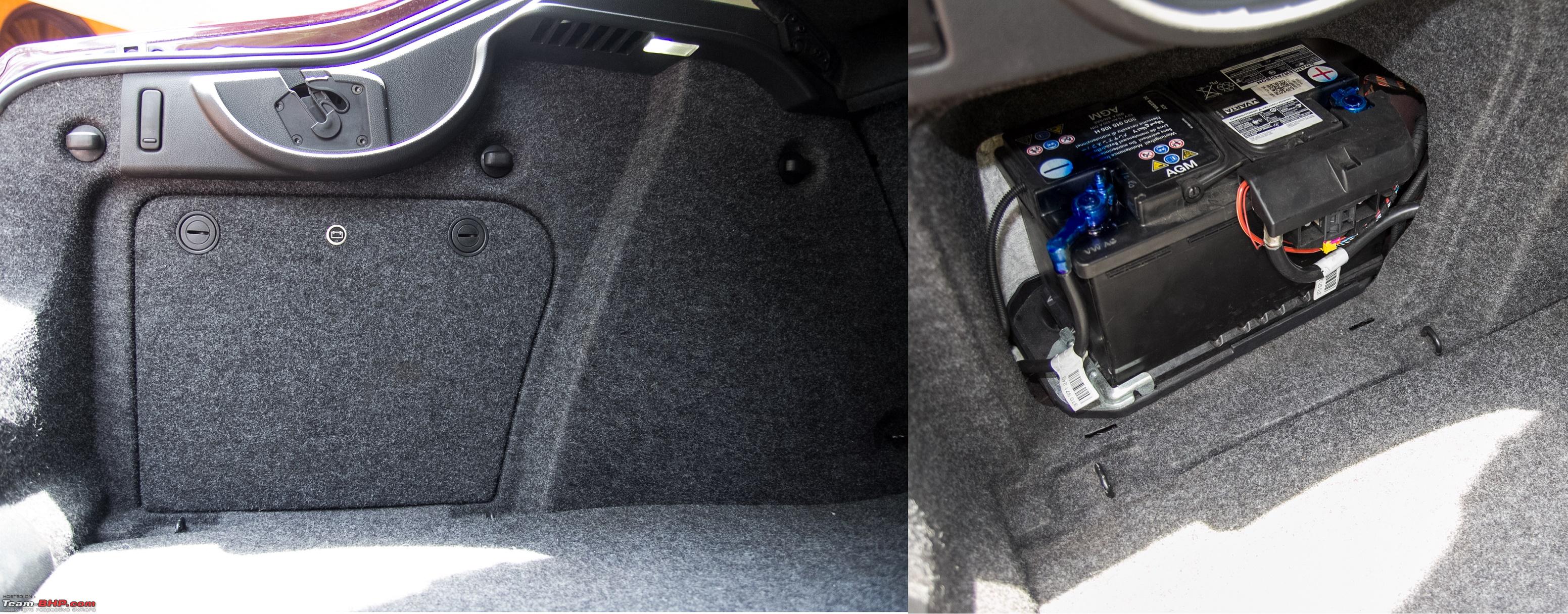

Fitting a rear battery (in boot)
The petrol model has a battery in the boot, with it's own tray and clamp to hold it. And a pipe to vent fumes. I want to fit a battery in the rear of my diesel model (not linked to the main battery/electrical system). Anyone able to tell me anything helpful about it?
- photos from a petrol model?
- part numbers?
- where that vent goes?
- whether the bolt holes are present on all models already? I don't want to drill holes in the car really, so it may kill the idea if the holes aren't already present

I believe only the 3.6l petrol had a rear battery as they ran out of room in the engine bay. Looks like the battery tray part number is 3T0804869/3T0804869A/3T0804869B depending on year.
Here is an image of one fitted I found online:
Still, such a large battery seem very excessive for the amount of power a dashcam will use.
Thanks for that. Can't see where the tube vents to unfortunately.
Looks like the interior panel is different as well, which makes it more of a pain than I had thought.
