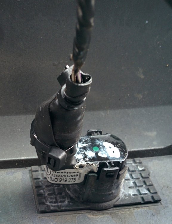

I got a 2nd hand sensor from eBay for about £5 and swapped it over. I had to use touch up paint on the sensor face to match the other colour coded sensors on the bumper. Cleared fault codes and all has been fine since.
While the bumper was off and I had access to all 4 sensors I took the opportunity to wrap self amalgamating tape round all 4 connectors just in case water ingress was a problem.

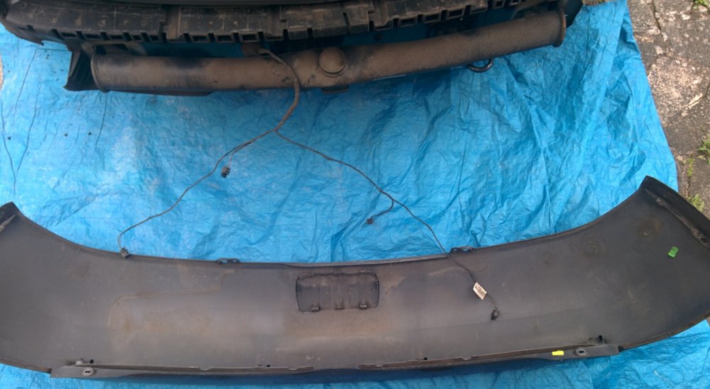

It is actually really easy to remove the rear bumper. 3 torx screws at the rear of each back wheel arch, the same screws that hold the rear mud flaps on if you have them.
1 pop off plastic rivet at the top in each rear wheel arch.
2 torx screws on top of the bumper, exposed when you open the rear hatchback.
2 pop off plastic rivets on the bottom of the bumper at the rear.
Once the above is all removed just gently pull the bumper side away from the car body. Pull from the rear SIDE of the car, not  the back. One person each side and lower to the ground. I put old newspapers or a tarp on the floor to place the bumper onto to avoid scratching it.
The parking sensors just click on and off from the rear of the bumper.

In the past I did have trouble with mine going faulty when wet, so interesting that's the opposite to you, that is why I took the chance to wrap the connections in self amalgamating tape and also secure tight on with a couple of tie wraps.

They were the ones like Item number 202228796329. I brought them back in April as you can see in the post above, fitted all 4 and all worked fine. BUT one has just failed again, I started getting the constant bleep, no fault codes on VCDS but on checking the measuring blocks one of the inside sensors is reading a constant 40cm measurement with nothing behind. The other 3 are detecting correctly, but with one faulty I'm getting a constant tone in reverse.
So I have just brought 4 oem original 5J0 919 275 sensors and 4 x  5J0 919 131 sealing rings from skoda-parts.com. Not cheap all in at 289 EUR.    The constant bleep is driving me mad and I can't be changing these cheap eBay versions every few months.
So I'm fingers crossed that paying out the big money for original parts makes a difference.   I'll let you know in another year.
Edited by aubrey
So today I swapped the parking sensors and it all works again. Interesting those 4 sealing rings 5J0919131. They simply sit on top of the sensor before popping the sensor back into its click in position. I've had this car from new and those were never fitted. They are now and I'm wondering if that was a reason for my historical problems. Time will tell.
But if you ever check/swap your sensors make sure the rings are fitted.
