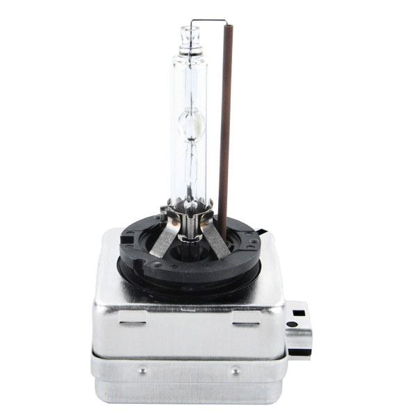

The shutter is part of the projector, not the bulb.

Tell me where the shutter is on a D1S Xenon bulb, why look for H4 HID replacements when he has Bi Xenon?
