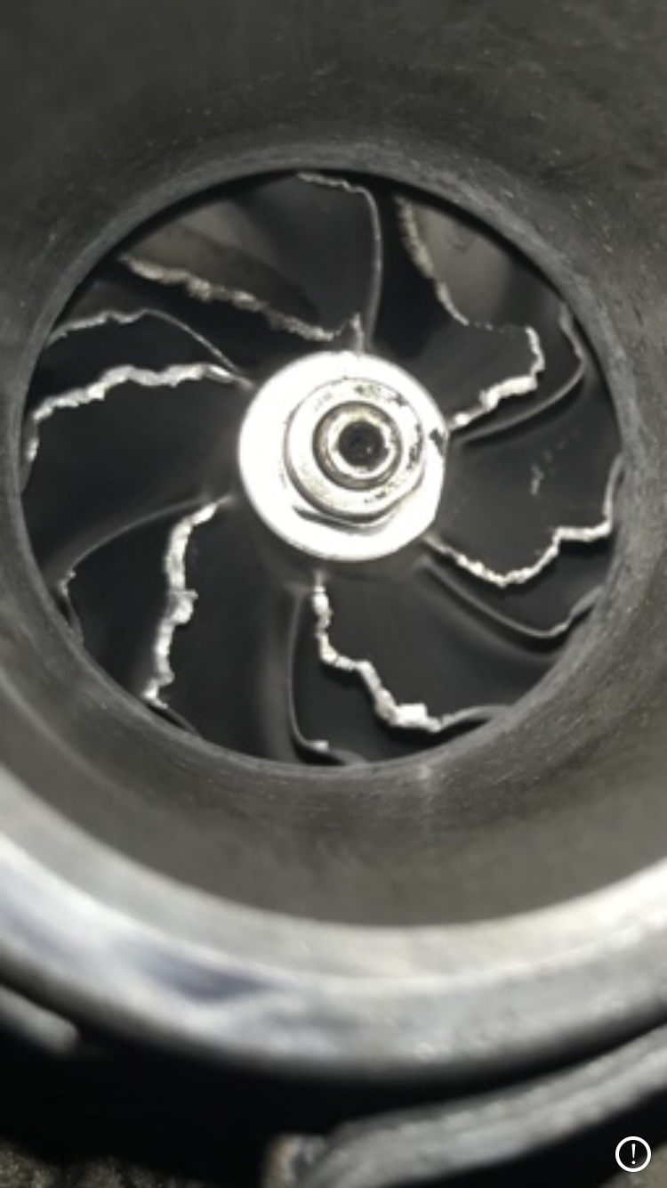

You guessed it...... another turbo, this one was still working .... just! But was going woooooo woooooooo and making very little power. My last CHRA failed at 500ish miles and this one has done the exact same!!! This was the same company sending a CHRA out on warranty. Is this bad CHRA causing the issue? As I’ve ordered a recon Garrett 1749VB which will be here tomorrow and obviously don’t want that to fail!!!! . In terms of the slight damage will I need to remove the FMIC again and flush it out? Or will it be okay as damage is fairly minimal

I can't explain that damage unless the turbo is overspeeding dramatically, the ECU should prevent overspeed (overboost) and flag a fault if it happens unless the map you're running has been programmed to ignore it.
I find it unlikely that you'd get two bad cartridges in a row, I'm starting to suspect a very bad map.
My friends Cartridge from the same company also failed, I’ve kept the car off Boost since it’s been fitted haven’t strained the turbo in the slightest. Not hit the limiter, not abused it full throttle or anything. That’s what I don’t understand, we had issues with the CHRA being difficult to spin once the housings were fitted back together, and took the turbo apart again and kept cleaning and sanding down any pitting marks til it spun freely, however there’s a possibility it contacted for .00000001 of a second causing the damage. What causes impeller damage like this? Seeing as my first tirbo failure did do the same thing, possibly faulty VNT and the impeller making contact with the VNT system?
VNT is on the hot side, we're looking at the cold side here so VNT not a factor. I'm obviously concerned that you had issues with impeller clearance, that suggests that it may have been damaged during assembly, the impeller is incredibly fragile and any contact would distort it causing it to run out of balance.

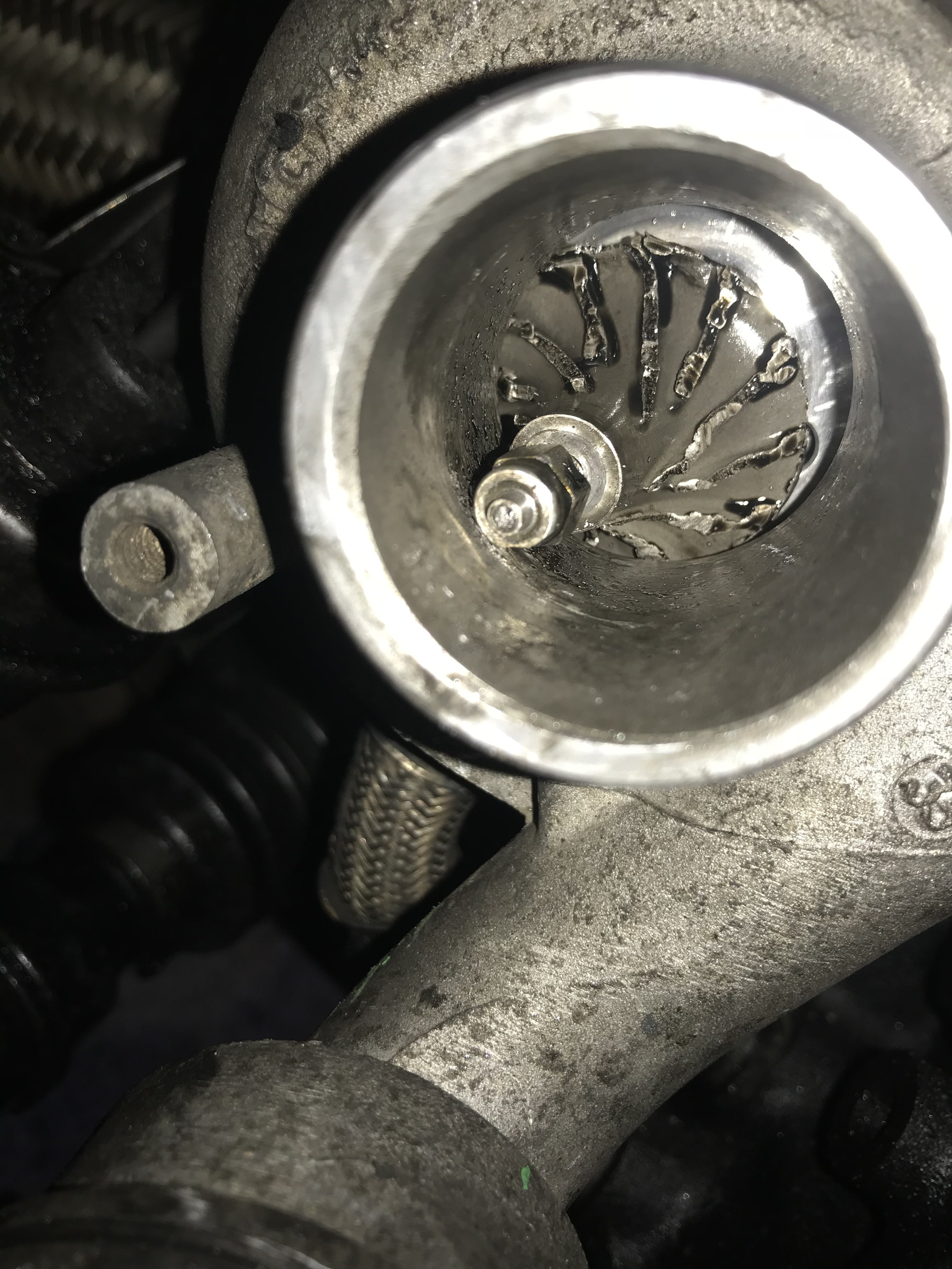

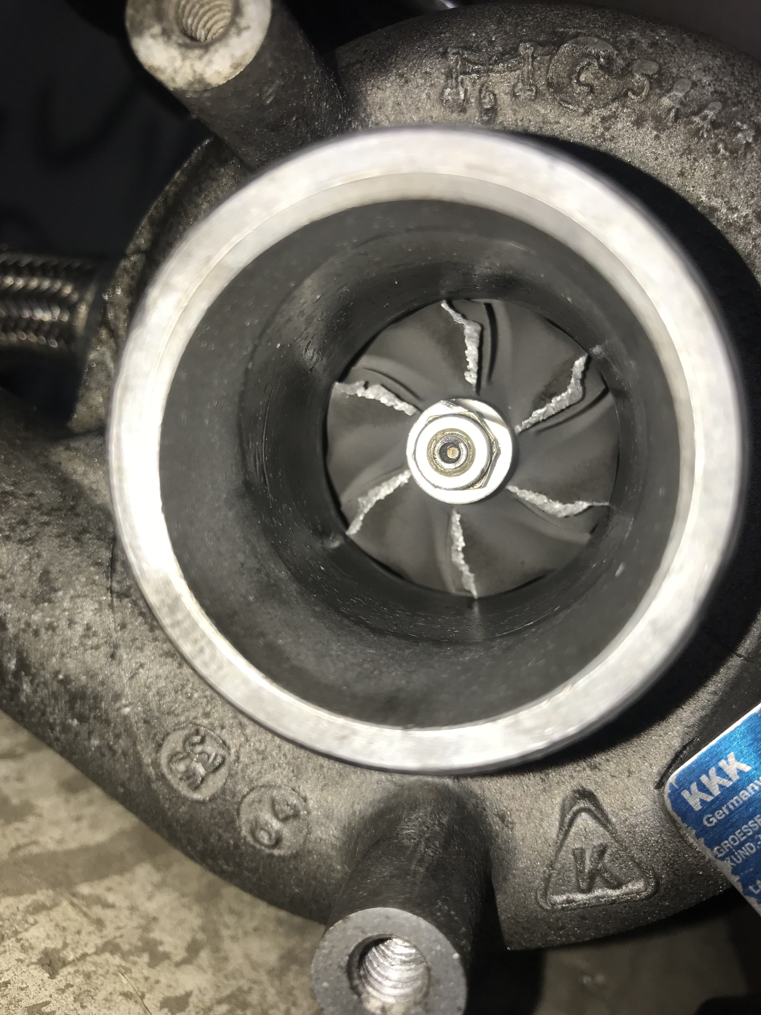

What is th actual cause of overspin i know Boost leak is a factor however I know for a fact I haven’t got a Boost leak as that’s been pressure (30psi) and smoke tested with no leaks, so what else would be causing it? Is that why my original turbo failed? I’m going to link the photos of all 3 failed turbos the order they are posted in is
CHRA Replacement,
CHRA Replacement 2
Original

Obviously this is all the same actual turbo as original, just the CHRA that was changed, is it possible it’s the VNT causing the issue? Say for example it’s sticking and causing overboost, as all 3 failed in the same core with the same impeller damage, the snapped shaft on the second turbo is that down to over speed?
