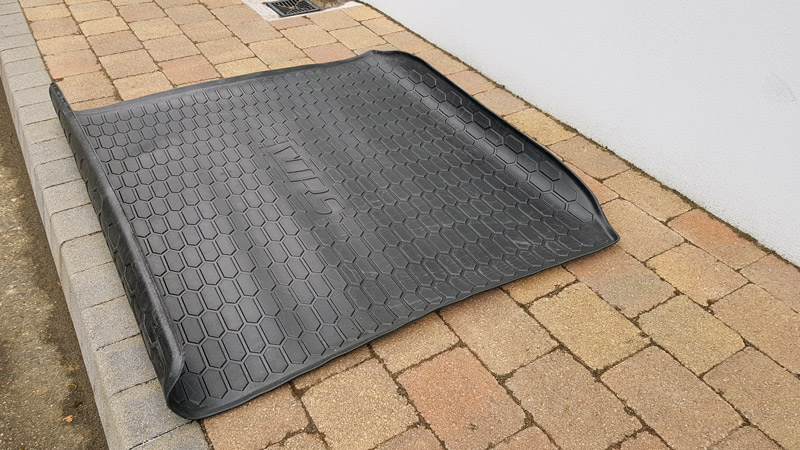

Hi all,
my rubber boot mat (has vrs logo) that I bought from superskoda for my VRS estate is being a pain, it came rolled up and it’s still curling up at the ends when fitted.
Did anyone else’s do this and how did you manage to stop it? I’m thinking I’ll just leave it out in the sun when we have a nice warm day?

I’ve tried rolling it back, placing weights on it, folding the edge the opposite way etc, the bugger still springs back up at the end as it was very tightly rolled in its packaging.
The sun is out today I’ll leave it out to soften and relax the rubber.

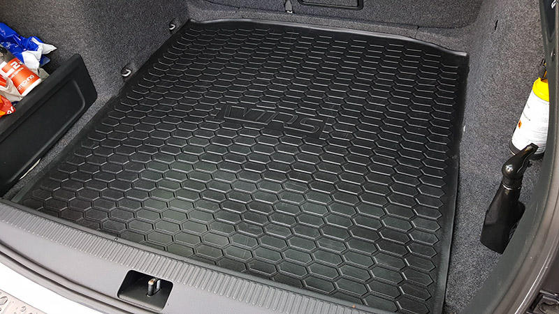

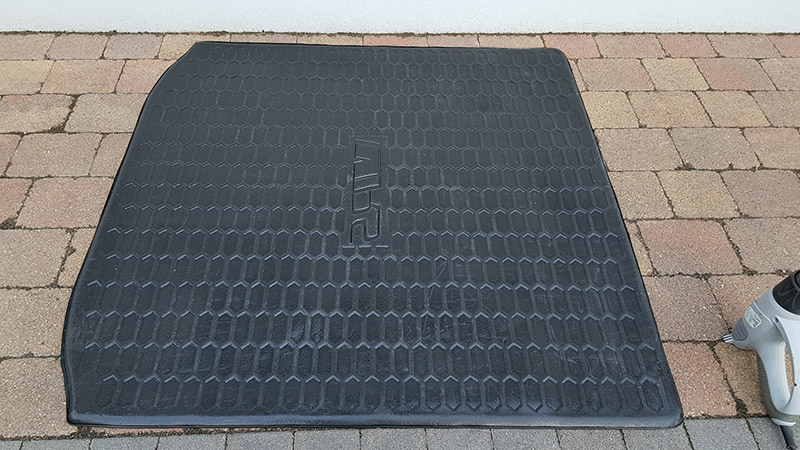

sorted!

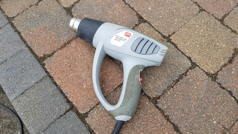

15 mins with a heat gun. turn the mat upside down and heat it till you visibly see it flatten out. The rubber/plastic seems to have some kid of heat memory.
Nice one!  That looks to have worked a treat!
