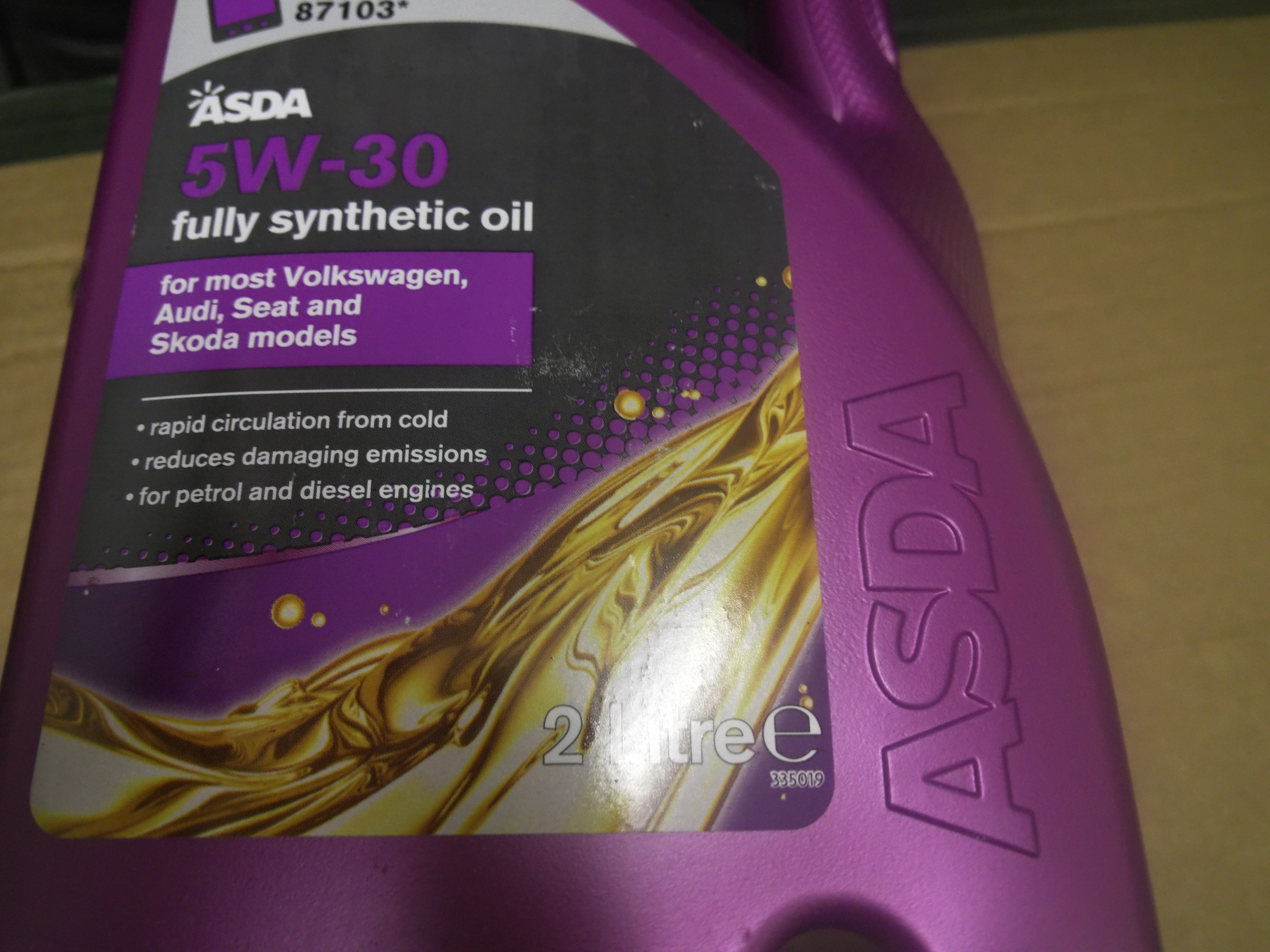

Offski, i noted your comment regarding the Asda oil, to be honest I didn't even know that they sell their own brand of engine oil. It's probably produced for them by the big oil giant anyway. Just noted on their website that 5w40 which is on offer for £14 for a 5L and it states that Meets or exceeds the requirements of the following specifications: API SN/CF, ACEA C3, MB229.31/229.51, BMW LL-04, VW502.00/505.01 PORSCHE A40, FORD WSS-M2C917.
Would this be fine for a 1.2tsi Fabia of mine on fixed service then, which will get changed from variable due to my low milage and currently uses long life 5w30 507.00.
Many thanks

Just check that it's FULLY SYNTHETIC OIL, and not semi-synthetic as you can often find it in both oil types. Semi goes out of spec much more quickly than fully syn. Check your owners manual under topping up your oil where it tells you what spec to use. This is on page 153. It says to use VW502 on fixed service intervals.

They have 2 and 4 litres of VW 504 if you want Long Life oil & VW 502 in Full Synthetic at good enough prices usually,
and then some days they must be having to undercut Tesco, Morrison, Sainsbury etc and there are very good price drops,
so anytime i am in shopping i pass the oil and if much cheapness buy up a selection.
Cheaper than at Motor Factors and as good as the COMMA Premium oil i used to buy, but then that is maybe not a coincidence.
ASDA or Tesco.

Thanks for your reply. So do you think that supermarket oils are safe to use /equally as good as the premium brands like Shell, Castrol etc. To use in my Fabia. Is there any harm using a long life 507.00 for 12 months fixed servicing instead of flexi service, bit confused as I keep hearing that dealers still use longlife oil on fixed servicing.
Just out of interest who makes supermarket oils?
Many thanks
You certainly hope there is no harm in the Long Life oils VW the 2nd Biggest Car Manufacturer in the world recommends.
When would they ever have anything but the customers best interest at heart.....  Honesty being their byword.
Do you think Wallmart / ASDA are going to sell utter rubbish?
Oil Producers make Supermarket Oil, not baked bean manufacturers.
Like Fuel Producers produce / supply fuels for Super Market Filling Stations and others.
http://greenergy.com/uk/independent
Not sure what is 'Premium' about Castrol or Shell, or Quantum that VW Group Main Dealers might be using for your VW 504 / 507 oil changes.
You decide yourself if Castrol, Shell, Mobile, Total, Fuchs is what you want.
Personally if i was buying Manufacturers Recommended Oil it would be Japanese Car Manufacturers Oils i would buy, seeing as the have the more reliable longer lasting engines...

The main reason supermarket oils are cheaper is due to...1: it's a cheap oil containing the bare minimum of additives to allow it to meet the lowest/minimum specification laid down by the world's SAE & JASO organisations. It also uses lower quality detergents in many brands over what the more expensive oils frequently use. 2: it often contains more recycled oil which is cheaper to produce and put back in the market place. 3: Supermarkets buy in bulk even though they actually don't sell that much of it. Make no mistake, it's good oil but if you use it be sure to adhere to oil change intervals religiously as it can go out of spec early compared to bigger more expensive  branded oils. Around 8 years ago the company I worked for tested almost every oil on the market in the UK in the lab and in our engines. Quite a difference in the way they performed and how much engine wear took place with some brands. Mostly, the more expensive brands were head and shoulders better than the cheap oils. You actually get what you pay for. By the way, VW's Quantum brand was very near the top of the best performing brands even though it's not that expensive.
