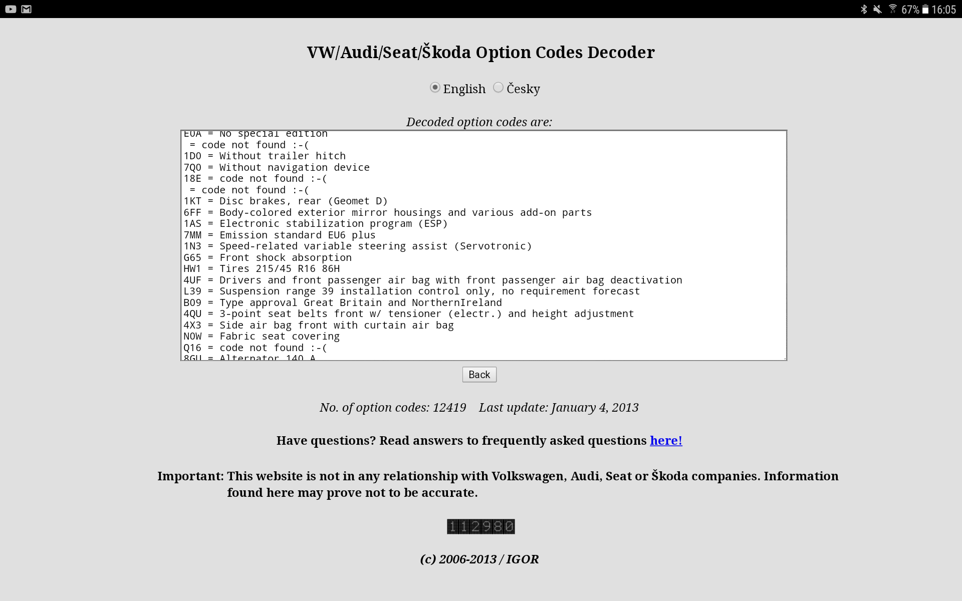

My boot sticker is lots of letters and numbers. How can you tell if it's a fixed or variable service from looking at it please?
http://igorweb.org/equidec.aspx
Lots of information for me there,thanks,but nothing about service intervals
I think it's a QG1 or QG2 code. I'm sure it tells you in the manual.

I put a couple of numbers in wrong.
QI6 = Service indicator 30,000 km or 2 year ( variable )
I8E = Standard radio (Gen2)
Dealer must have changed it to fixed service.
