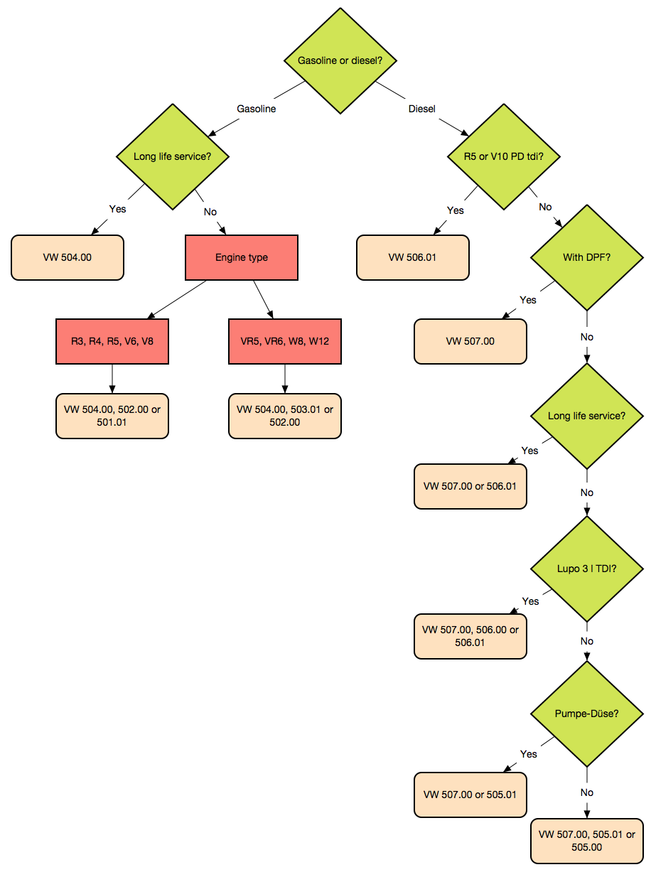

Does anyone actually know which regime is better for the engine as they use different oil?
http://volkswagen.co.uk/owners/servicing/regimes
VW Group Main Dealers do not use different oils for Fixed or Variable Servicing.
They use VW504 / 507 Full Synthetic Long Life if doing fixed or flexible / variable servicing.
 (VW 502 00 can be used on a TSI for Fixed Servicing.)
VW 504 & 507  is 5w 30 FS LL
VW 502 00 is 5w 40 FS mainly,  but others are available.       From Asda 5w 40 FS to VW502 00 is perfectly good, proper oil....
Now on new Euro 6.5 VW Group cars they will be going to VW508 / 509 for the Real World Tested cars.  0w 20 FS Long Life.
Expensive stuff,  to get VW Group low emissions and acceptable fuel consumption test results...
Edited by Offski

Your old Polo did not self medicate, you or a technician added the oil.
You could have used the Long Life oil if you chose to,  but not all VW Group engines had a Variable Servicing code before 2011.
(UpMiiCitigo might still not have a Flexible Servicing code now.
(Diesel engines being different, they need what they need, type, DPF etc.)
 But no need to use 'Long Life' oil when you do Fixed 9,400 mile / 372 day or less oil and filter changes.
VW502 00 spec is fine with a TSI,  even preferable.  In some peoples opinion / experience.
If you love your engine and that turbo maybe give it a treat and forget Long Life oil,  the recommended choice of Manufacturers for FLEET / LEASE & their profits.
Edited by Offski
So basically, no-one other than the manufacturer knows?
Many people know.
Main Dealership Service Desk staff maybe not,  and the manufacturers are not that helpful in helping owners to know.
This was handy for older engines as there were Typos in Owners Manuals on oil capacity.
