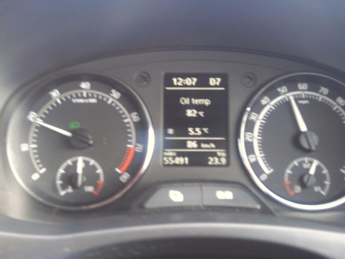

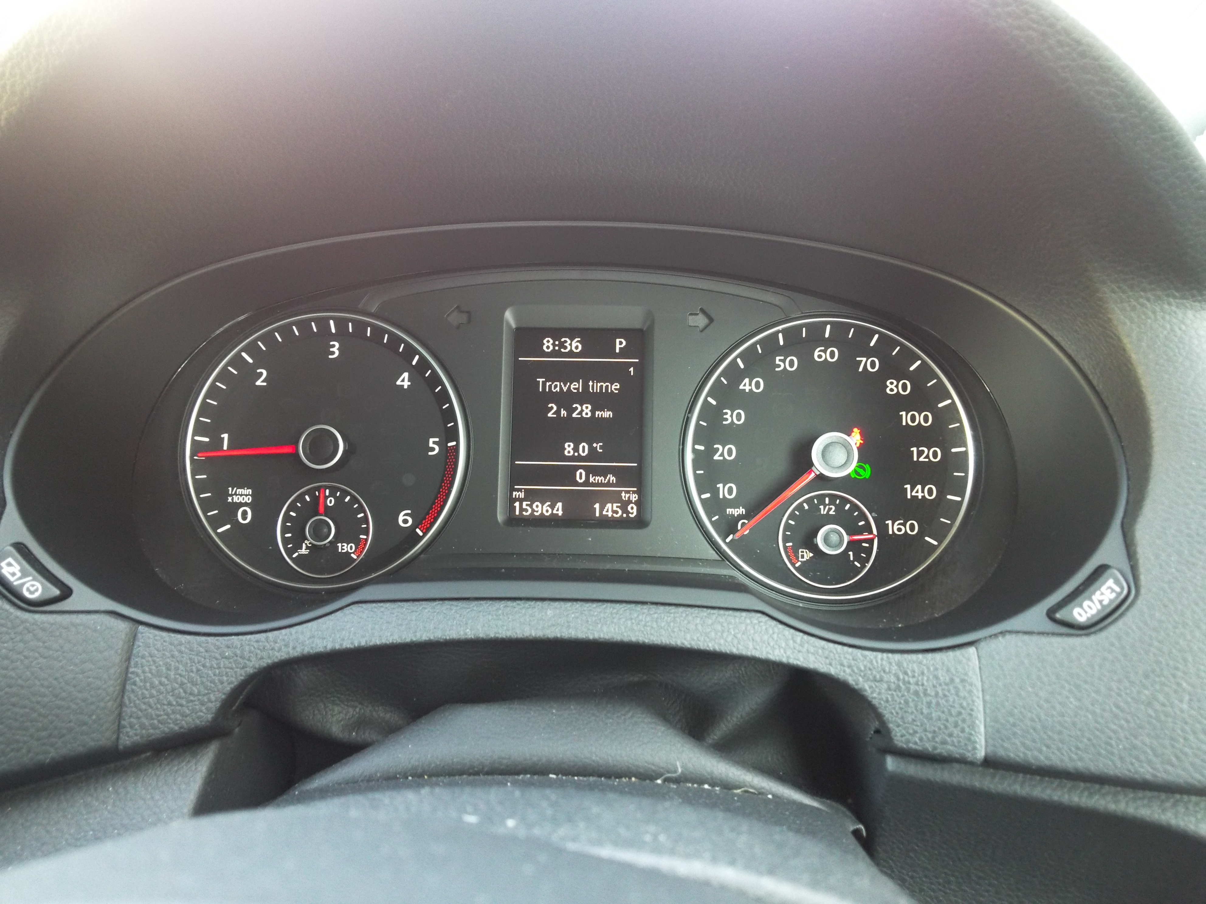

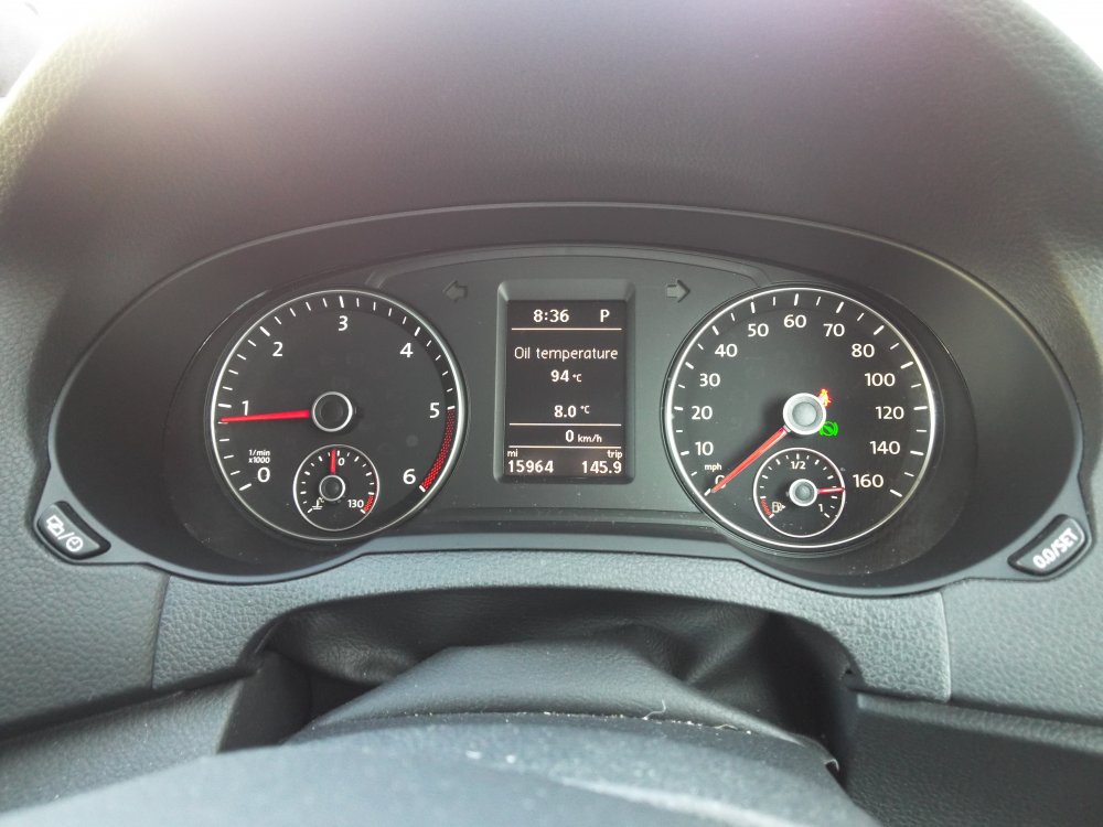

Top 2 pics.
This was a couple of days ago in a 2.0TDI.
146 miles in 2 1/2 hours, and the Oil Temp.
Same Journey in a petrol car and the Oil temp shows 90*oC in this sort of ambient temp.

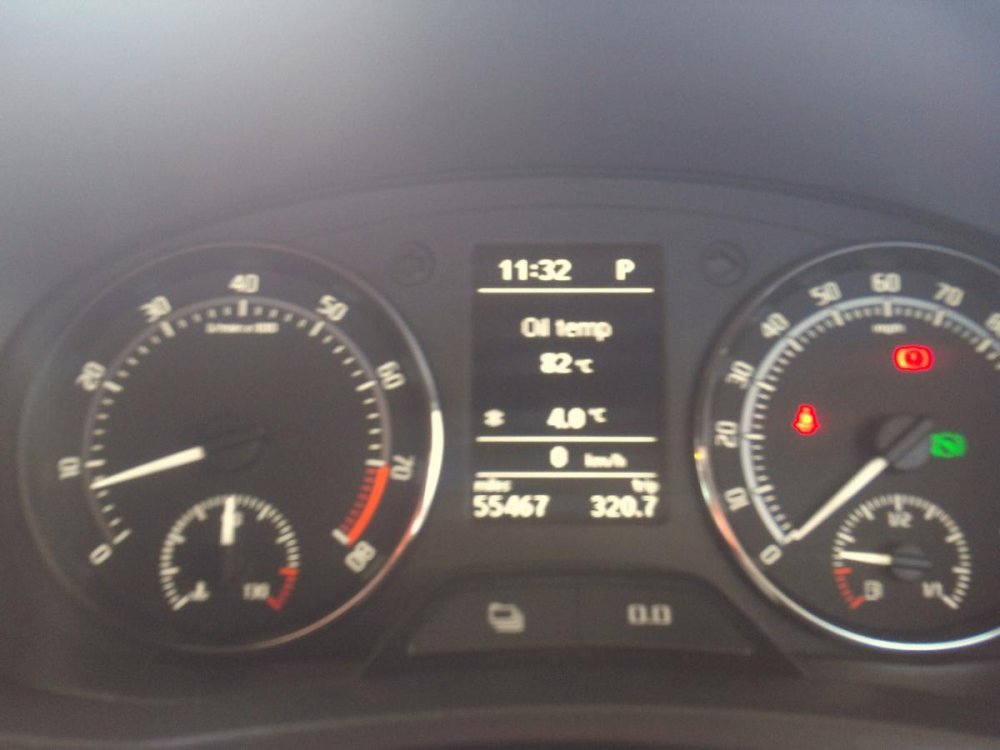

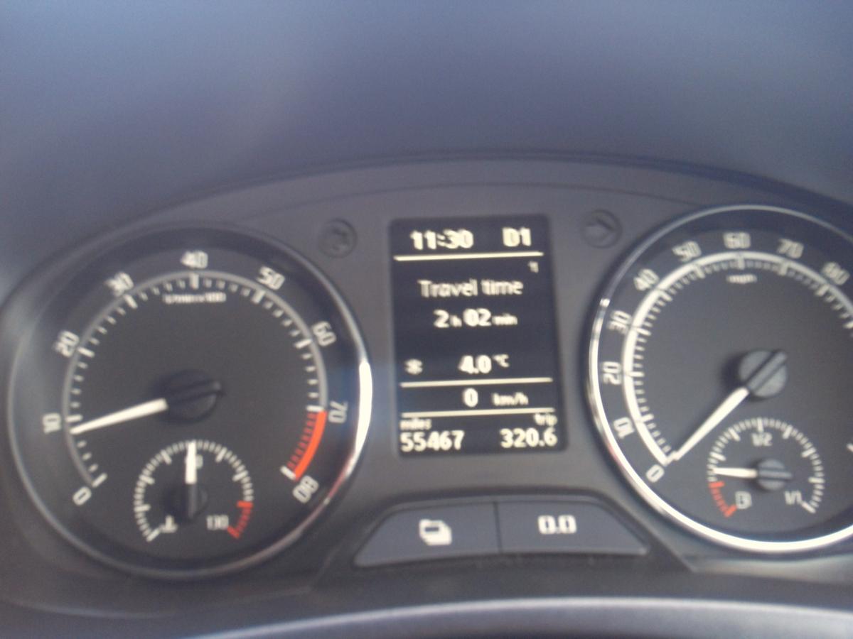

Bottom 3 pics.,
Stopped after 2 hours for fuel, and 82*oC Oil indicated.
a 1.4TSI Cool Running.
Good oil & not Long Life Oil & Super Unleaded.
