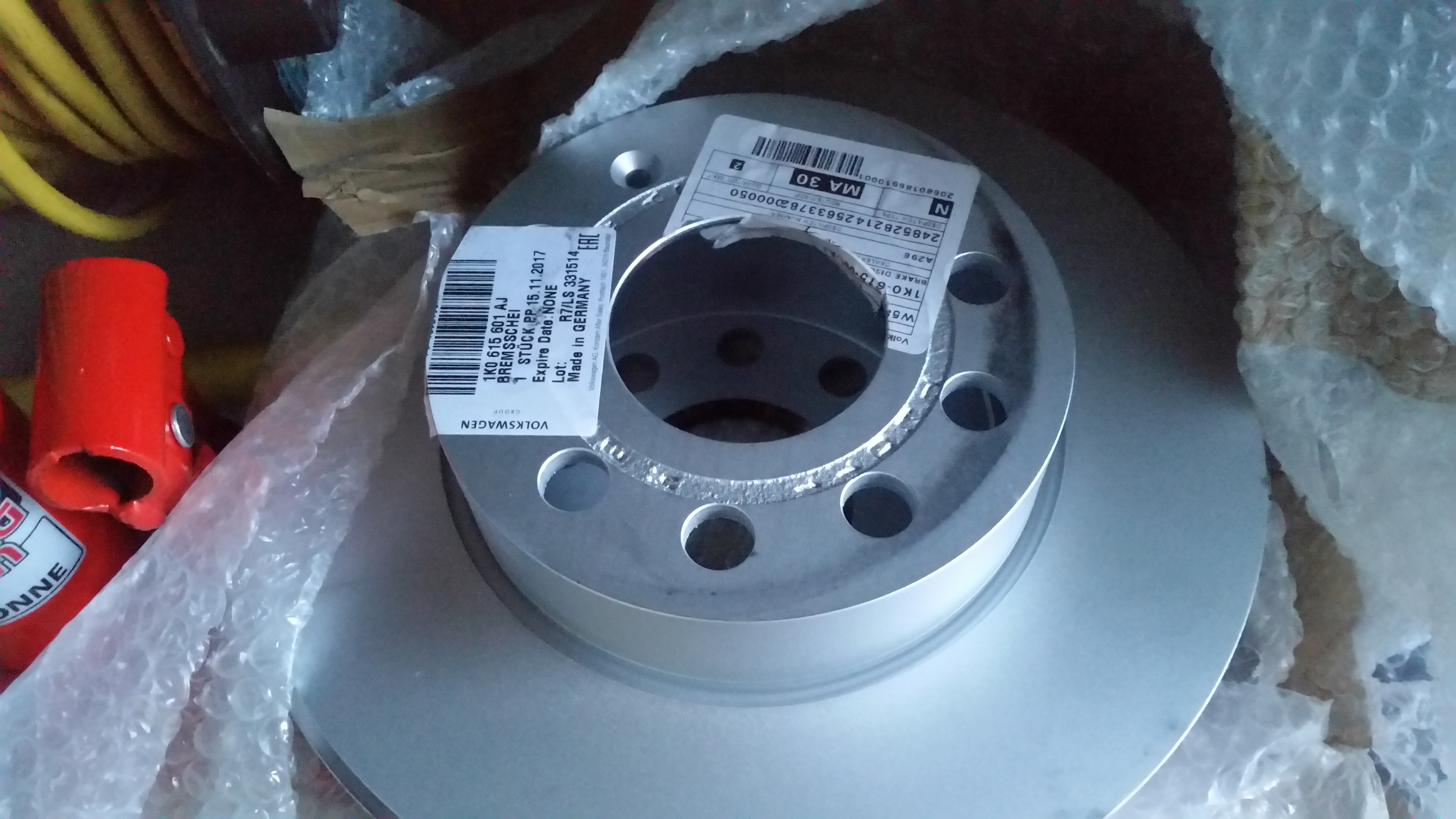

Today I started the job of fitting new rear discs and pads to my Octiavia Scout.
I have the replacement discs which have a part number of 1K0 615 601 AJ
First question is - are these the correct discs for my car?

I've measured the new discs - they are 256mm diameter.
The old disc diameter seems to be 262mm which seems a lot even with the build up of rust on the disc edge.

seems like you have the wrong size discs as judging by your old ones you should be fitting 260mm ones

So does seem like the dealer gave me the wrong discs.

Given that the discs I have are 256mm, then it doesn't look like there's a reason not to fit them but I'll wait and see what the dealer says.
Looks like they should have supplied 1K0 615 601 AC and if I search for 1K0 615 601 AJ on their site, it matches nothing.
The suffix J is just a revision and supercedes the C model, nothing to worry about.
1KF fitment discs are/were originally 260mm dia, 12mm thick.
I suspect manufacturers are saving a small amount of money by shaving the excess diameter down which in use is unswept and just ends up a rough and rusty mess.
