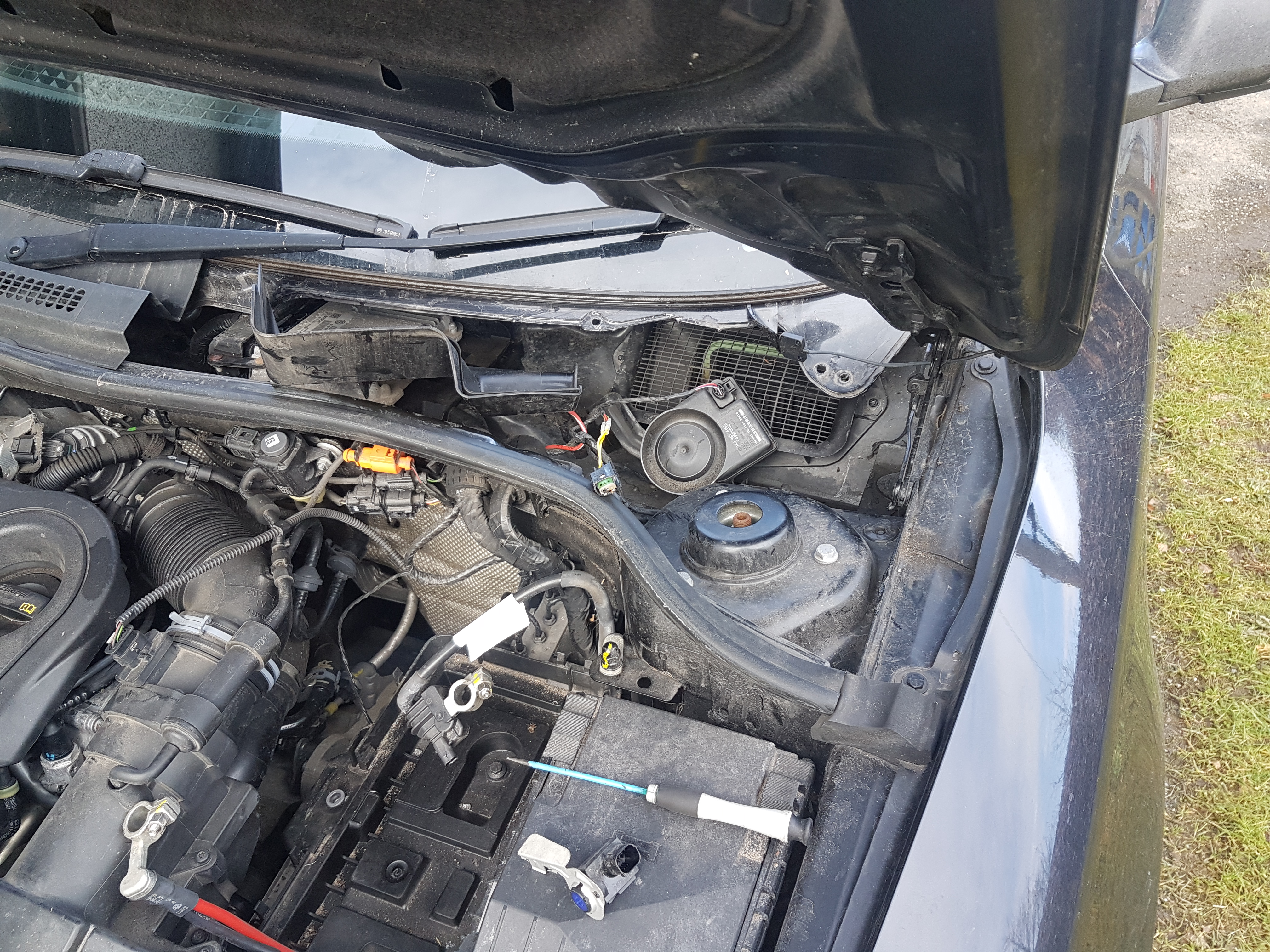

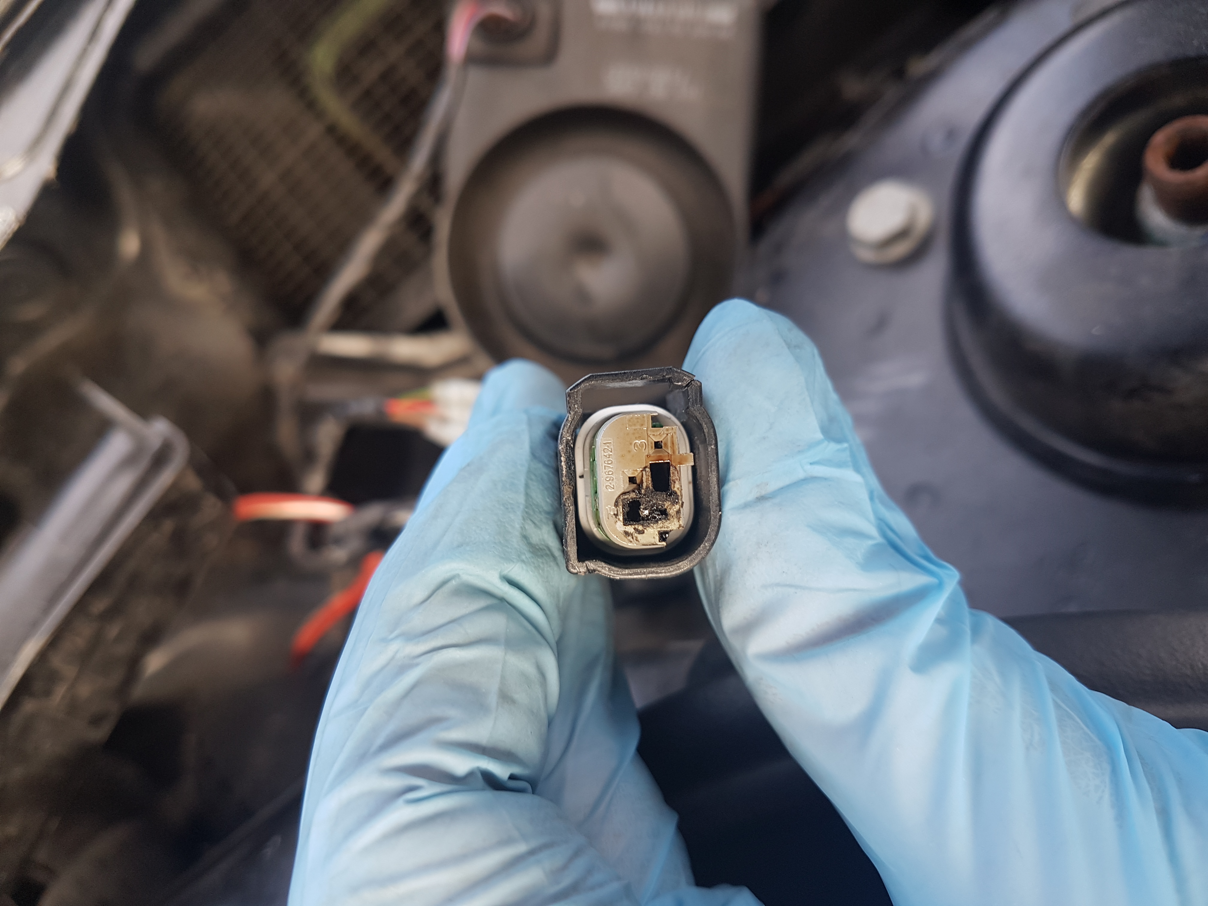

you may have the same fault I have  with my car.   - first have you check your oil level is it correct ?  have you noticed a electrical burning smell at any time as a once off ?  is your oil temp reading digital readout not working also ? if you answer yes to all these you have a burned out air sensor that uses the same fuse as the oil sensor - mine has melted 3 times and gives out an  orange oil warning fault.  took 2 dealers and a independent to identify it and  fix it - but only lasted a year.  will be repairing it my self in the next week .... the only worry is if the wires have melted together in the harness as it gos from back off the engine to the front of the car then back through the dash and along to drivers side fuse box ... so there a lot of wire ...... also you will prob find the 5amp fuse blown.

The air quality sensor is under windscreen passenger side under two lots of plastic trim. You will prob find the connector on the wiring  harness is melted also. And will need to be replaced. You can get all bits off ebay. The sensor is 58 quid. Replacement wires you need qty 3 and the connector with 3 butt connectors so around 20 quid. I'm away form home at moment but if you need I can get you part numbers next Thursday. The 5 amp fuse is in the fuse box drivers side cabin top row from memory
