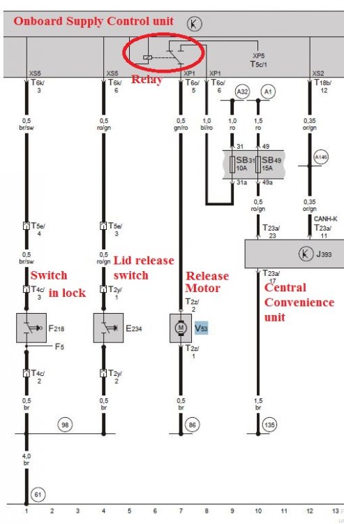

This is what the circuit looks like, V53 being the motor that you are calling the solenoid.
Check that the red/green wire coming from E234 to the Onboard supply control unit is going to 0V when the switch is pressed, and if that is happening, check for voltage on the green/red wire coming to V53 while the switch is pressed.
I'm not sure what impact the other switch - F218, inside the rear lock, would have if it is broken.
All the brown wires at the bottom of the diagram are earths, or should be. Check that they really do connect to chassis.
Edited by Wino
Great data there Wino! Can you find on the schematic which voltage should be passing throw the exterior switch by the license plate. Because weird for me t being only 1V to 0V when pressed.
