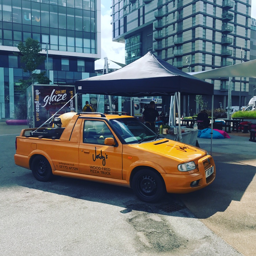

Picture is of the Fun in question. I have 2 (one yellow, one orange) and use them for my mobile catering business. Never let me down... until now.
