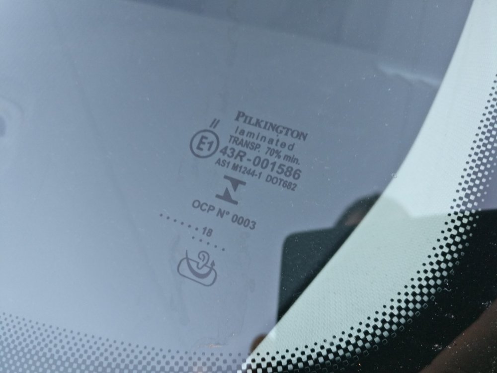

Do the genuine screens have Skoda logo printed on them?
My insurance policy (Swiftcover) says "We may choose to repair your car with parts that may not have been made by its manufacturer but are of a similar standard."  Which is fine to use 3rd-party parts, but it's clear (to me anyway) that this glass is not of a similar standard.

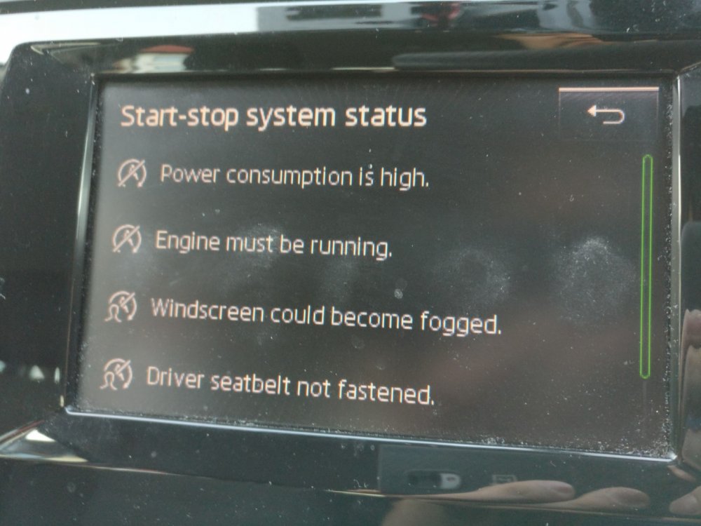

I've unticked the "Automatic windscreen heating" option in the AC setup menu, and it has now turned off, but anytime I have the AC on, I get the Start-stop system status: "Windscreen could become fogged".  I think this clearly points to a missing / disconnected temperature sensor in the new windscreen.
Attached picture of the logo from the new windscreen & the Start-stop status (sorry for dirty screen!)

An OEM screen always has a Skoda logo on it, however, these are often made by Pilkington so a Pilkinton screen should be of the right quality.  Autoglass often fit Shatterpruf windscreens and these are an inferior pattern screen.
