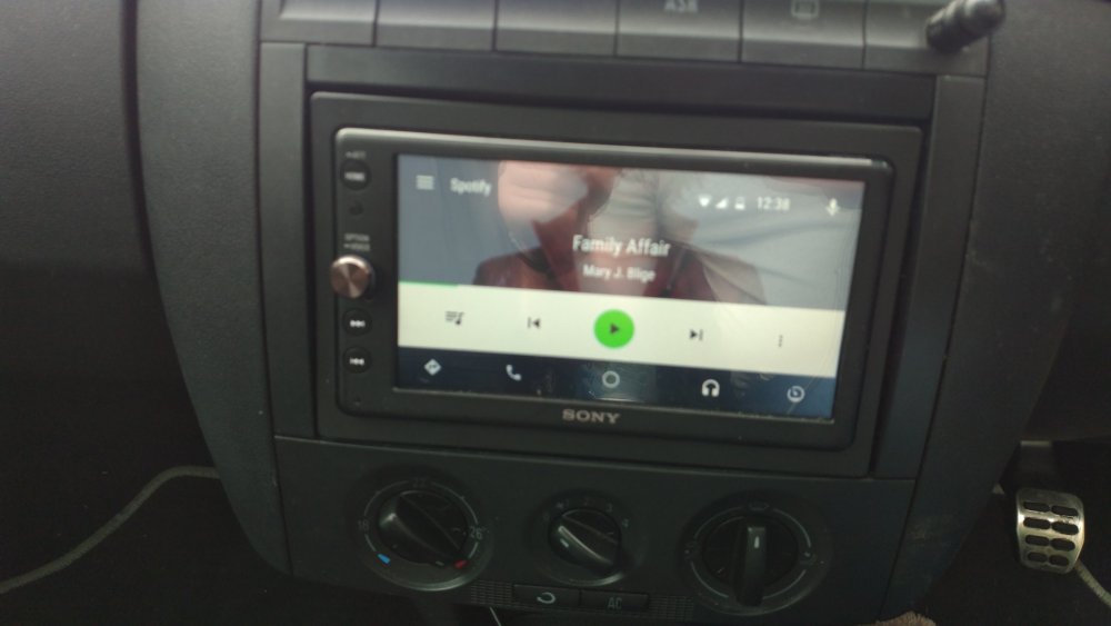

Hi, I've recently purchased a 1.9L MK1 Fabia. I was wondering if anyone has fitted their own radio into one? I've been looking on ebay and found quite a few but they all say they're for the MK2 Fabia. I want a touchscreen Sat-Nav with radio and bluetooth/ Apple play so I can stream my music through it.
Any help would be amazing!
You can fit a full size double-din unit in it, it's simple to do, just remove the existing radio and the drawer or try under it and hey presto! A double-din sized hole for your fragile ego.
1 hour ago, Yaris said:
That would be great thanks! I didn't want to buy one and find it doesn't fit :laugh:
The unit also has a cable for music transfer. Much better quality than bluetooth.
You'll also need Radio Facia Adaptor (6Y0857231B41) which is £5 posted from skodaparts.co.uk
Edited by Yaris
Thanks ordered mine today should be turning up tomorrow! I’ll let you know how the install goes!
Easiest install ever.

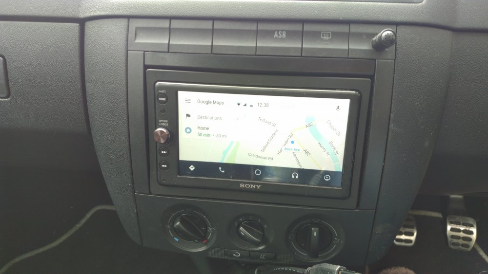

Having just fitted a similar unit to my Bora (not my fab) I found a problem with google maps. To work well it needs a phone or wifi connection. It does have an offline mode where you can download maps to use but they only last for a month and are of limited area. Ongoing hassle or always link the phone. Silly having to link the phone when it has google maps on it anyway and one intention of fitting the head unit was to have a standalone device that did radio, front and rear cameras, satnav, DVD player, reversing camera and any other apps I might want.  I couldn't get it to work well and ended up downloading sygic which is free and so far working well.

4) Can it play radio and use google maps simultaneously?
edit2:
found a manual online and looked on the sony website and youtube review of the unit, answer to question 3 is it does support a reversing camera

No DAB option
Cable has female USB ending, to which you connect the appropriate adapter. Easy to swap between USB C for me and Micro USB for the Mrs
Radio will still play when you swap to GPS
Edited by Yaris
45 minutes ago, Yaris said:
No DAB option
That sounds pretty ideal
Thank you very much sir!
I presume the USB connector would just slot out under the trim near the ash tray (money holder in my case) and the other little storage area then
It's a good length so wherever you like.
