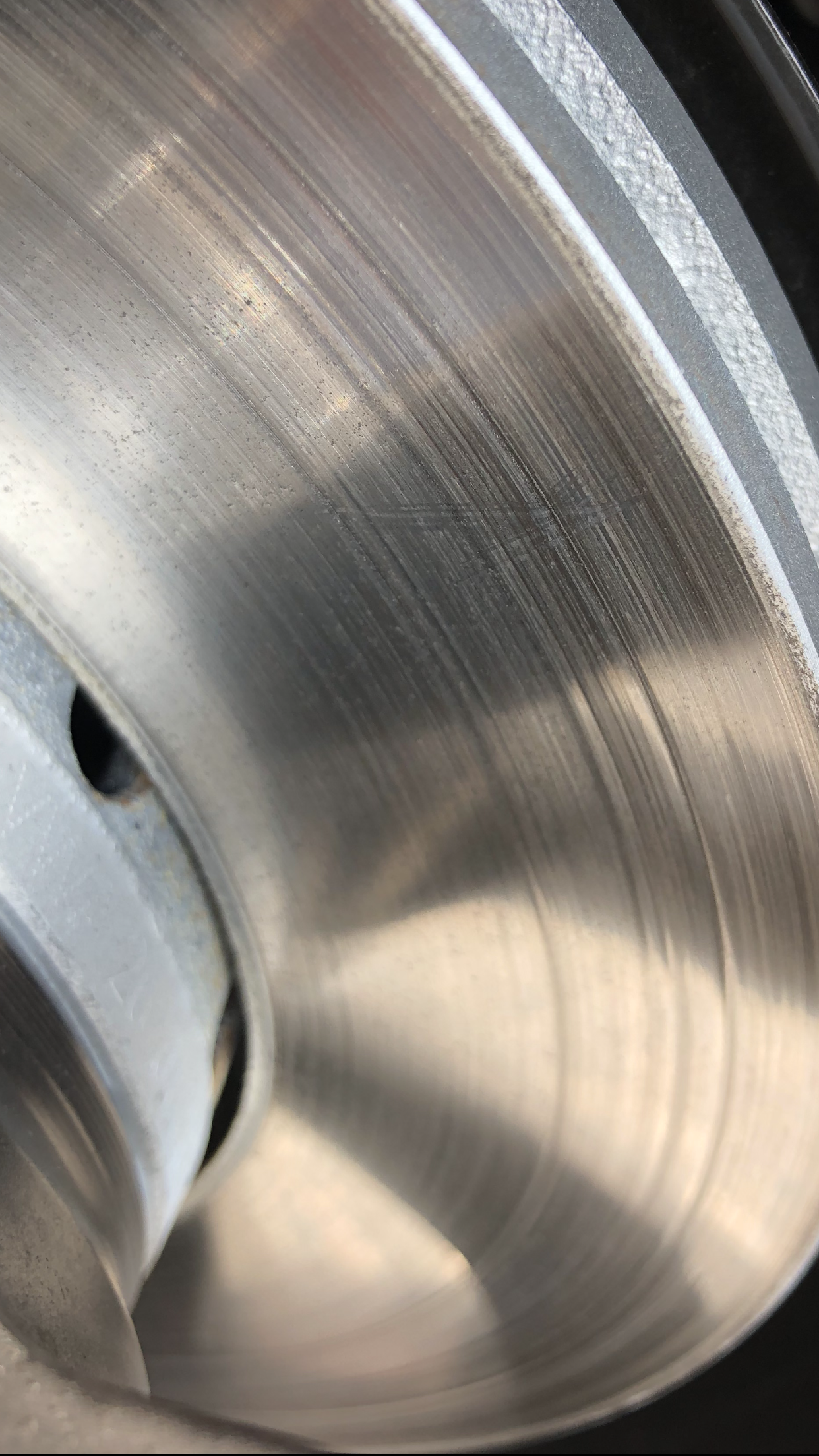

I have discs all round now and find the brakes shocking if I’m honest. The brake pad material is harder than the discs as the picture of my 300 mile old disc shows with the ridge rings wearing on the disc. I will mention this to dealer on passing as I know shouldn’t be like that after 300 miles. On a plus note it doesn’t squeak at the moment:blink:.
The brakes don’t inspire me with confidence if I’m honest.:sadsmile:
I just changed my Roomster 1.9's front discs after 60,000 miles and they looked similar. No way after 300 miles should the disc be marked at all.

Are you 100% sure those discs have only been on for 300 miles ? The pads look new but I don't see how the discs can get that worn with a ridge rim at the edge that quick.
The discs look like they need renewing now.
It looks awful from the pics after only 300 miles. I would guess though it's not a 'rim' but more of a difference in colour as the pads don't operate on the very outer edge. Personally I wouldn't be worrying about a bit of scoring on the new discs. Any crud that gets onto the pad will mark. In my view it's normal.

I've got a squeak on my o/s front brake on my fabia its only got 300 miles on the clock had a look at it looks all good no mark on disc will give it to 500 miles then if it's still doing it will take it to dealer

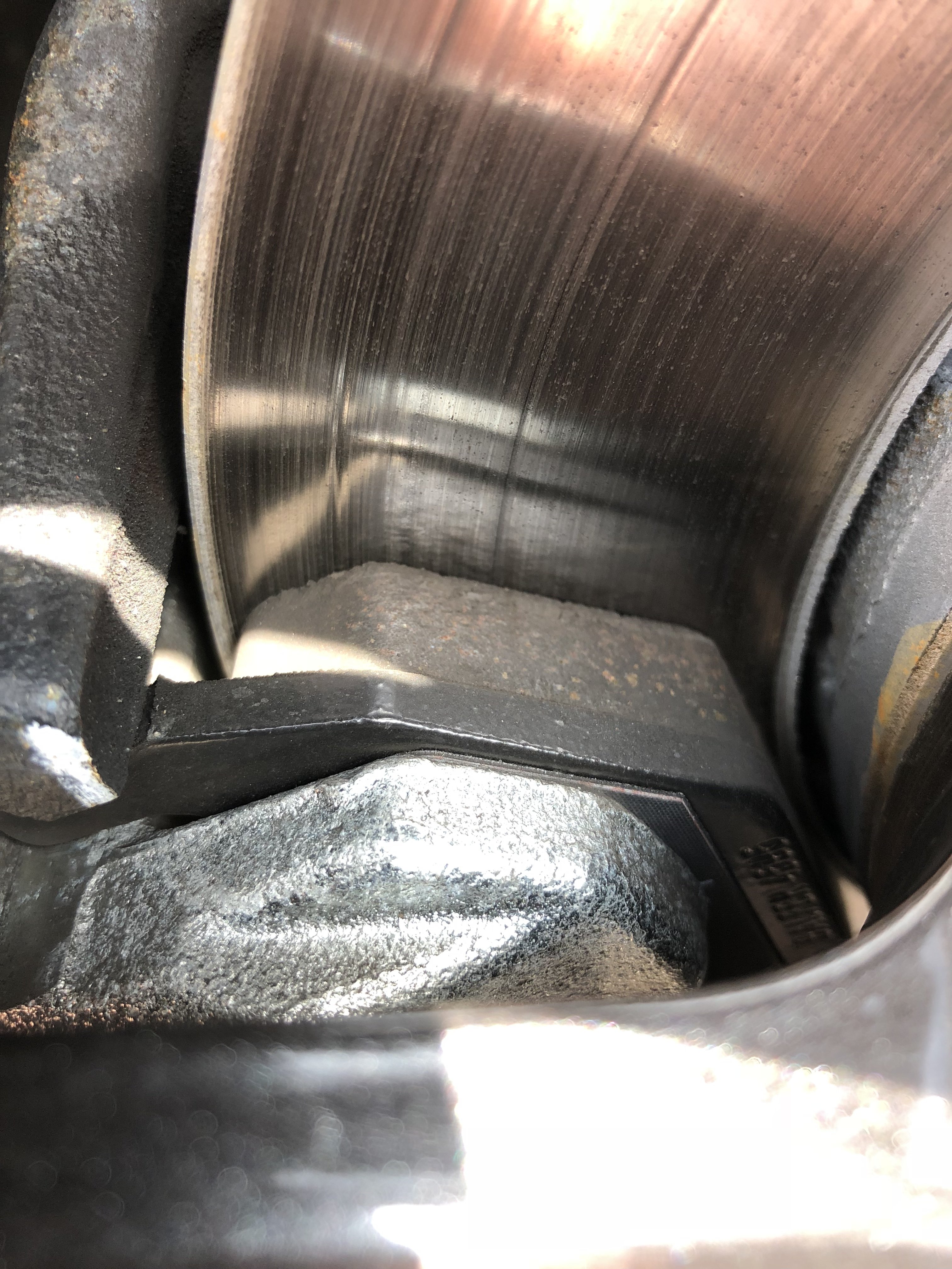

Sorry, but I am disagreeing with you on that one. The pad has scored the disc (which I can run my finger nail in) due to a foreign hard object which is in the brake pad material. What is not to say the hard object isn’t all the way through the thickness of the pad material? If that was the case the disc would be scrap long before the pad wore out. Please bare in mind the damage has occurred after just 300 miles. I am a qualified motor vehicle technician (but now in a different trade), and if that had come into my workshop I would advise they were replaced due to the damage after such low miles.

Sorry Pumatron I didn't realise you'd had the pads off and seen the 'hard object' in the pad material.
Of course any foreign body manufactured into the pads is good reason to return to the dealer.
I was merely referring to the scoring of the discs caused by any amount of road crud/grime/grit which happens from day one and is normal,

Pumatron, I seriously doubt the pad/s came with a foreign object in them. In 33 years as a tech & master tech I never experienced such a thing, which of course doesn't mean it couldn't happen. But the pad manufactures do have processes in place to prevent that type of problem. Your pads are not harder than your discs as you state in your earlier post. Scoring can only be caused by foreign objects/debris. I don't of course know how you have been using your car but the foreign object has for sure been picked up since you took delivery. That's pretty much for certain unless you have evidence to prove otherwise. The scoring/marking on your disc looks fairly normal too even at such low miles. The fact the brakes are not bedded in yet (as you know takes around 1000 miles) makes them vulnerable to scoring, and they won't perform anywhere near peak efficiency until they are bedded in. If you remove the foreign object from the pad the disc will just return to normal with the scoring disappearing quite quickly. No need to do anything else. Once bedded in your brakes will function perfectly. Make no mistake the Fabia brakes are as good as any you will find. Mine stops on a sixpence with good pedal feel. Your brakes will just get better and better as the miles go on. If they don't it means the friction material on the pads has been damaged or seriously glazed by inappropriate or excessively heavy braking before the brakes have had a chance to bed in.

Just an add on here Pumatron. You can notice a rusty ring running around the outside of the flat surface of the disc in your photo. The brake pads don't cover all the disc right upto the edge. Over time as the disc wears this causes a ring of untouched metal to stand proud around the disc. You will know it can sometime be annoying when coming to fit new pads if the pads are not the OEM pads as you have to grind off the offending part of the disc to get the pads to fit properly. However, that ring is actually helpful as time goes on and helps protect the disc and pads from debris. At the moment your discs don't have that protective ring so debris can get in between the discs and pads very easily (as on all new cars) making disc damage more common at low miles. Just saying. And yes, I did the Mintex technical brake fitters course for cars and commercial vehicles where you learn further stuff like this...although it's common sense really. So just saying, not having a go or anything.
