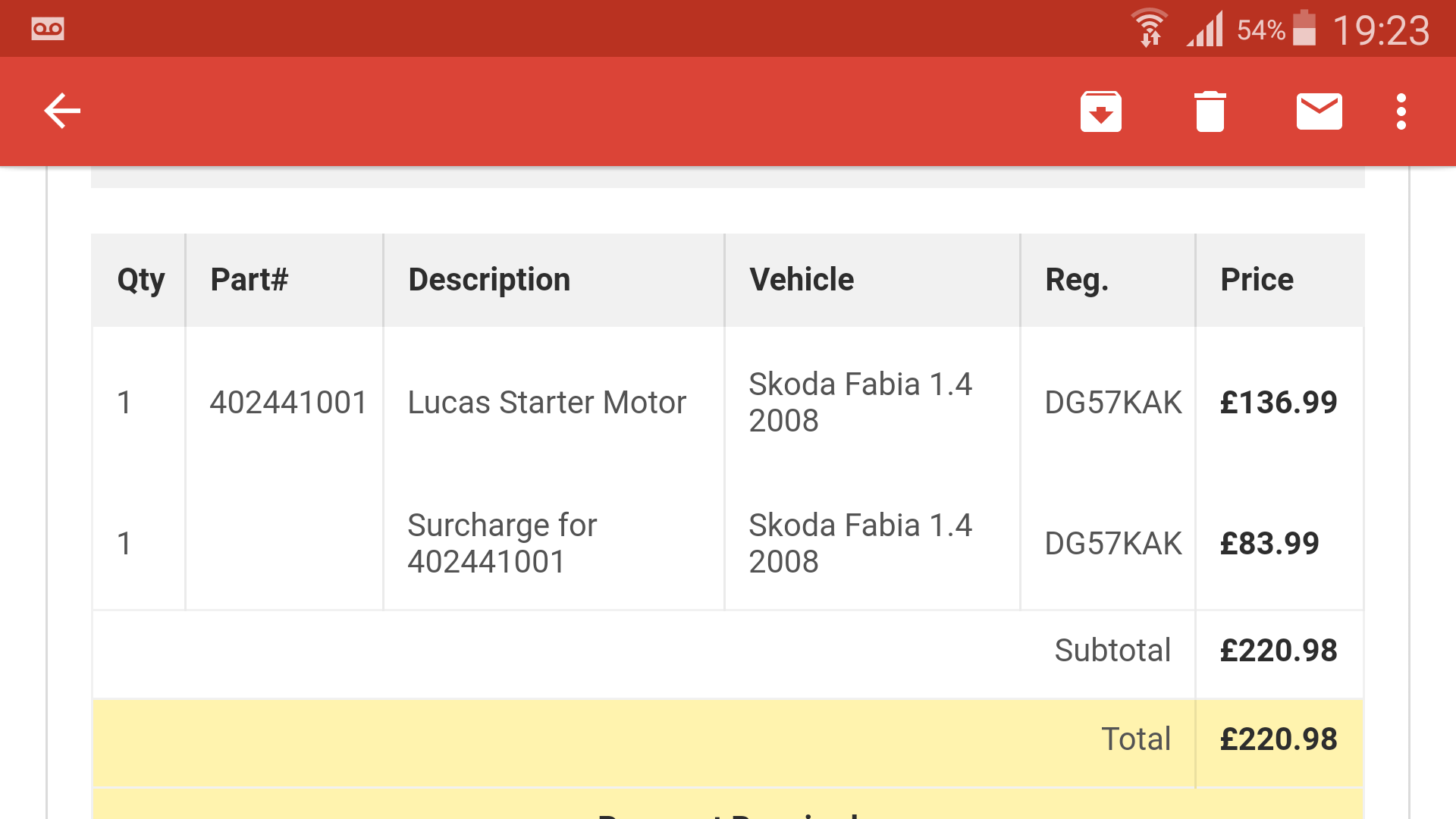

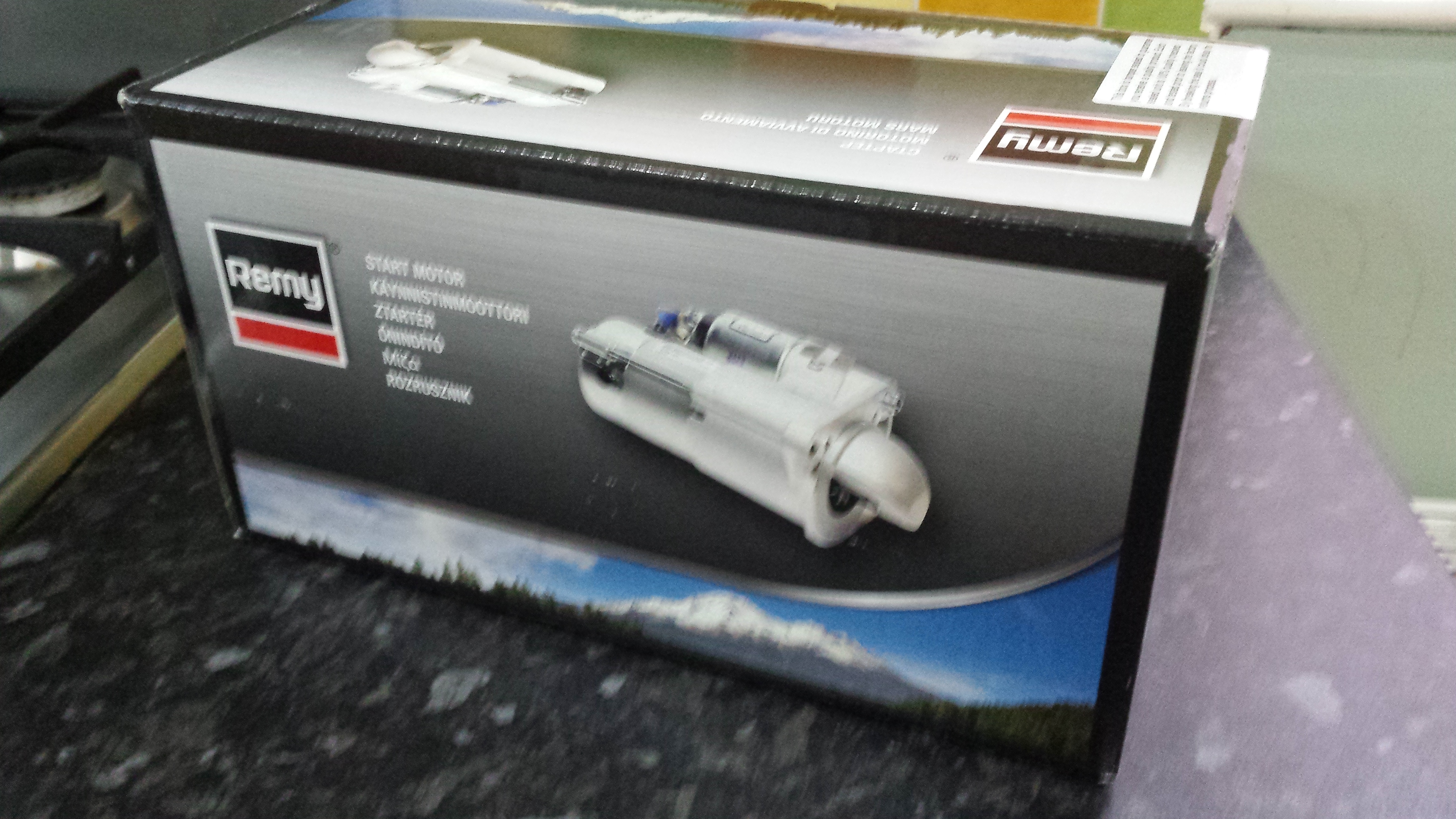

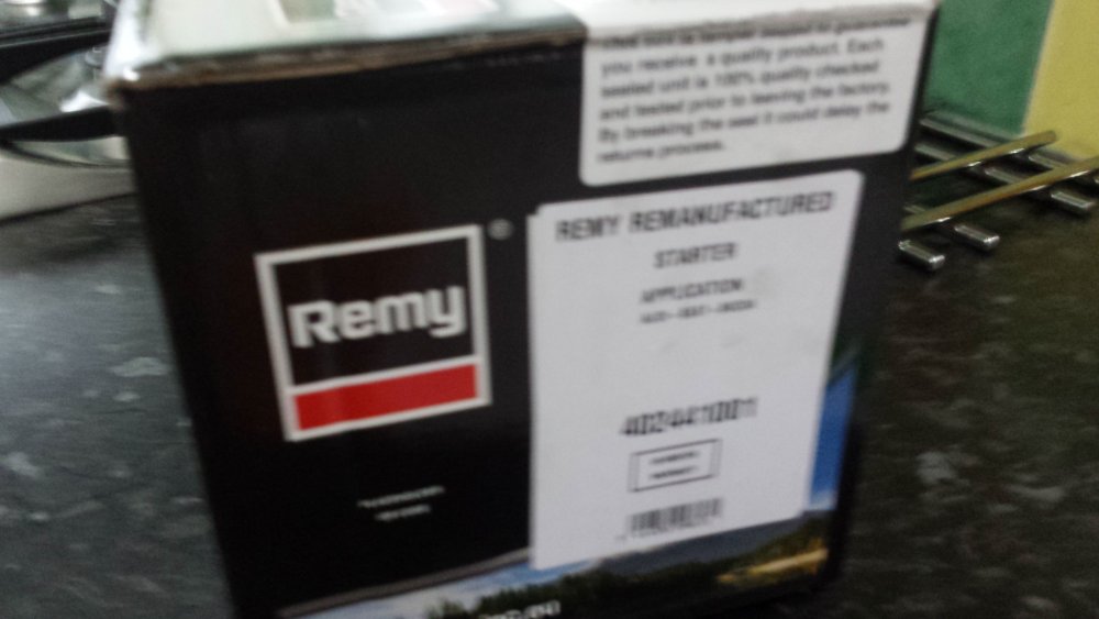

Ok so recently the starter motor failed on my 2007 Fabia so with the car stuck on the drive and an ECP store 20 mins walk away I ordered a BRAND NEW Lucas motor (ie. not ECPs budget reconditioned motor offering) and paid the advertised price for the new lucas one of £136.99 less 35% with an online promo code which came to £89. So here are the pics of my order & the brand new lucas starter motor they kindly supplied...
Obviously with little time to faff around I took it back to be told "it's the correct part it will fit have a good day" & the guy at the counter just walked out & closed the door behind him! So can I just warn anyone that ordering a brand new part and paying the extra at ECP clearly does not mean you will get it, & they are not bothered when you try & complain either!

 Remanufactured starter motor will work every bit as well as a brand new one, but you shouldn't be paying new price for remanufactured, agreed.

You wouldn't get a brand new starter for that price anyway these days. Pretty much every electrical rotating unit sold through a factor these days wil be a recon unit, been used for years - oh, and i would rather fit Remy than a Lucas unit
