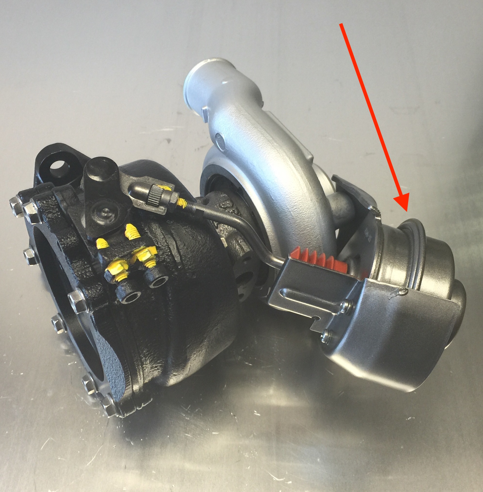

Is this the BAS you're talking about?
vauxhall-meriva-turbocharger-1.7-cdti-100-bhp-74-kw-03-49131-06007-turbo-opel-engine-code-z17dth-[3]-2047-p.jpg

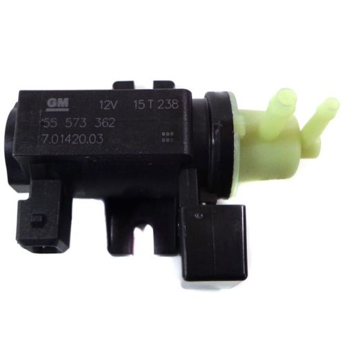

or this ?
29 minutes ago, Bertie90 said:
or this ?
This one.
The rubber diaphram starts to fail internally and **** up the boost actuating.
