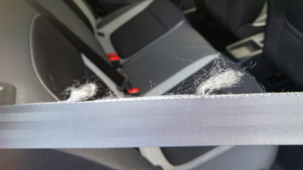

in my wife's Fabia, something sharp has been catching on the seatbelt and the belt is starting to fray at the far reaches of the belt (photos when I can get a chance to look at it)

 I'll be taking a close look at the belt mechanism to see if any sort of manufacturing default could have caused the fraying

exactly - I don't expect the dealers to roll over and accept it as a warranty issue, and will probably blame it on some sharp bit of plastic somewhere on a kiddy seat that we haven't noticed.
My wife sent photos to our local dealer. They asked her to bring it in for a proper look, and suggested a price in the high 200s to get everything replaced
she then also popped into a local independant garage - the guy looked at it  and pronounced that it was "only a little bit of fraying" and that seeing as it was right at the end of the belt, where it's not always used and it seemed to be working, that we should just trim off the fraying bit with scissors to avoid it jamming in the mechanism.
who to believe ??
Edited by Wet Kipper
I would be wary of trimming bits off a seatbelt... they're kind of important.
Absolutely. I took my Yeti for its first MOT recently and it failed because of the front passenger seat belt fraying at the connection end deep down in the pillar where it never moves (!) Dealer said wear and tear not covered by warrantee (which was running out in 2 days!) Started arguing with Skoda UK and had it replaced @ >£200. The dealership that did the job was very helpful negotiating my case with Skoda UK who have confirmed they will cover the cost as 'good will'. I still can't believe  defect in a seatbelt 3 years old is not warrantable unless it has clearly been abused.
Anyway, do not mess with your seat belts because they are now rigorously inspected in MOTs and if you have this problem, definitely argue your case with the manufacturer.
