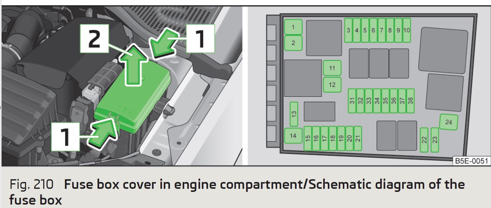

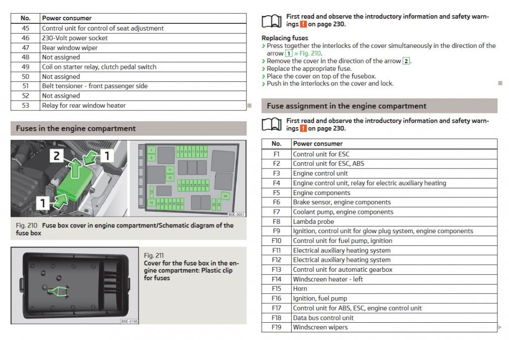

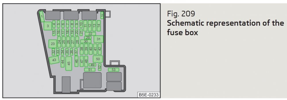

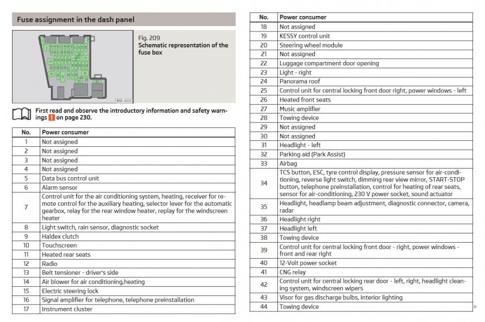

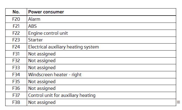

He is the fuse layout from the manual. I'd check all fuses that have something to do with AC and the radiator fans for starters.
Anyone local to you with VCDS to scan for low AC gas pressure or at least check the measuring blocks to see if the compressor is kicking in and building pressure?
