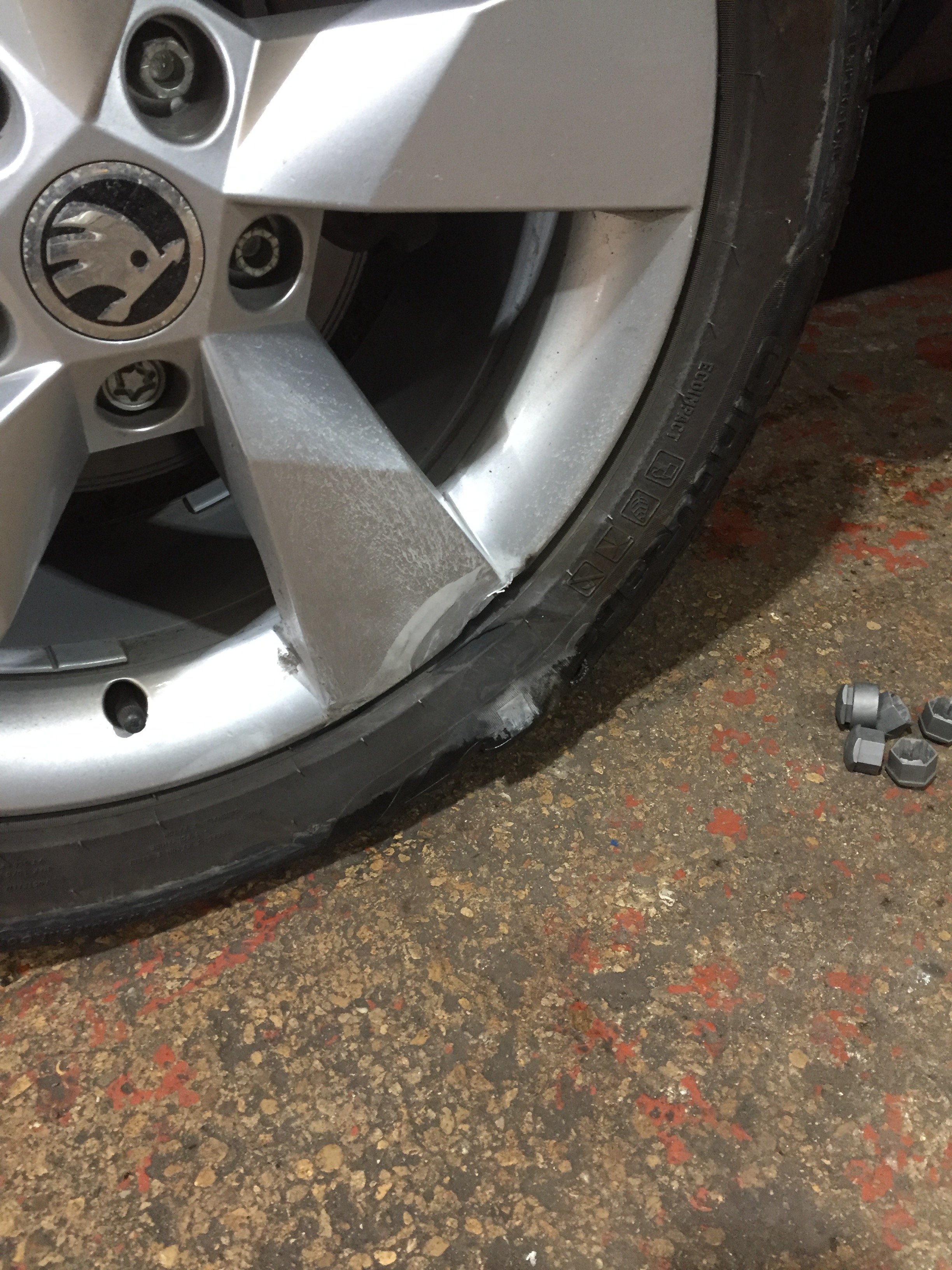

Feeling like a prize idiot. I took a big hit to the offside wheels having hit a central reservation kerb. Two tyres dead and two alloys with chunks out of them. Luckily there was a tyre place just up the road for new tyres, but their tracking ramp was unavailable. The car is driving massively out of kilter and the ABS light is coming on when going round corners, so it needs the tracking done ASAP.

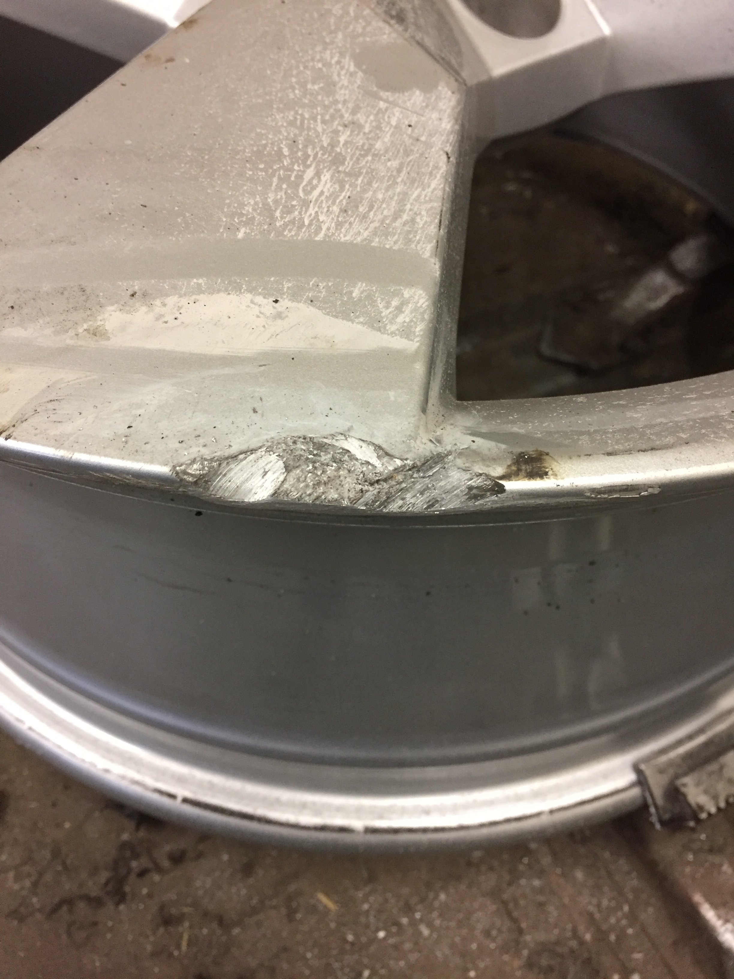

Any damage to the alloys? (Beyond the obvious missing chunks)
I'd be surprised if they're still straight and true

I’d be worried too about if the wheels were straight, I’d get it checked. They use the outside of the rims to set up the car.
Looks to only be the chunks. To the eye anyway, how could I check otherwise?

I suppose you could jack it up and rotate to check, but you’d need a dial test indicator to properly see if it was a small amount, I would guess a good tyre place (or the alignment place) should be able to check, you could always phone and ask, I’m sure they get it all the time.
I don’t know if they are repairable or if you’ll have to get replacements.

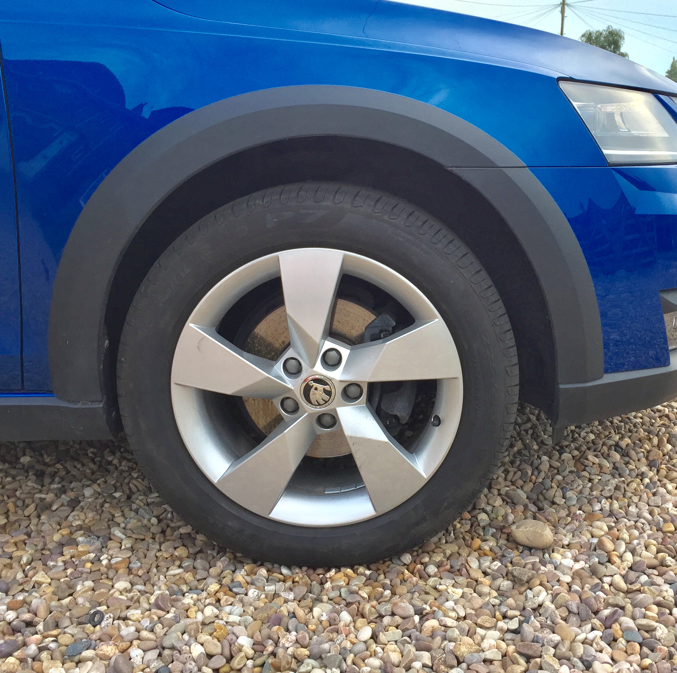

This is where the front wheel is sitting now. Barely has the clearance at the back of the wheel arch from full lock L to R.

Suspension components will bend before the chassis does. I’d expect it to cost a couple of thousand to fix but there’s no way that should be a write off.
