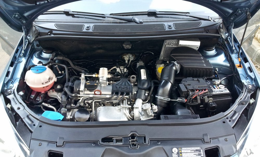

It will be the cbza ea111 cam chain engine.
Metal canister oil filter Mann W712/94 mounted on top of engine. Very easy to change (with the cup wrench). Undo 1½-2 turns and leave for 1 minute to allow filter to drain down before unscrewing completely. Make sure to remove the old inner rubber ring seal that often gets detatched and left behind and sometimes missed if covered in black oil.

I just took a look under the bonnet (should have done it earlier!) and it is a CBZA engine and the oil filter very much appears to be a metal can (W712/94 filter).

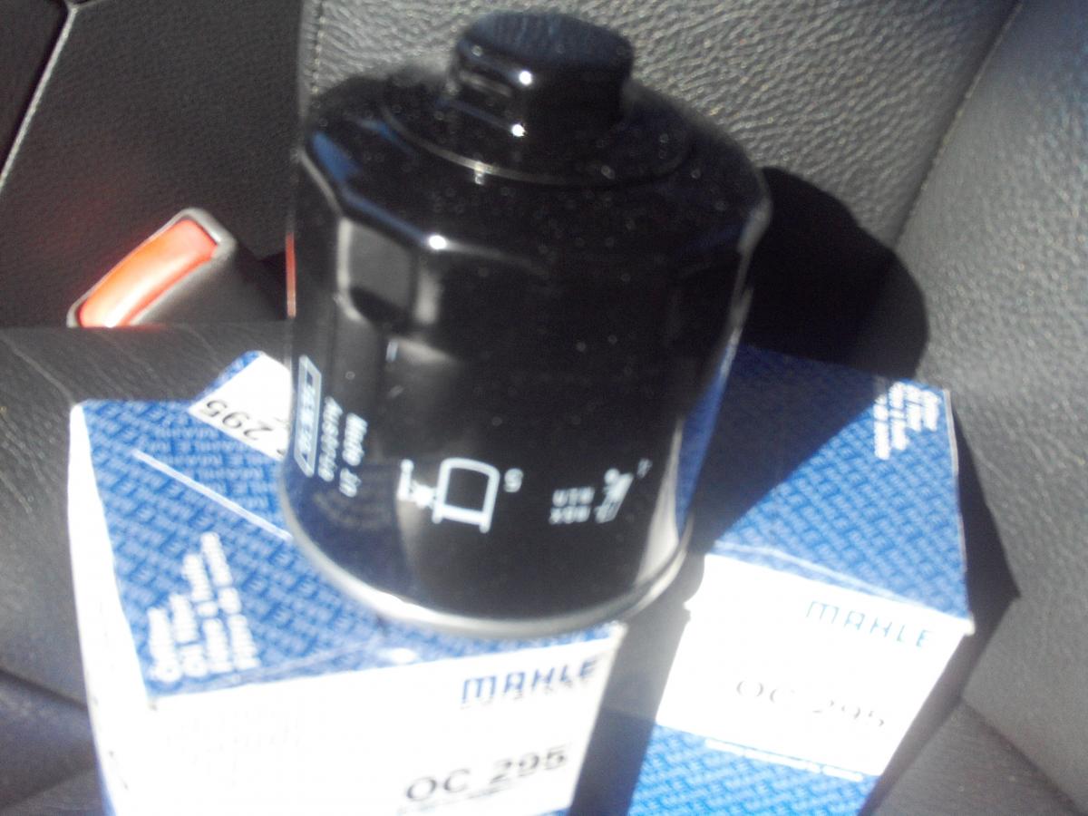

I always used Mahle Oil Filters on my Fabia Twinchargers and other peoples.
Not because they only cost me £4, but because they were good, and i did not like the Silver Filters VW / Skoda went over to.
