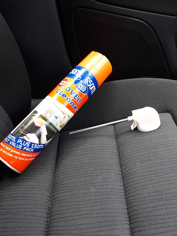

( Pound shop large tin and the nozzle is off a 99p compressed air tin .  I think most tins, WD40, Air... Are a slandered nozzle size.. )

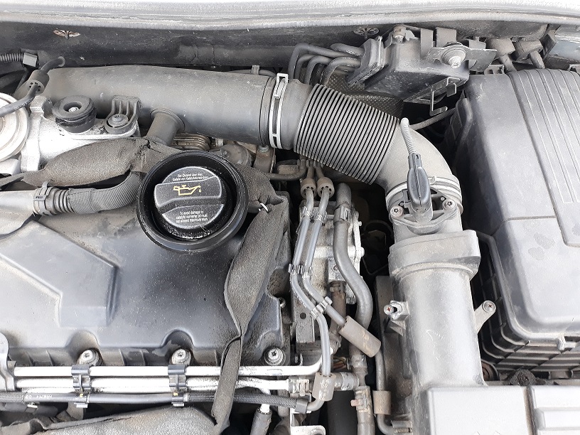

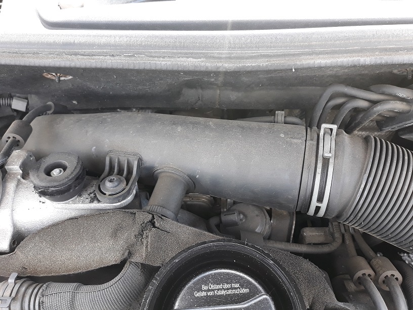

Am I right to take the clip off the hose  in photo 1 and spray oven cleaner down the pipe ?  Also should the engine be hot or cold ?
( That pipe go's behind the engine and down so I'm presuming it go's to the Turbo... ? And in the video above the guy has taken his EDR off.. )

No No No! The oven cleaner has to be squirted directly into the exhaust side of the Turbo. This involves getting underneath the car, disconnecting the exhaust side and filling with the foam a few times. This is where the variable vanes are situated. All you'll do by squirting that in there is.... well, I've no idea what would happen but it won't work as intended and might damage something!
No no no don't squirt oven cleaner into the intake!!!
Undo the egr pipe and squirt it in through there.
I'd suggest trying Forte Turbo cleaner first. The MrMuscle trick.. I would try that as last resort.

Now found this link which shows the inlet clearly, and where the Mr Muscle and the like get's sprayed into thanks.
http://www.dieselturbocleaner.co.uk/how-to-use-diesel-turbo-cleaner
Edited by 2goat
I have some Wynn's EGR cleaner already to use in my boot. On video's I see people spraying it into the air intake.. The same way this guy ^ in the video above in previous link is saying he's cleaning the turbo ?
( The same pipe I posted when asking about Mr Muscle in previous post ^^^^ )
Should I go ahead and take the clip off while engines running and spray it in short burst until the can is empty ? ( The spray tin of EGR cleaner I have that is. )

EGR cleaner is used on the intake, like in the video. However, your issues doesn't seem to be EGR related, but the turbo.

Also no need to remove exhaust to do Mr Muscle, loads of vids on you tube showing how to fill turbo from the EGR pipe, the best way to avoid carbon building up in the future is to regularly excerise the turbo,  short trips pottering around will allow the carbon to build up to get worse, these 1.9pd engines are great but don't like being driven like miss daisy.
Thanks Cryonut,
That's what I'm getting confused about... Where to squirt the Mr Muscle in..  I've seen some of the video's..
Can you tell me which part of the EGR pipe ?  Is it to the left side - ( Which I've had off before to look directly into the EGR )  Or another part..
