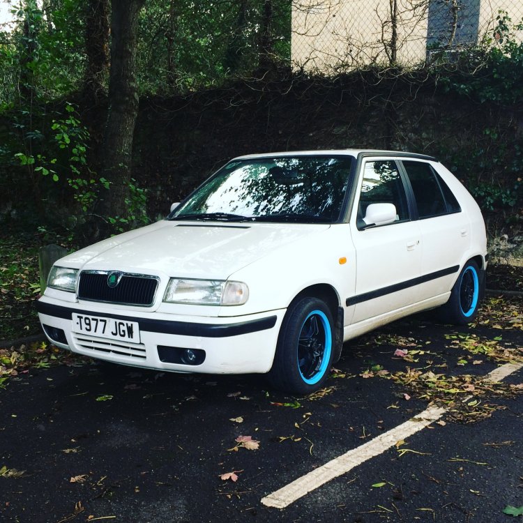

Hi there,
I’m new here. I’ve encountered several threads in regards to Felicia engine swaps and here I am about to start another...!
I’ve owned and driven this spotless Felicia for 6 months now, and since I’ve had her I’ve been making a big long list of considerations for her as a rally project. (I’ll be keeping it road legal but I am not planning to have it insured as a daily car)
My original plan was to keep the AEE engine and do a forced induction project, but from daily driving and a little research I don’t think it would handle it well and there wouldn’t be much benefit.
This has led me to the conclusion that an engine swap might be better.
But as always, handling and braking comes before power and I have a few strategies in mind to improve these areas.
STEERING
I currently have a standard powered rack, and I’ve noticed the steering angle is a little narrow for my liking. So my first question is are there any other racks with a better stock angle that would marry up nicely? If not, I can work with the current rack and modify other steering components.
BRAKING
The non-ABS system with rear drums has very vague response (even with brand new fluid, discs, pads and shoes) and I saw some people have fitted the ABS capable components - does this increase responsivity?
I plan to fit discs to the rear using the stub axles from a mk2 golf (still evaluating the changes I might need to make in cable length and brake load sensor valve), is there a brake system that anyone has tried and would recommend?
SUSPENSION
I am looking at running slightly lower, stiffer springs with standard shock absorbers, I’m not aiming for low-low, just less body-roll and more responsive handling. Upgraded bushes etc. Does anyone have any recommendations?
ENGINE
I am not a speed nut, my main aims here are rapid response, quick off the line and round a corner - not unbridled speed in a straight line.
my first thought was a simple, small turbo for fast spool on the current AEE.
Now, I am considering an engine swap. I see the AVY mentioned a few times, and my question is to this - has anyone successfully installed this engine and then turbo/supercharged it? I wonder how many options there would be for the future should I choose to expand on it in the future? (I should add - I only wish to take this project on for the sheer love of engineering, the fun for me is in the process so I’m not put off by time/financial constraints, I want to produce something interesting)
Next, I am tempted by the 1.8T - feel free to persuade/disuade me!
Finally, I have seen the 2ltr Ford engine idea bandied about the place - has this been done successfully?
I would love to see any examples of a successful AVY swap, as at this moment in time it sounds the most feasible, but feel free to add any further suggestions with evidence!
Thanks,
Mechanagirl
