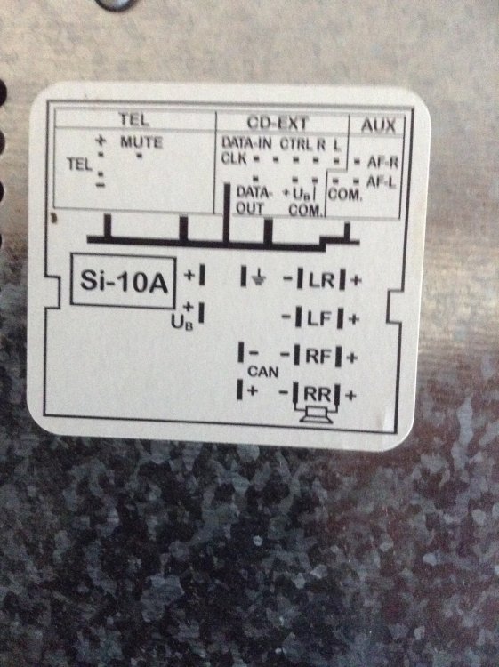

Hi, I'm replacing the Dance unit in my wife's Fabia 2 with a Pioneer DAB / Bluetooth radio. I've got all the wiring loom bits including a connect2 conversion lead.  Looking at the label on the back of the Dance unit, and having tested the pins, there doesn't appear to be a switched live to the plug ( both the positive supplies are red and permanently supplied). I've read that on the Dance unit this may be achieved via the bus lead which obviously won't work on the pioneer unit. Is this correct, and if so how have others got round this?

Its because the onboard power supply unit controls the switching via the CAN bus.
Easiest option is to simply add another / splice into a switched live from something else........

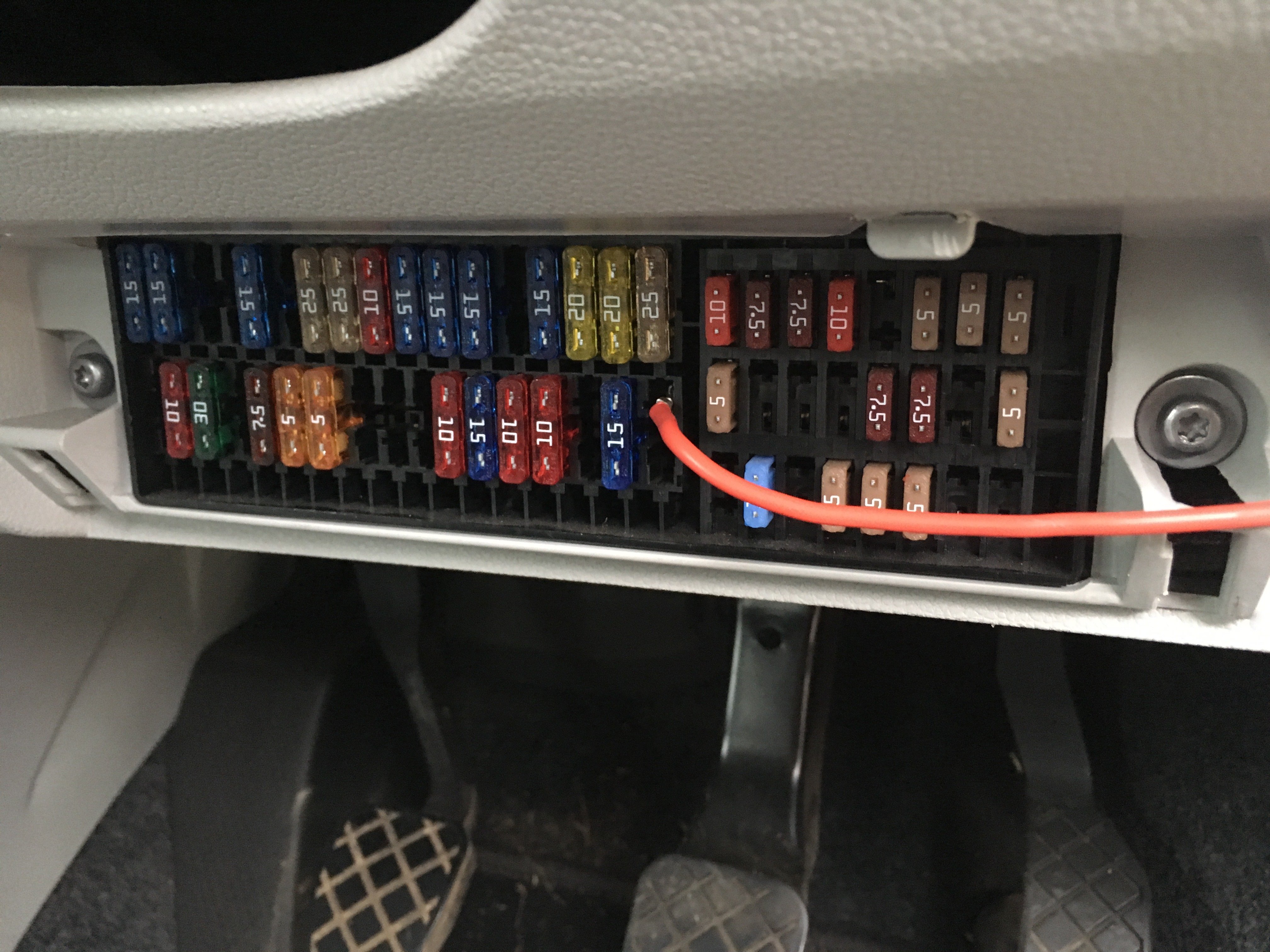

I did get round this - I identified a switched live on the fuse board which wasn't used ( possibly for the heated seats?) and put an inline fuse and connected this to the radio.  Works fine.
I used a standard blade connector to connect into a spare fuse way.

so is there a fuse in the circuit or does that blade/wire go straight to the headunits 12v connection?
I successfully used a Piggy back fuse connector in the fuse fit the rear wiper. This is switched live. I've dine this in two successive Fabia Mk2s and it's worked perfectly each time. Also fairly easy to get the cable up behind the stereo with a bit of fishing!

 An you show a photo of where you then connected to the back of the stereo please.
Im trying to fit a RCD330+ and it works fine but doesn’t recognise the ignition being on or off, hopefully this might be a work around, otherwise I’m looking at a canbus simulator but I’m starting to loose patience with it now!
i don't have a photo of the back of the radio, but most modern units have two power wires, usually red and yellow. One is for a permanent live, the other for the ignition switched feed, i.e. Only live when the ignition is on. You need to check the instructions for the unit you have to confirm which is which.
