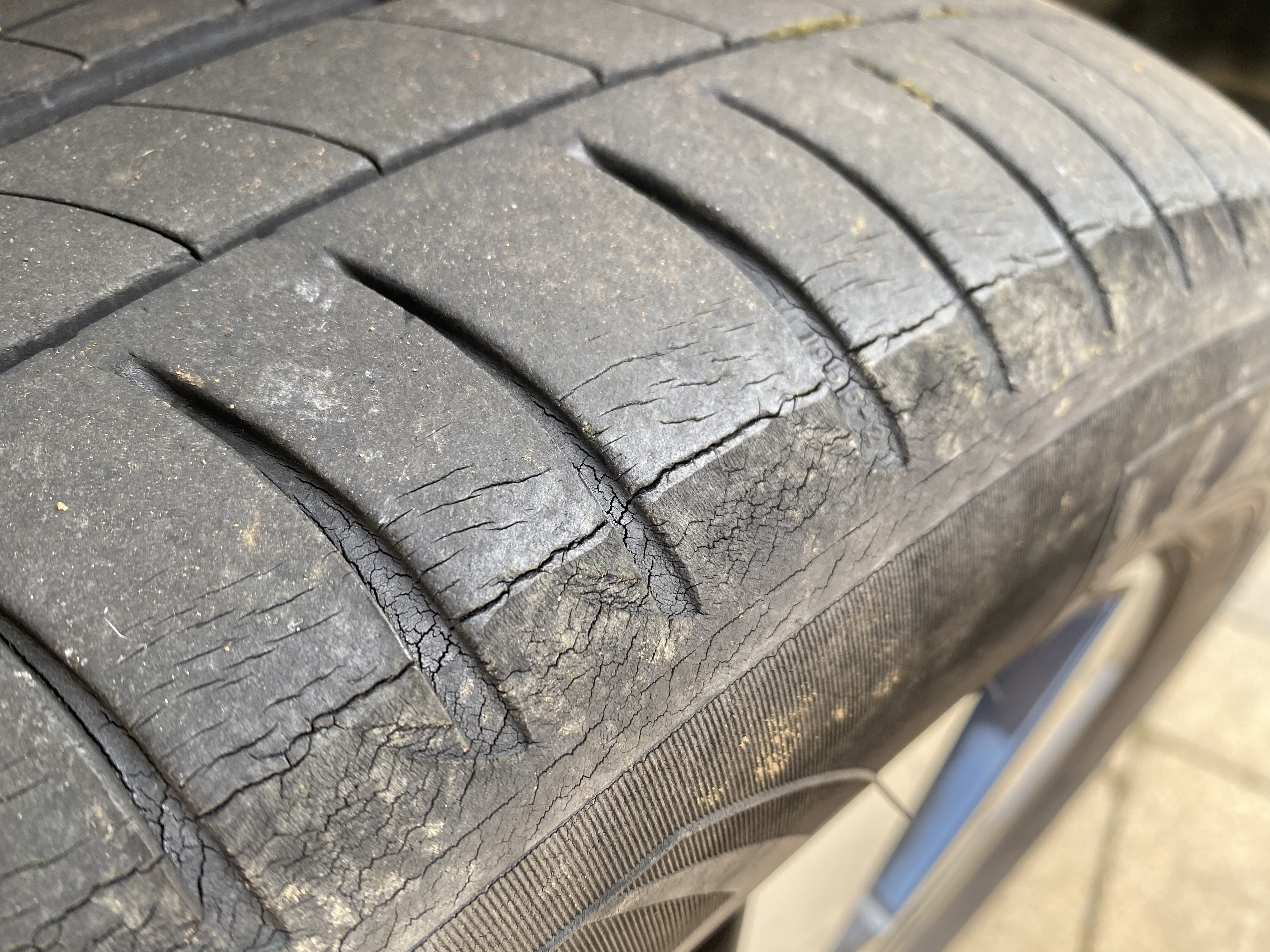

Found my way here while searching for Yeti tyre recommendations, and I'm mildly surprised to hear I'm not the only one whose Michelin Supremacy 3s are cracking on the shoulder. The only difference is mine have covered a mere 17k miles and are just 3 years old. Guess what I'm not going to replace them with?
Do the Michelin Primacy tyres get cleaned regularly?
Is the inside edge showing cracks?

I clean the Yeti approximately every 2-4 weeks, depending on weather. Autoglym  car shampoo on the body and wheels, which are treated with traffic film remover first to loosen any stubborn brake dust. The tyres themselves are cleaned with water only and I don’t use tyre dressing.
The inside edges of the Michelins are showing signs of cracking too, but rather than a series of small fissures as per outside shoulder, the inside shoulder has just one deep crack. Glad I’m getting them replaced early next week, that’s sobering stuff...

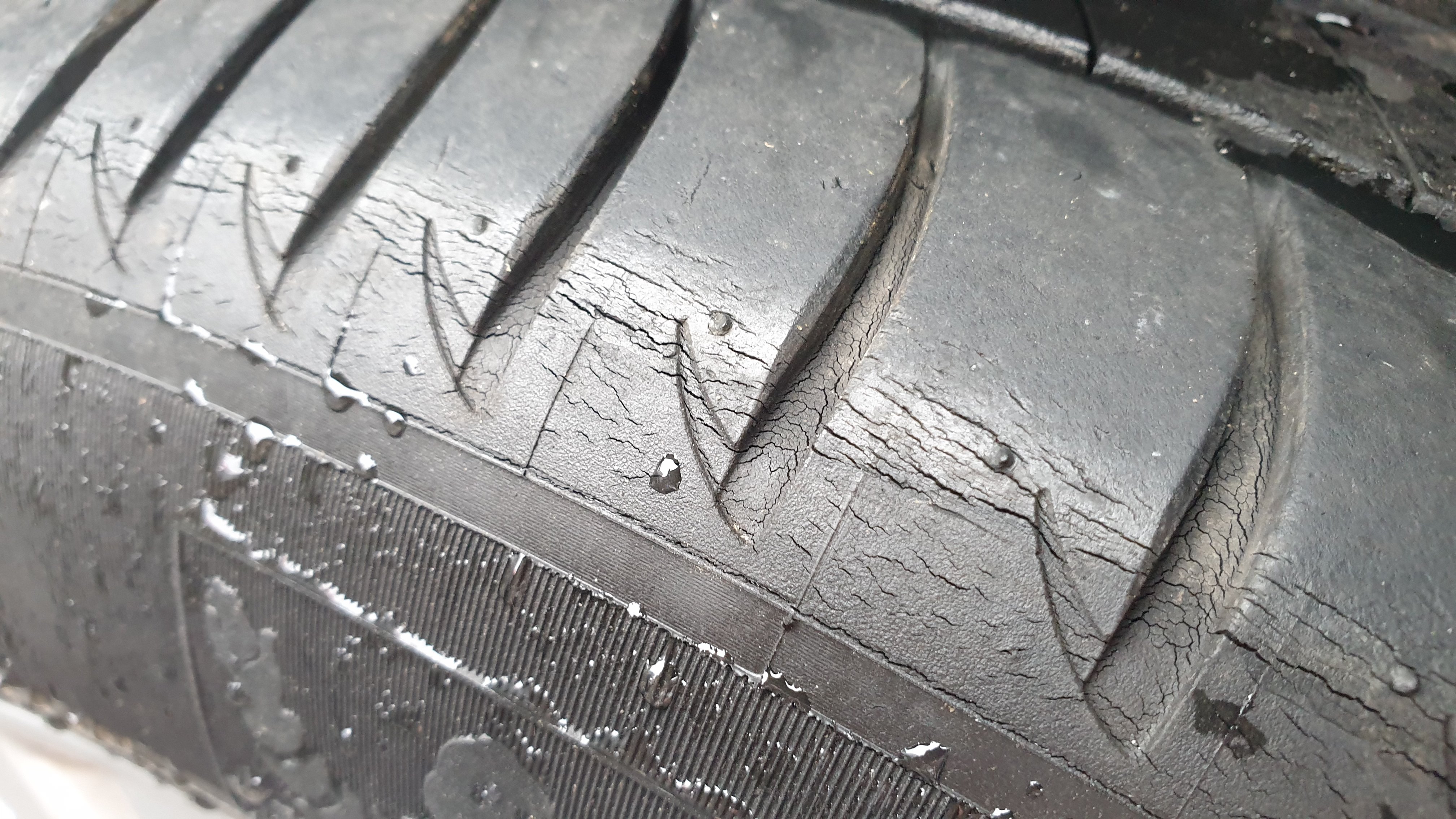

Yes one of ours is going slightly that way, but I've been to 3 independent tyre places who have explained that the tyres are safe to drive and the tread cracking like that is cosmetic, but to keep an eye on it. Sidewall cracks are a different matter.
Believe me, I'm as big a worrier as the next person but after looking into the way tyres are constructed and speaking to people in the trade my mind is at rest.
The outer treat is a completely different component to the rubber/compounds which make up the structure of the tyre underneath.
It's literally 'stuck on'.
Go to your local trusted tyre place and have a word to put your mind at rest either way...

I absolutely share your view regarding the small cracks on the outside shoulder, but when I saw the almost continuous crack along the inner shoulder I decided against squeezing out a few more miles while keeping an eye on them. We've some exposed mountain roads here without barriers of any kind, and losing it on the wrong corner would be an entirely different proposition to a low-speed puncture in town. Maybe I'm paranoid (each to his own and all that) but for the sake of £450 quid I decided to err on the side of caution this time.

Yeah that's fair. The inner cracking is really strange and for sure worse than the outer shoulder.

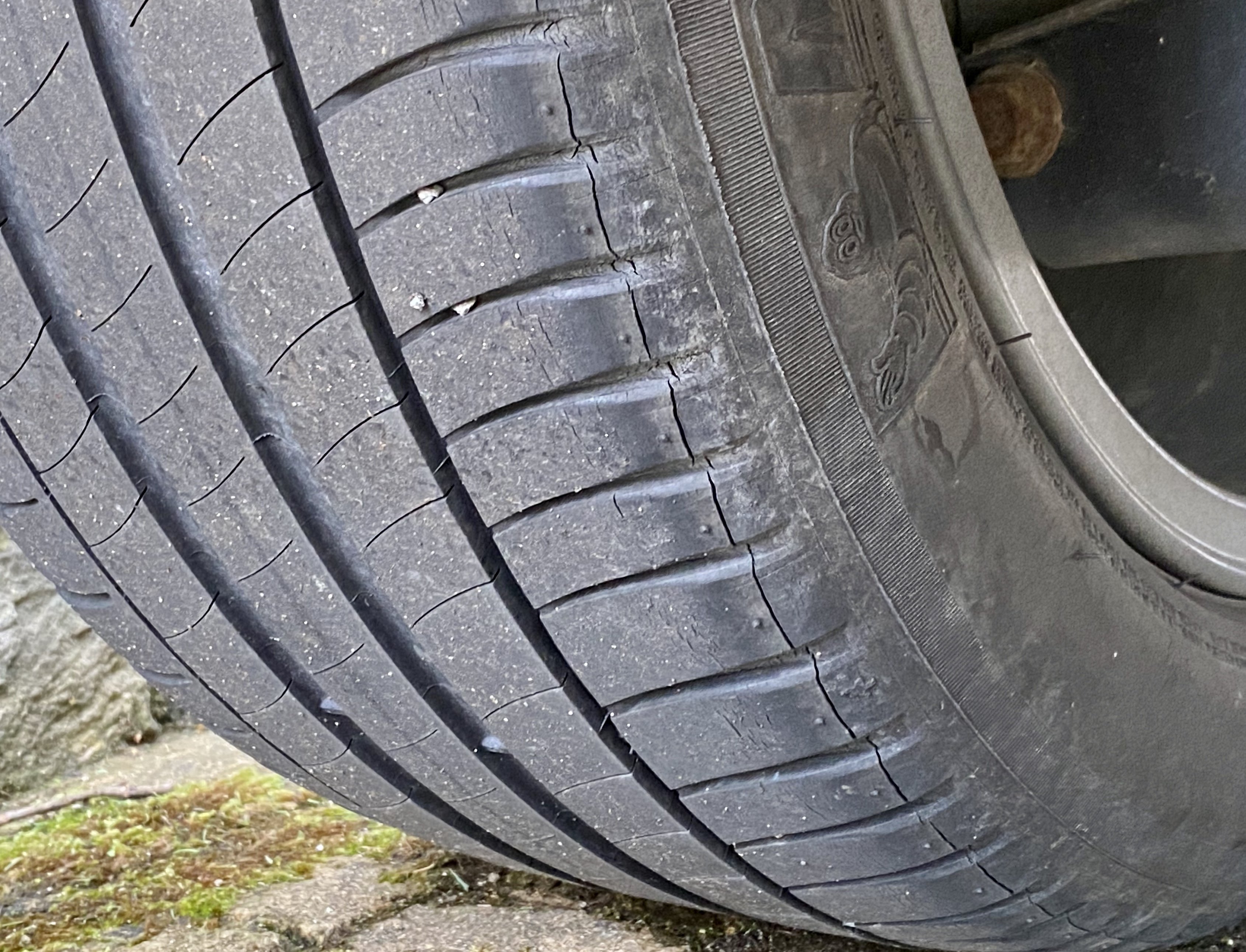

Looking at your outer shoulder, I think you're probably a year ahead (worse) than ours. I'll be taking these off and storing them over winter. I'll take a picture before and after they go into storage to gauge if they get much worse.
I haven't noticed any delamination whatsoever on the inner shoulder but I'll check this afternoon and report back.
Also, regarding the tyre pressure.. definitely wise to have a play around. It's always a 'range'. Find the sweet spot for you. I run higher on my winter set (35ish) because they have a taller sidewall and generally soak up the bumps better. My summers are bigger with a lower profile and respond better to 32ish.
Obviously all tyres naturally have varying degrees of sidewall stiffness so yes, horses for courses with pressure.
Here's ours. I couldn't see any on the inner shoulder 🤷‍♂️
