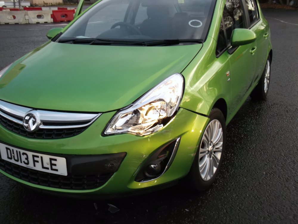

BCA / British Car Auctions have a multi multi million car preparation & valeting business.
When one of the Auction / Valeting drivers crashed into me he never knew his name or nationality and had to call someone to come give it, and as it was his name was that of the Owner of the company. Only issue was the owner is a different nationality.  Then my insurance turned out to be their insurance and a major shareholder of the business.
Just as well i took the drivers picture and the 'gang masters',  the insurance settlement was agreed with no loss to me.
Vehicle Preparation - British Car Auctions.mhtml
5258_2 BCA Valet.pdf
No VED at the time, driver possibly no valid license and a road open to the public, maybe not a public highway, but the police do move people on it being at an Airport.
