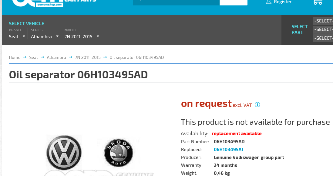

Looks like suffix AJ has replaced that number:
The correct latest pcv for ccza engines depends on original manufacture date as there are two different variants. So depending mfr date it will be either AH or AJ. They are slightly different designs one with an extra check valve.
All cheap ebay ones are fakes and I would not trust. Your only real option is dealer or TPS. They are about £80 to £90.
