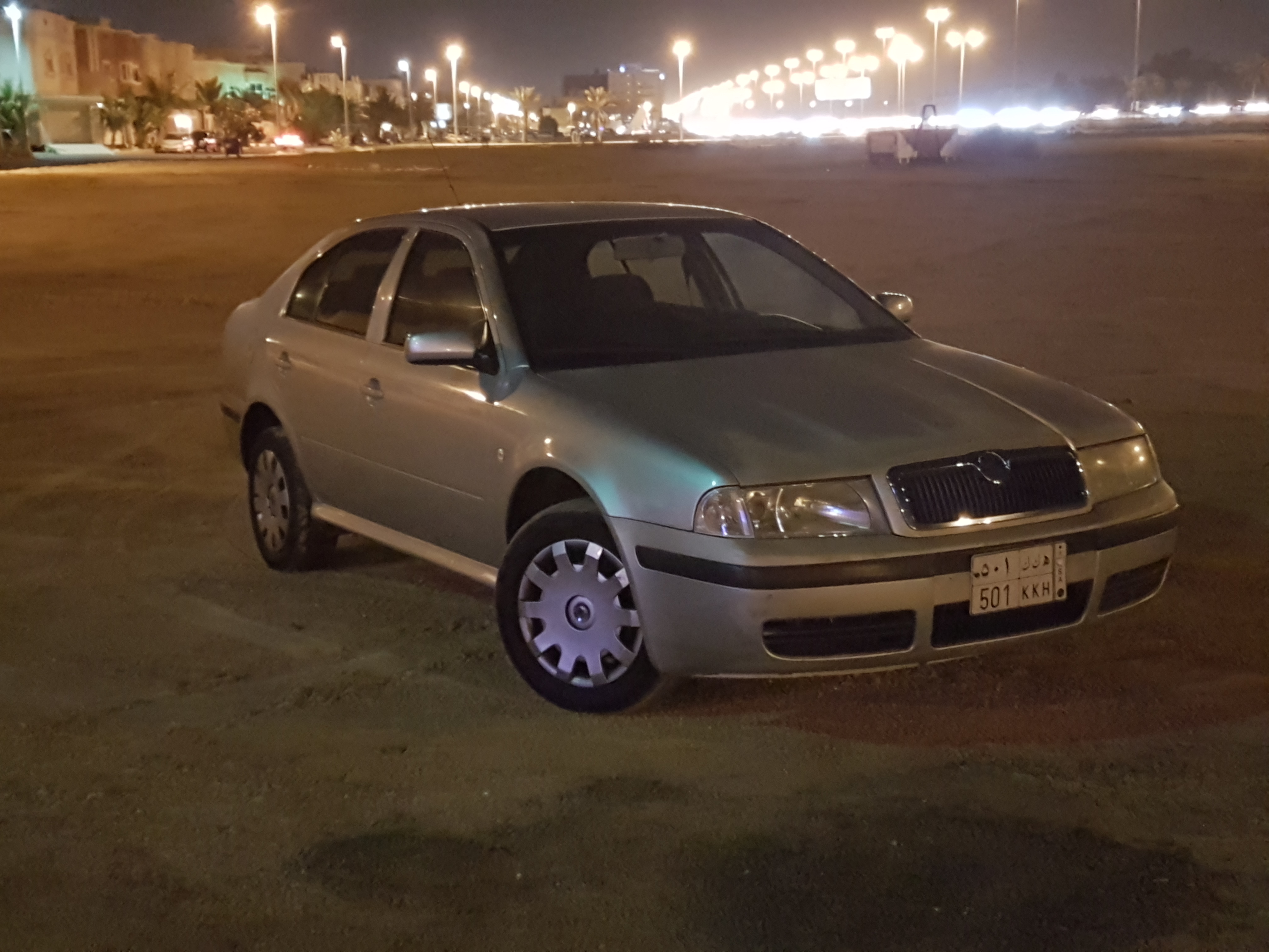

 - the body of the car went to a lot of BAD history  I want to Re-Paint the car with Black color instead of Sliver  also want to put the new badges of the skoda on the car

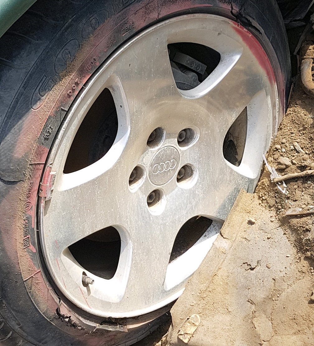

a new set of wheels  I saw this set of Audi A4 the tire was I think 215/50R 17  but i;m concern about my car's Drums I think it wont fit so i'm planning to convert the drums to disc break  to fit them!
- suspension is kinda worn in the car I want to lower it is there any factory suspension I can find the local store or the dealer like for Audi a4, vw bora and polo

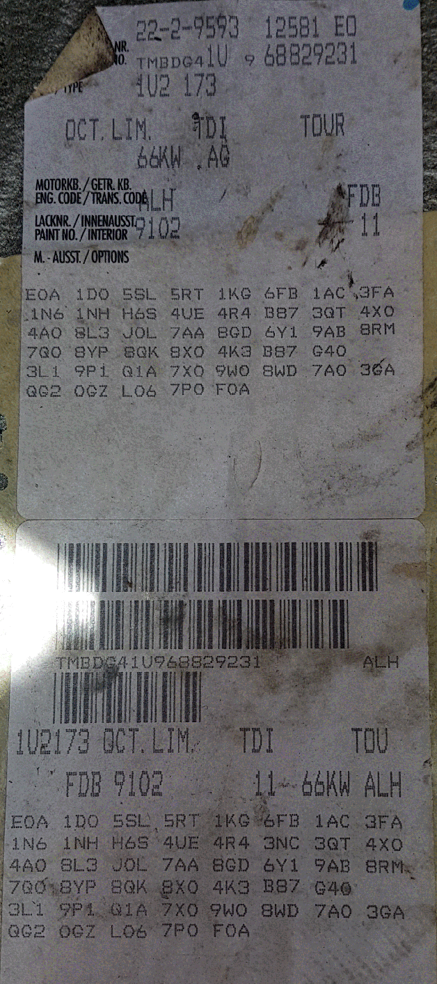

Youll need to give a bit more detail the car to get the answers youre looking for. Its a '03 1.9diesel, but which version? Engine code will be on the sticker under the boot liner - ALH, AGR, something along that line. That will tell us youve actually got. You said its "Tour" but thats the name they put on mk1's built after the end of original production to use up parts and sold only to taxi drivers, but That only started happening in 2004/5.

@akachi - OK, Wheels up to 17x6.5 ET42 5x100 will fit your car, subject to using the correct tyre size. The most critical points being that the offset must be ET38 or ET42, and PCD must be 5x100.

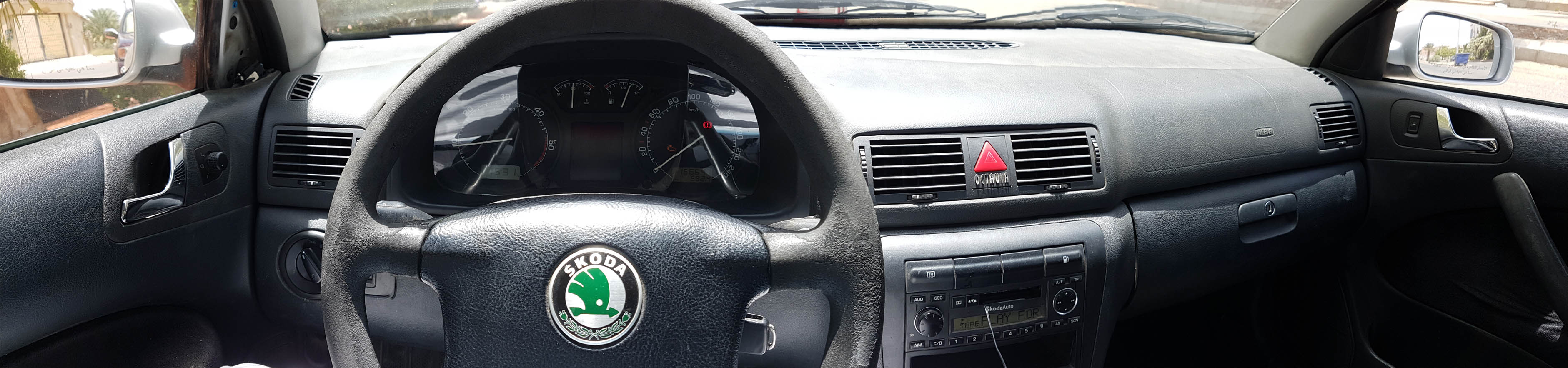

I don't understand what you mean by "roof lighting"? Do you mean the interior courtesy lights?

ALH

yep
Ah, its an ALH so 90bhp same as mine was.
If you change the injectors and get a fueling rate tweak done on the engine you can get it up to 110bhp with nothing else to be done.

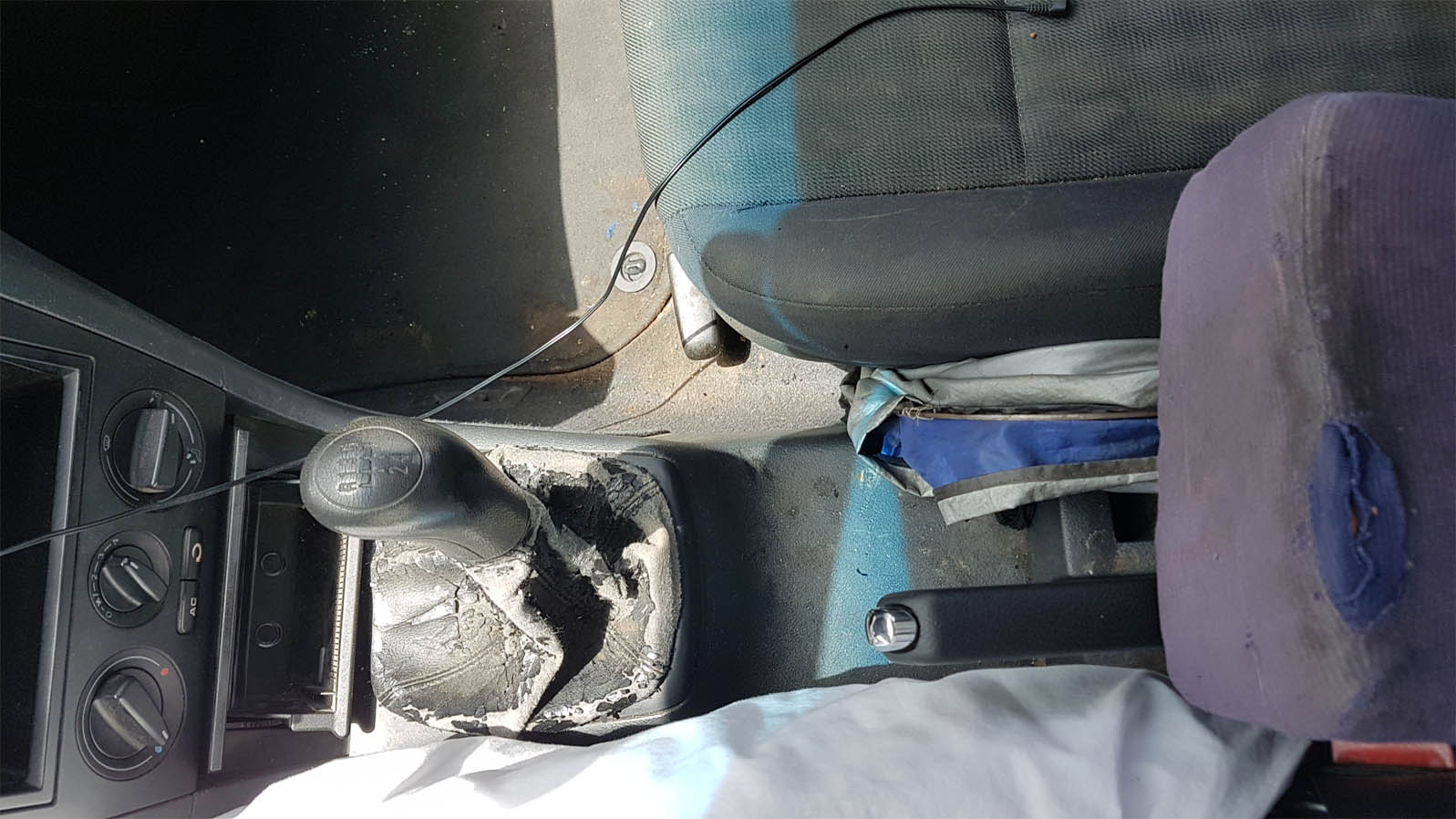

and make the interior GREAT AGAIN :muscle:

Your current paint code is 9102.
Black magic is 9910.
Any half decent auto sprayer should be capable of mixing and matching it.
Interior seats, carpets from a mk4 golf or bora wil bolt straight in.
Dashboard bits and door card etc would need to from another Octavia. Ebay for breakers is your friend there, though the shipping cost could be your problem.

@akachi - Well, the most likely causes of a "courtesy light failure" are that they've been switched off (surprisingly hard to get them into automatic mode), burnt out bulb(s) (depends on specification) and failed "door open" detection. So does the door open warning light come on when you open a door?

they told me that I had to change the break drums with discs to fit any 17's or 18's in the back
duuude look at it looks bad with the steels

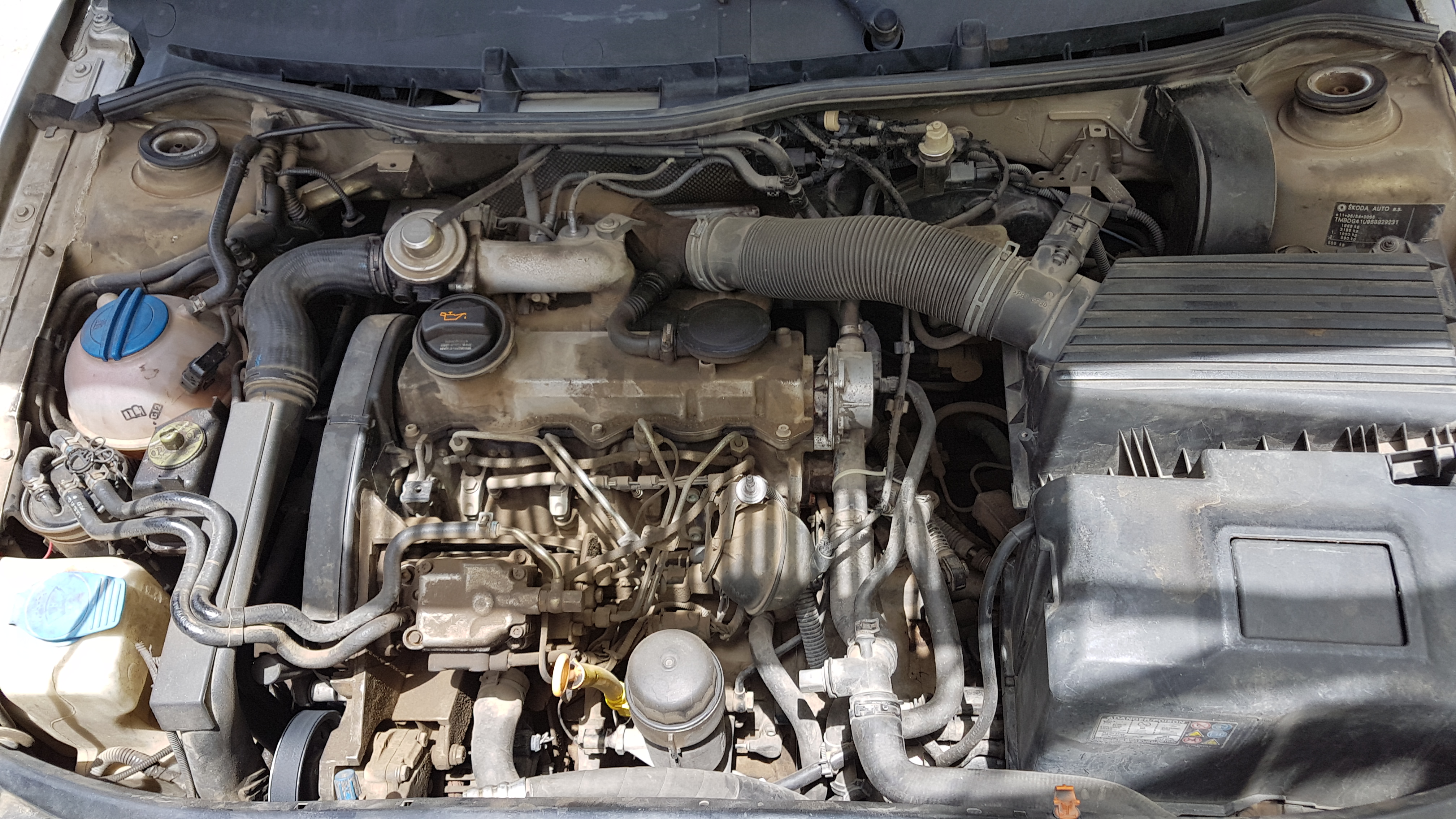

did any of you delete the EGR?
if yes what the pros and cons of it?

@akachi - What the garage told you is not true. You'd be retaining the same 5x100 PCD and centre spigot size so your choice of wheel would physically fit. Discs will look better than drums behind a spoked wheel such as the "spider" style on an Octavia vRS but this is less relevant behind something like a Compomotive TH https://www.comp.co.uk/wheels/motorsport.asp .
