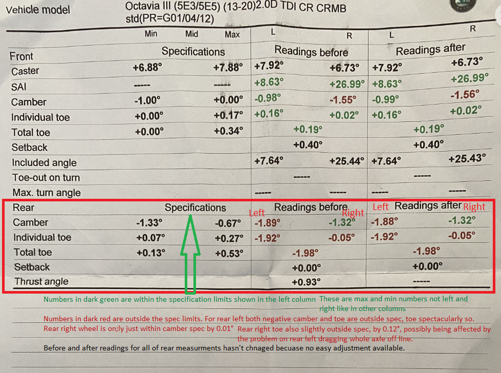

The correct values should be 1’32. I have 1’89. What could cause this?

Toe is miles out on left too, looks like something wrong at left end of beam.

If you like I can copy and annotate the relevant bits of that printout to improve its clarity?

See if this helps. Why do you not believe the rear beam has a problem (e.g. being bent)? Have you inspected thoroughly from underneath yourself?

Something shouts out at me from the above.
Manufacturers specifications for rear toe are positive, ie toe out, no way is that correct.
I am very wary of companies that dont know how to set up their equipment properly or realise that the figures in their print out are unplausible.
Looking at the thrust angle I would say that the rear axle is misaligned on its mountings (does the live axle have a crossmember with clearance on the fixings like the IRS version?) and if it were centralised the toe angles would be (more) equal at a zero thrust angle.

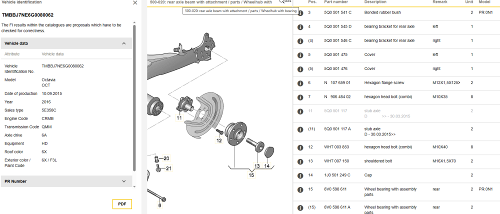

I don't think I have the relevant erWin documents for this model.
The wonderfully helpful fella that is @varooom may have?
