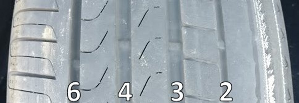

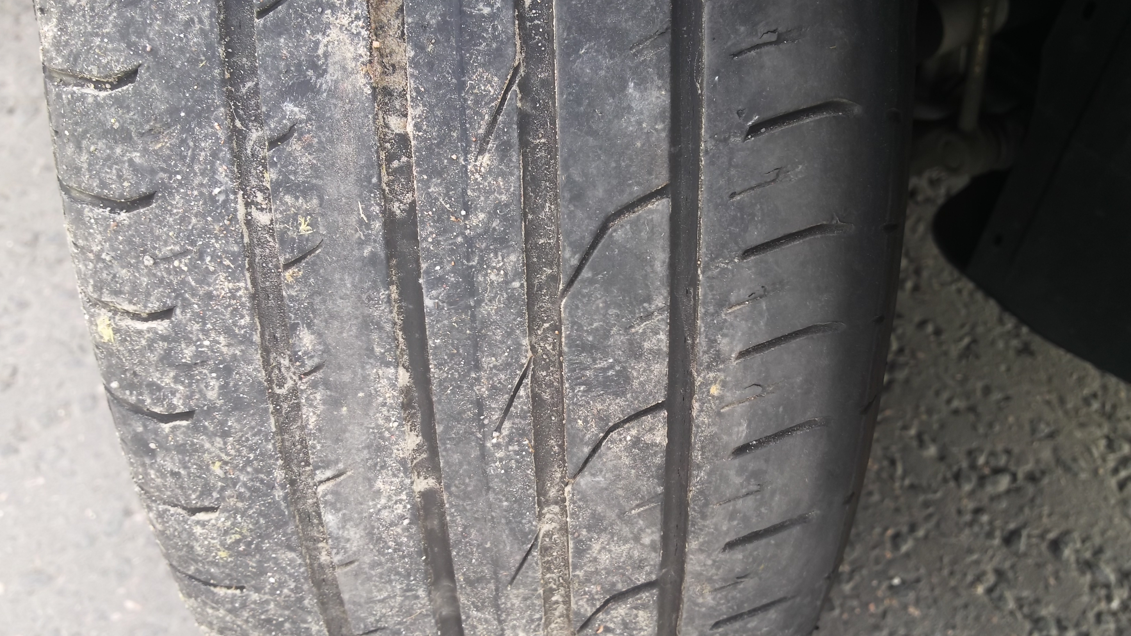

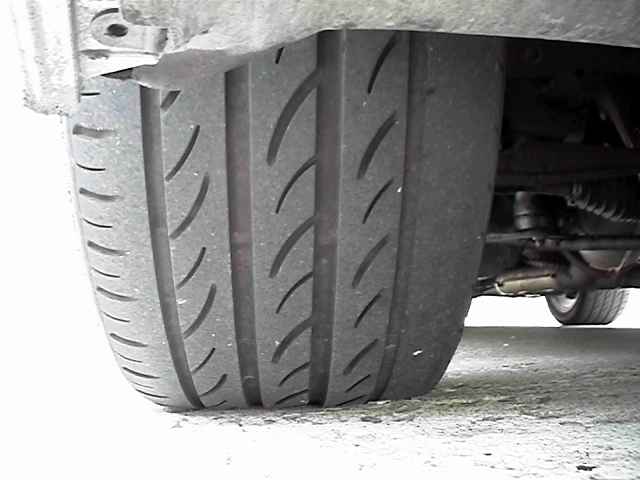

Found rear tyre flat on Friday morning, took wheel off to find inside shoulder worn through down to (and through!) the wire plies in spite of there being plenty of tread on rest of tyre. Put emergency spare on, then checked other rear tyre to find same problem. Tyres are P7 235/45 R18 on a Superb 220 Estate, had done 20000 miles on the rears.
Just a warning to other people to look out for this, because a normal visual/feel tread check from the side doesn't spot the problem, it's right on the inside edge only and you can only see it by getting under the car at the rear. Could easily have blown out doing 80 on the motorway with horrible consequences...
ATS replaced them this morning, also the two fronts which also had bad wear on the inside edge -- will take car to dealer to get tracking/alignment checked (VW leasing insist on this, not getting ATS to do it).
Didn't spot this in spite of doing a regular visual/feel check of tread, as you can see there was still a good 4mm of tread over all the visible/easily reachable part, so this could easily happen to other people with much worse results :-(

If there were no picture I would not believe such bad tyre wear!:blink:

But this would explain the wear, it almost looks like somebody's taken a grinding wheel to the inside shoulders and planed off 5-10mm of rubber at an angle, and I can't see how bad alignment could cause this. On the other hand proving this would be difficult, and which council do I sue when all the ones in London have such "speed cushions"?

If the toe was out I would expect noticeable lateral graining, but fairly even wear. It looks like the camber is a mile out to my very non-expert eyes… especially with that outer to inner gradient of wear. You obviously saw it in the flesh, but if you look at the wear bars and central sips it looks quite gradual to me. Speed bumps would only cause additional wear to the point of contact surely? Could also be a snapped/faulty spring(s) that’s allowing it to squat (camber again), but you would need to be lucky (unlucky?) to have it reseat without a tilt, bottoming out or not present other symptoms.

Look at the top edge -- normal shape all the way from outer edge to innermost deep groove, then a sudden fall-away in profile. I believe springs and ride height are fine, and as I said other rear tyre showed same pattern of damage. Tyres already replaced and paid for by leasing company, waiting for them to arrange appointment for tracking check (at dealer the car was bought through). If they refuse I'll point out to them that it's their car and their tyres, and if it is a tracking problem (probably there from new) they'll end up having to pay for more replacement tyres sooner, The advantage of having it all dealt with through VW/Skoda is that hopefully they can argue between themselves who's going to pay for it, and it won't be me...
I thought it was difficult to tell with the angled parcel shelf behind the profile in your image. Looking (guessing) at the 2mm wear bars it looked a bit more gradual to me. I’m obviously estimating the depths from a static image though and you saw it first-hand. A lot more stress on the outer edge when the camber is out than the main carcass though.

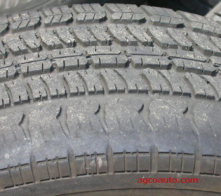

Found this: https://www.discounttiredirect.com/learn/wheel-alignment
…and added a few images that claim to be from too much negative camber.
To cause the amount of inner shoulder wear I had would need a huge amount of negative camber (like you sometimes see on lowriders with **** can exhausts) and I certainly don't have that. As I also said the fronts (also replaced) were showing signs of similar wear, though less advanced because they were replaced last year.
So my money's still on speed cushion damage, but it'll be interesting to see what they find when the tracking is checked...

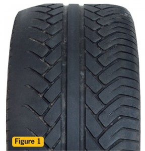

Google 'VAG saw-toothing', it's a common VAG issue, that some believe is related to their independent rear suspension set-up, the motoring forums are full of it.
Sometimes it results in droning, sometimes its silent. One car can suffer horrendously, another identical car doesn't. What is consistent though is excessive inner edge tyre wear on the rear...
https://www.oponeo.co.uk/tyre-article/saw-tooth-tyre-wear
Another potential consideration is the brand of tyre. I've only ever suffered from this once on my Superb, and the tyres were Pirelli's, the same as the OP's.
Here, only a few posts down from this one we have another complaint around potential concerns with the Pirelli P7
So the likely hood of saw-toothing could be heavily influenced by the tyre itself...

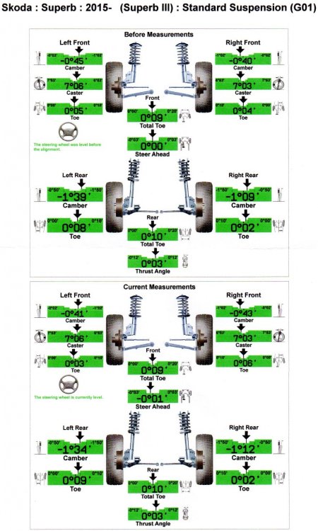

If the alignment is paid for by VW leasing and done at a dealership they might not be as forthcoming with the results, but hopefully they provide before and after figures. Not sure if you have a Sportline, but I have attached a Hunter print off for standard suspension… very interested in your results :thumbup:

Doesn't look like sawtooth wear to me (different wear on alternating blocks on inside edge). Just look at the top of the photo I posted where you can see the tyre profile, the inner edge has something like 5mm of rubber missing on the entire edge -- it looked and felt like somebody had taken a grinding wheel to it and removed the rubber at an angle. And most of the steel cords too, but you can see a flattening out when it hits the cords, presumably because they're tougher to wear away than rubber. It's not clear from the photo but the leftmost 3 big grooves were all about equal depths (shadow makes the leftmost one look deeper), the fourth one is shallower because it's already on the worn inner edge.
I think the issue here is that the blocks have completely gone so it isn't possible to see if there is alternating wear across the inner blocks. Sawtoothing does tend to result in a loud drone though, so if your tyre wear when unnoticed it could be something else.

It would be interesting to see the geometry before and after.
