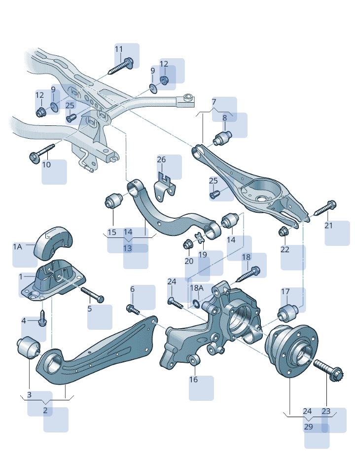

Does anyone know if the Superb Sportlines (280) have camber adjustments on the rears?
Items 9,10 and 11 below I believe
100% adjustable on the rear end mate. I’ve had mine set up for fasst road geometry runs just under 2 degrees neg camber on the ears and I can remember toe but certainly is adjustable. Yes I do get inside tyre wear but not too bad. That’s even fine when I’m carrying some weight. I think manufacturer tolerance is 1.3-1.6 something like that
