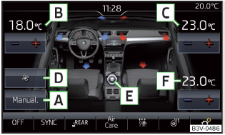

Look at the D :)
Page 117 of the manual shows how to do it.
strong is called intensive on the superb.
