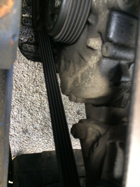

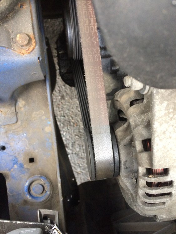

Any comments on condition of this drive belt?
It looks ok to me (on the bits I can see), but any comments on my two photos welcome
It looks fine, the fraying at the edges is normal.
Something a little odd? Wear pattern is uneven. Sitting well on alternator pulley. Two unused grooves on the other pulley. Might not be properly lined up. If so polly V grooves are shallow and only a little wear can reduce grip. I would change it. (On the assumption that you have a worry which has led you to examine the belt in the first place!)

Are you sure about that, where it leaves the lower point on that other pulley it looks like it is fitting it okay, so what appears as 2 ribs out is probably due to that belt not passing over the top point of that pulley where/when you think it is, but some point later on?
Ah, yes possibly parallax error from the viewing angle. Simple eyeball test for the OP. Also remove belt and run engine. Does it still whine?

Is there a tensioner and any idler pulleys in the belt run, doesn't look like it from your photos?  As someone suggested above, see if the noise goes if you run briefly without belt.
This looks like an idler or tensioner pulley to me? The belt is running over it on the non-ribbed side...

Is this a 1.4 mpi 8 valve?
If so there is definitely an idler pulley (and the retaining bolt has a left-hand thread!) They can whine like mad when the bearing is shot.
