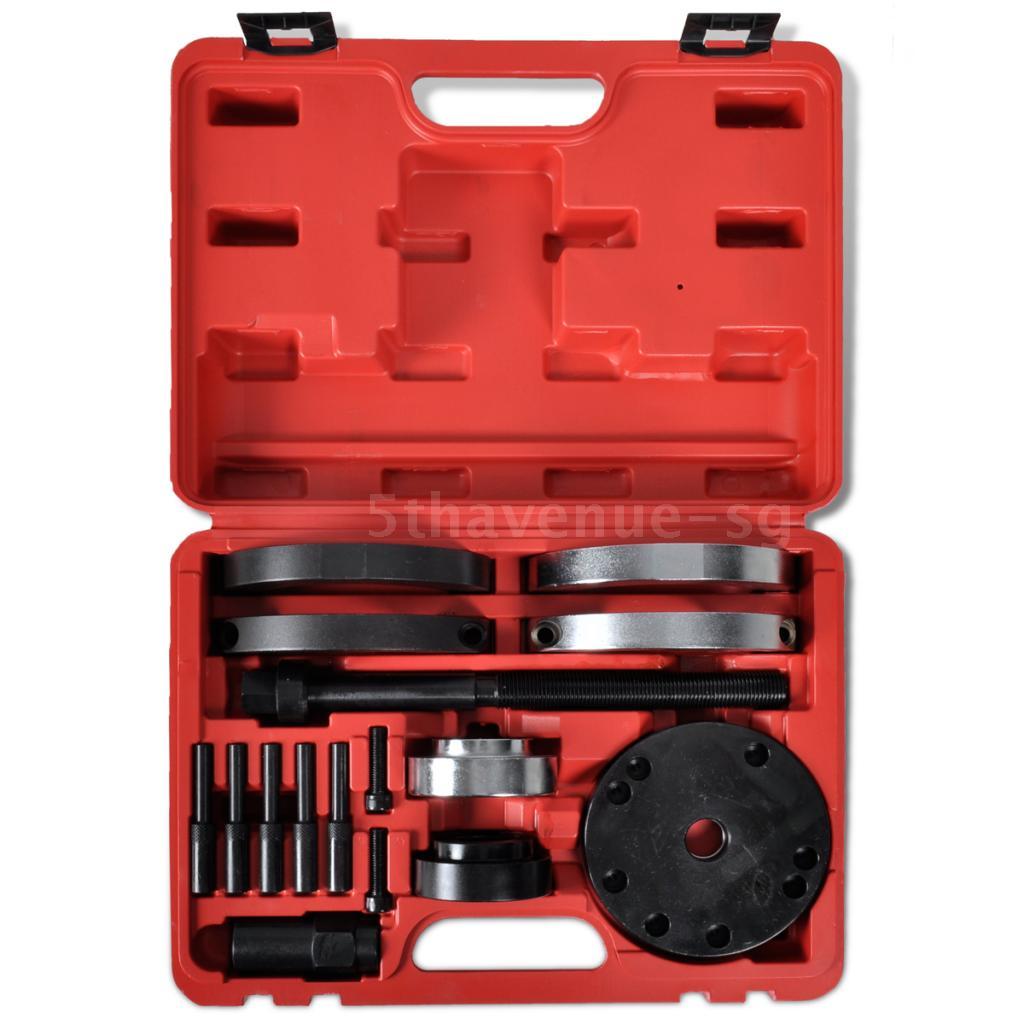

did  you use the vw puller tool ?
Unfortunately not! I didn't realise I needed one to be honest. I actually thought it had simply seized into the housing with corrosion. I cleaned up the housing with a quick sand and the new one fitted nicely you see with no force. If I end up doing the other front I'll use the right puller.
The other annoying thing was that the head of the final of the 4 retaining bolts actually rounded off when it was about 4mm out, meaning I had to hacksaw through it between the bearing flange and the hub, leaving a VERY tight and seized stud in the bearing.
Fun times! It's all a learning experience though, so I guess I've taken something away from it right???
Do you need one of these for the rear?
I think you need the correct tool to take out the bearing but also to correctly reinsert the new one but I am not an expert  I would assume you would need one for the rear as well I am sure someone who knows for certain will confirm or correct.

Consulted the Haynes, it seems I also need a "suitable puller" for the rear. Might check with my local garage tomorrow if I can borrow one. The owner is a WV group fan who doesn't mind lending tools!

Pullers are not needed for octavia wheel bearings as the bearings come mounted in the hub, they just bolt on as stated by jmattley, much easier than it was on the Mk4 platform.
The puller is just for removing the flanged bearing housing from the hub. They rust and sieze in to the bore on the hub. Nightmare!
But yes, they the bearing housings are the races and should never open. Unless you need to hammer it off...
