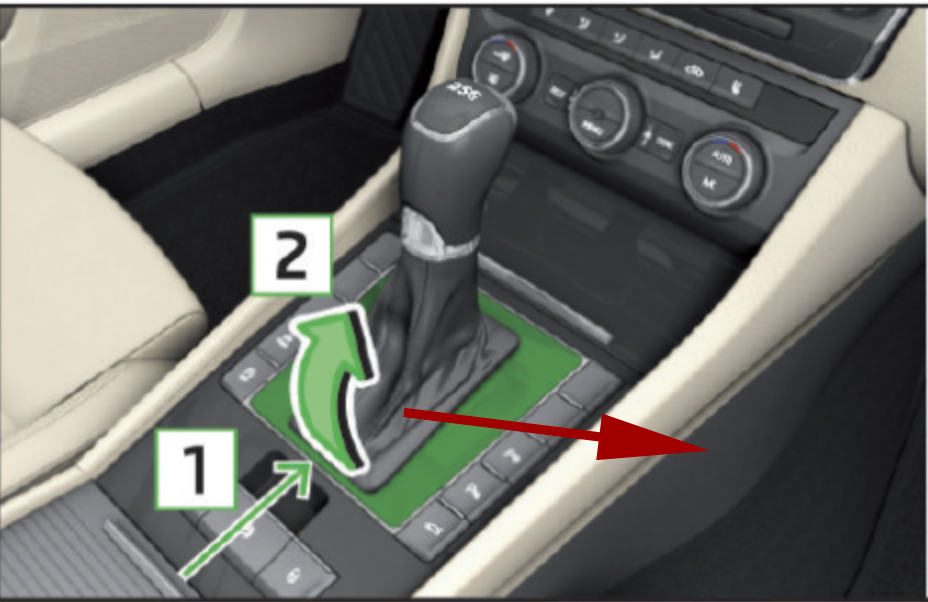

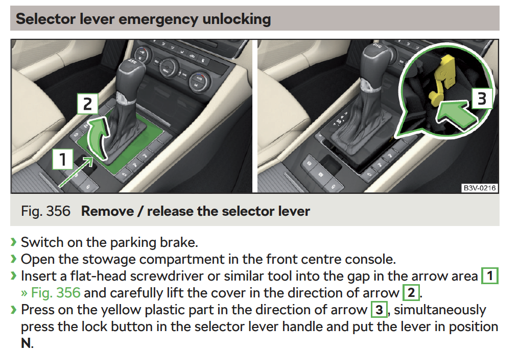

Not sure how much access this will give you but might be worth a try,

@swissbarry, thanks to @MaddicIrl, I can clarify what panel I meant (red arrow points to the panel).
It should be be rather easy panel to remove and I am rather sure that you should see the card from there (probably must remove both sides).

First try to remove the lower side panels of the center console as I posted in my previous post. That way you can get behind the phone box.

If I remember correctly, then you needed to pull the front part to your direction and push down (to the direction of floor), the rear part. First you have to remove the plastic screw cover and unscrew one torx. It is located in the front middle of the panel.
Okey i did what @alf.onso suggested and it worked. It was a 15 minute job, the panel removal is very easy.
